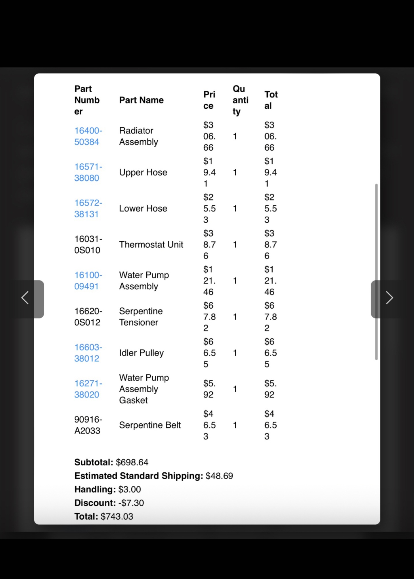

Alright, I’m due to replace the radiator. Along with the water pump, what else should be addressed?
Couldn’t turn up the correct post for parts, if anyone has it please share.
Thanks!
Serp belt and related idlers and tensioners at least

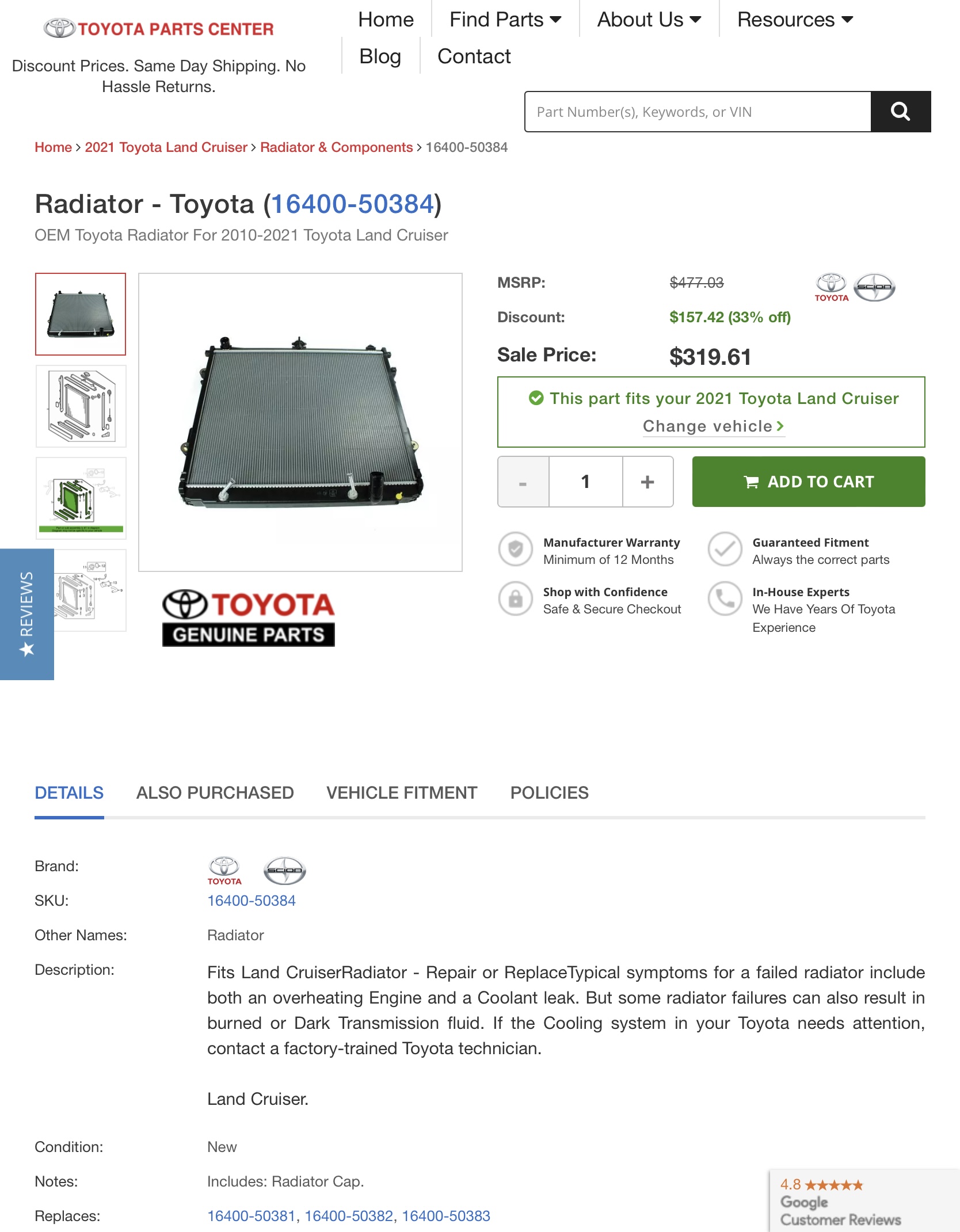

I'd also like to confirm the new updated Toyota radiator P/N.. It seems like some of the toyota parts websites are showing it as an unavailable part.?
I need to get one to have on standby

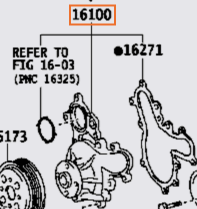

Didn't the water pump come with a gasket? I see that p/n showing the gasket with the pump.
I think it does come with a gasket but I can’t remember for certain.
Main water pump and thermostat outlet gasket should be in the kit.
