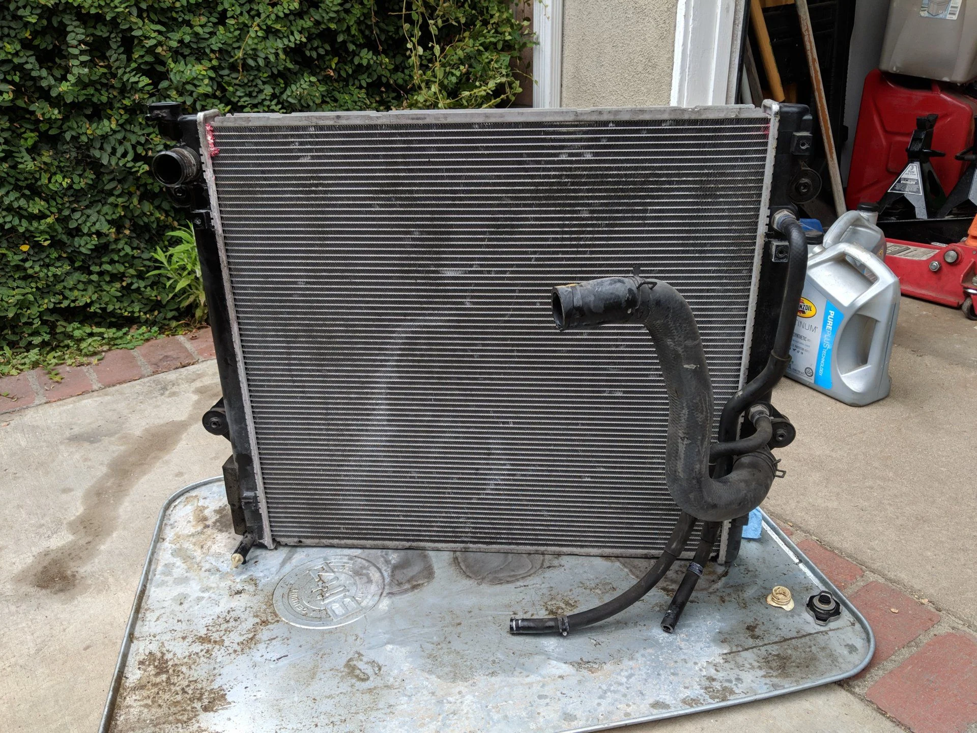

This is what the radiator looks like when removing with the transmission lines and lower hose attached to the radiator still. Was pretty easy to do.
