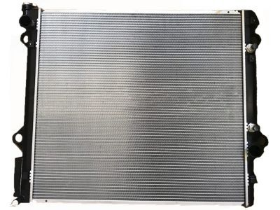

Now I'm super confused. Many but not all aftermarket radiators for the GX470 and T4R both have the sane part number and look like the OEM GX470 radiator. But the OEM T4R radiator picture is different than the GX radiator.
I use 'mylparts.com' - appears to just be a dealer, but has good parts diagrams and has treated me well as far as shipping.
Sometimes the pictures are bad or not actual part.
If the oem part numbers are the same, then it should be the same part.
However, I have no inside info as to whether a 4R radiator fits or not. I usually just go by part numbers
