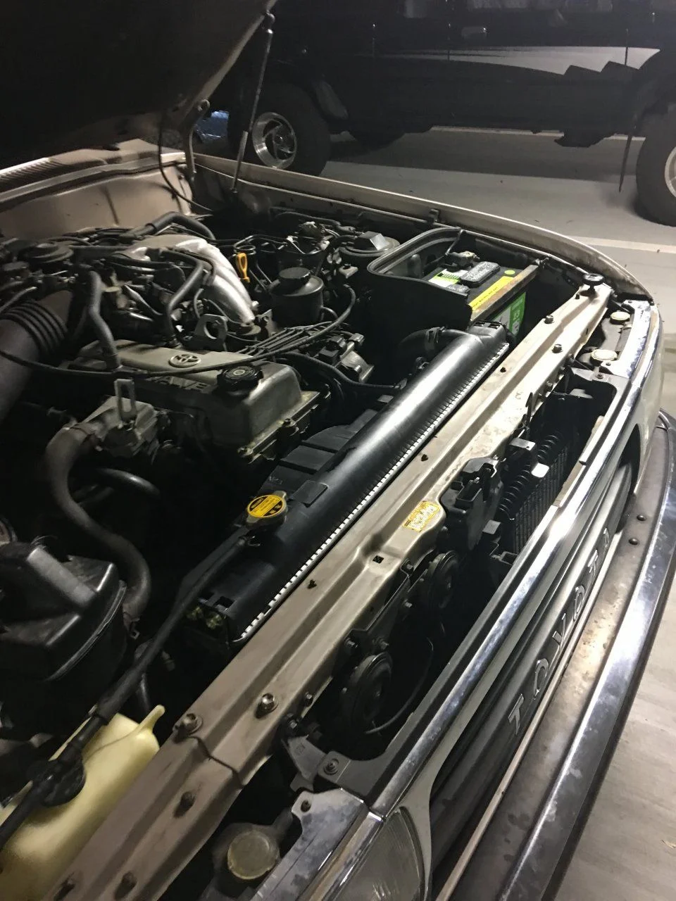

I went with the Koyo Radiator for a 95-97 model. Installed fine, the upper brackets had a slight bend to them so it didn't fit exactly like OEM but I was able to make it fit without to much work. Had to replace my battery too, not sure if it was dyeing or what but after being out of the truck for 24 hours it drained and even after a jump start and running for a good 30 minutes was completely dead so I put a new Interstate from Costco in it and she's running like a champ. Thanks @Pippylongsausage for the pdf of the FSM and for all those who provided input!
