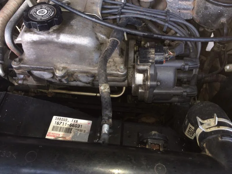

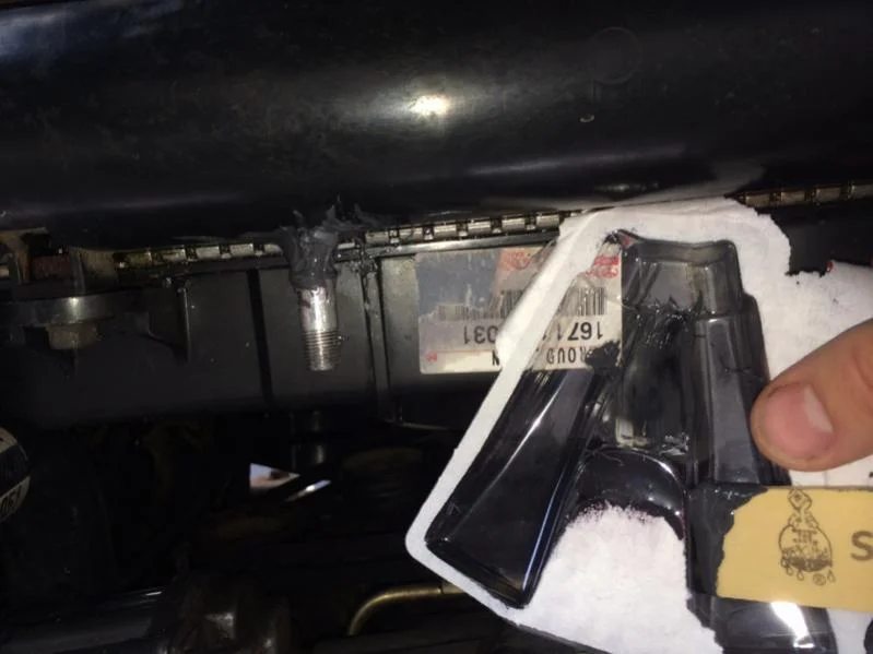

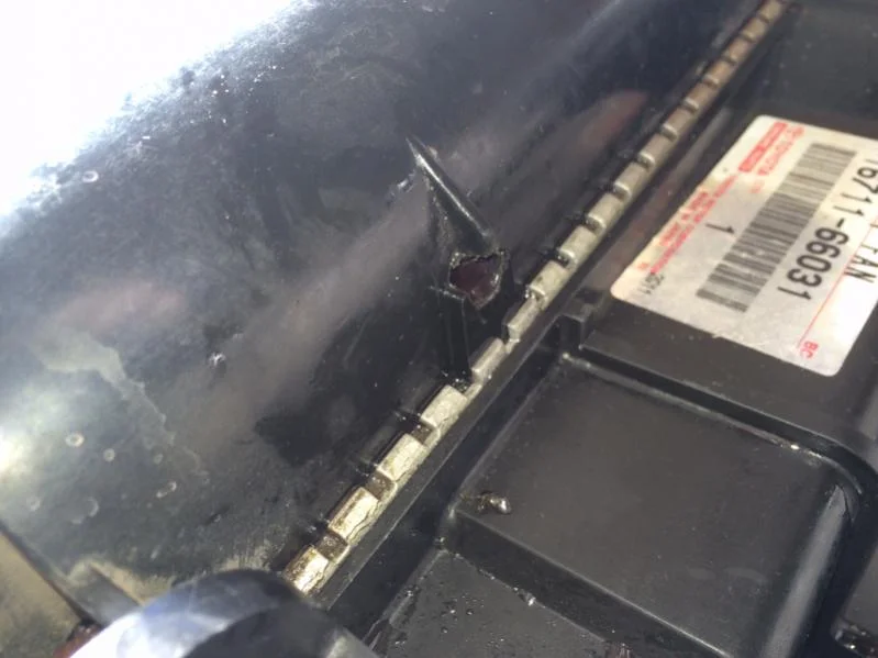

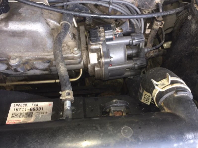

After swapping coolant, fan clutch oil, installing new thermostat and hoses...I was replacing the fan shroud that broke a week prior and all was complete. While installing it, I broke the plastic radiator nipple.
I will probably end up buying a new radiator before I go on a long distance trip in the rig next summer.

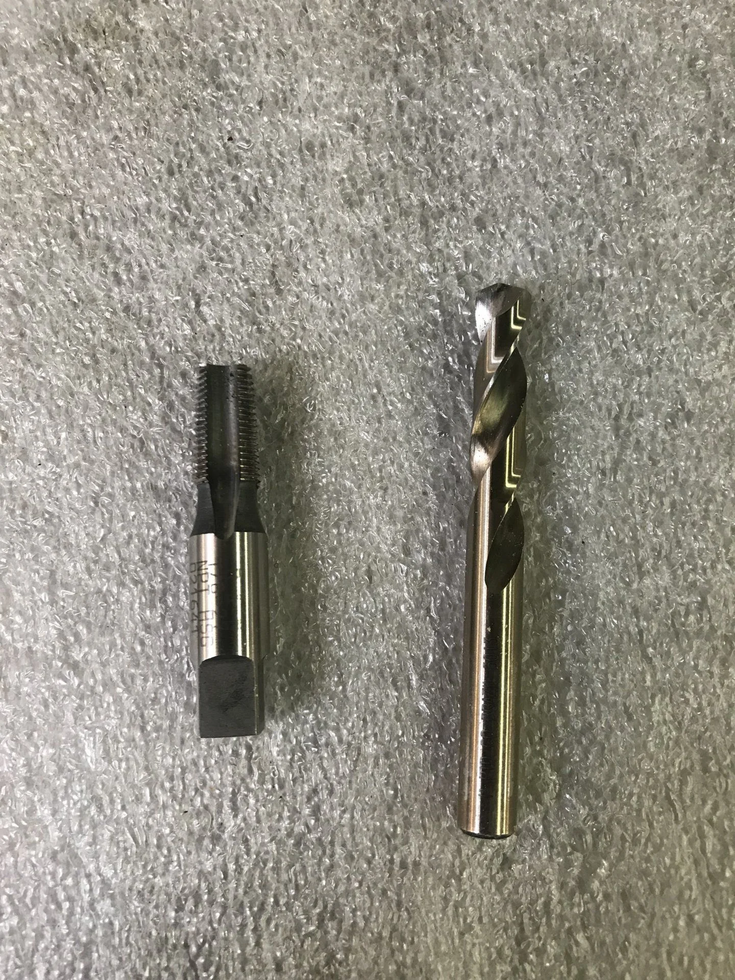

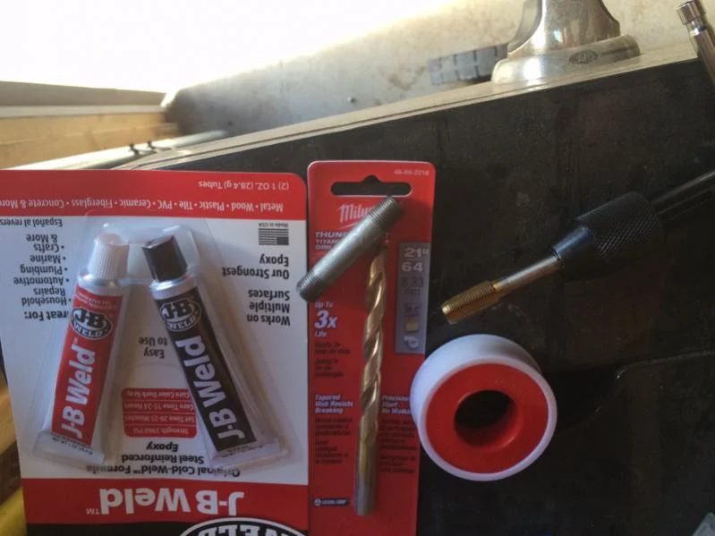

You will need:
21/64 Drill Bit
1/8 NPT 27 tap
1/8 x 2 Threaded Pipe
JB Weld
Plumbers Tape
Vise grips/channel locks
Some sort of Cleaner
Distiller Water / Coolant

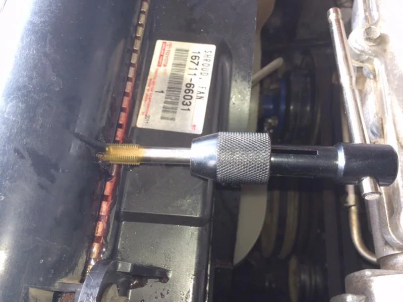

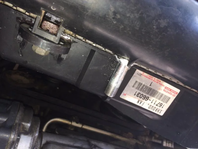

1). Drill into the radiator slowly using the 21/64" bit and remove plastic as it feeds out. Don't go in to far...I could feel when I reached a different material while drilling. You don't need to apply much pressure, let the drill bit slowly crawl in.
2). SLOWLY start the tap, turning it into the plastic. I would turn in 1-2 revolutions and back it out. This allowed me to remove plastic scraps along the way and reinforce the threads I had just created. I threaded in to about 3/4 of an inch and cleaned up the area.

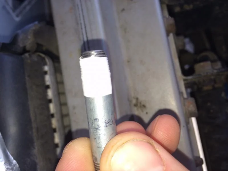

3). Wrap plumbers tap around one end of your threaded pipe. Remember to wrap in the direction that you will be screwing the pipe in. Also, recommended to not tape the first one to two threads. (This allows you to make sure your threads line up properly...remember this is metal on plastic, so it would be quite easy to cross thread it).

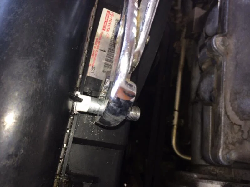

4). Start threading the pipe by hand, once you can no longer turn it by hand, grab your channel locks or vise grips and SLOWLY turn in the pipe.
5.). Clean the area well, removing any tape, plastic and coolant from the area.

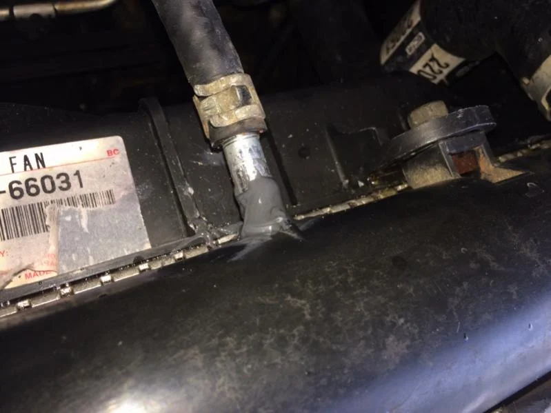

6). Mix up the JB Weld and apply.
7). Seal around the entire pipe/opening.

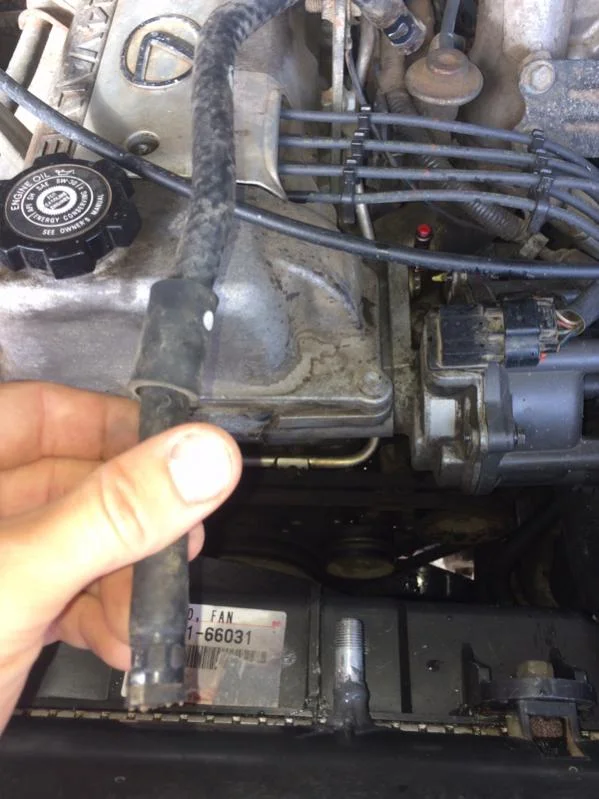

8.) I removed the hose from the engine and "screwed" it onto the other end of the pipe and re-applied the clamp. You will lose some coolant from this. I am sure you could force it over the threads, but I didn't want to apply any unnecessary pressure on the area....it threaded on smoothly.
9). Hook up the tubing and clamps or replace the hose if needed.
10). Top off coolant with distilled water / coolant that was lost along the way.
11). Update life insurance and invite your wife to drink the kool-aid. Or you could just clean it up.
12). Marvel at the money you saved.
Hope this helps someone...normally I am always asking everyone else for their help, hopefully this will help return the favor.

This was a 20 min fix and I feel better with this setup then just clamping off the ends.

I agree, I never even knew I broke the piece until I had the hose in my hand and was looking for the nipple.
With my current setup, it would take a considerable amount of force to break it.

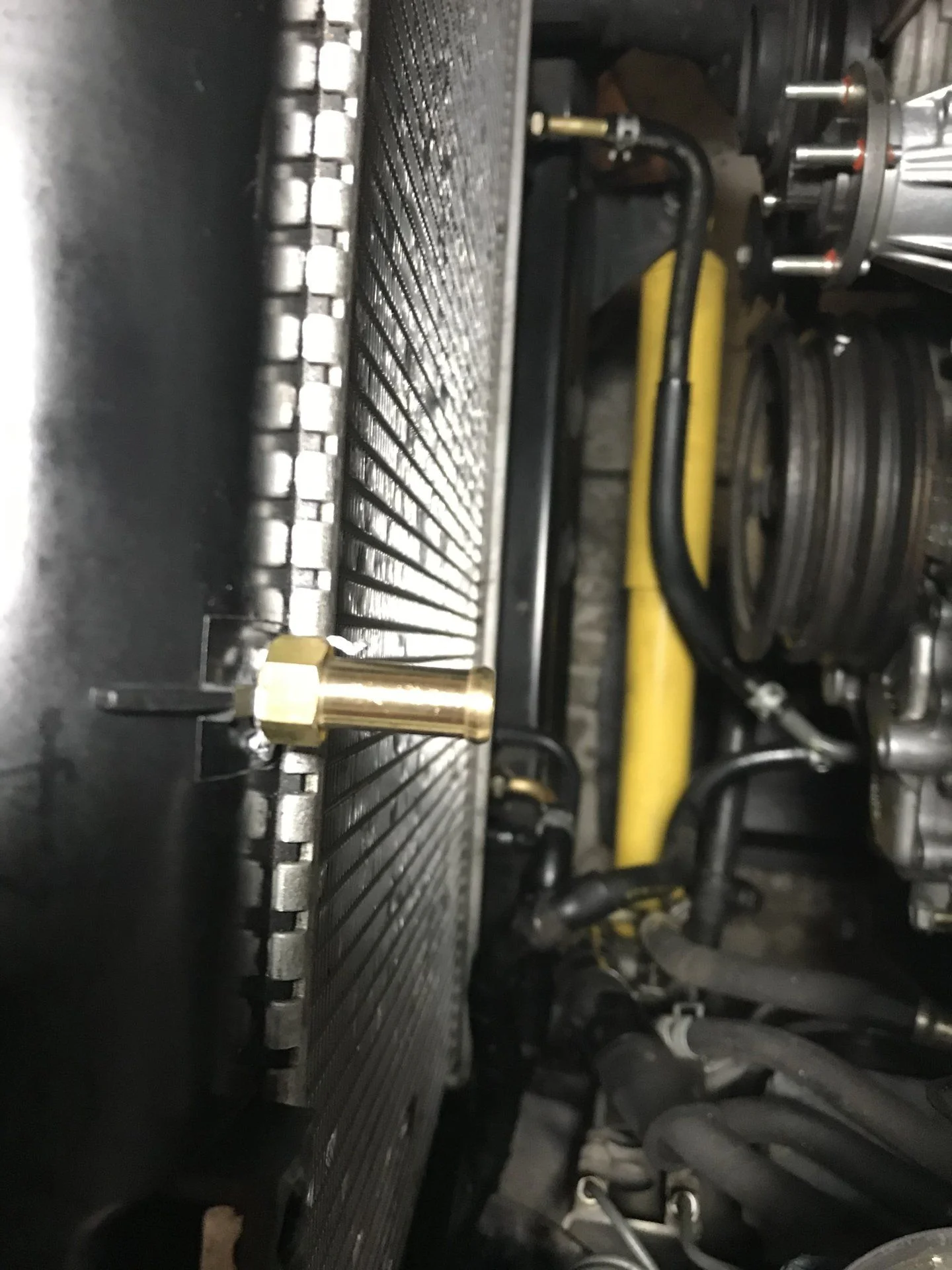

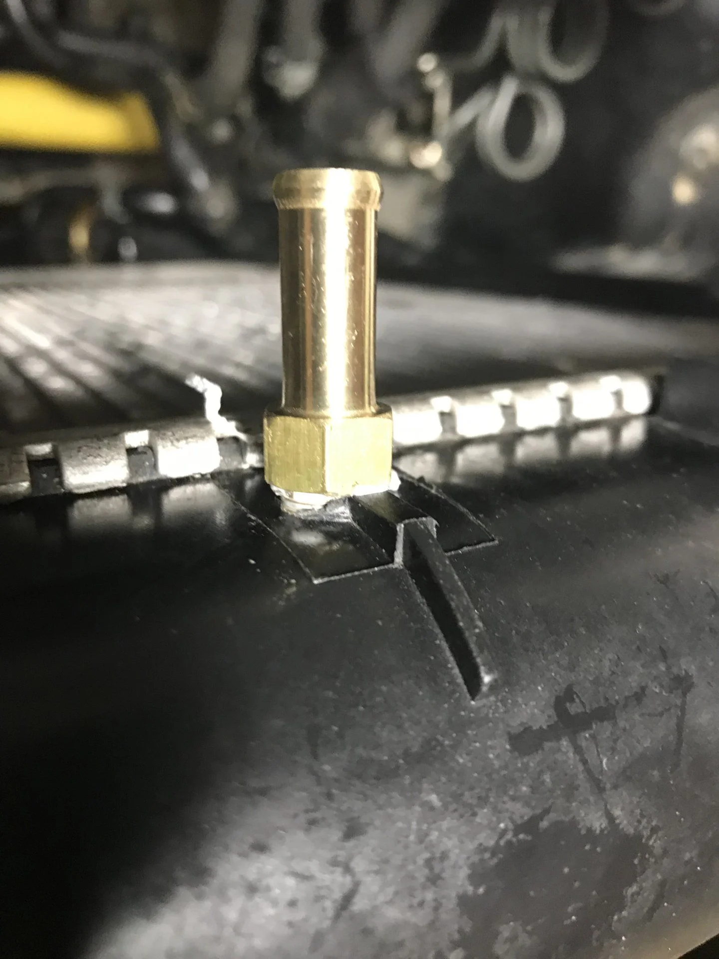

Thanks 084runnerltd, I broke mine too and was expecting I needed a new radiator until I saw this post, I went ahead and performed the fix per your instructions, looks to be pretty strong and will get me by until I change the radiator. Thanks again!
It's a bad design, it should be located outta the way.
Shame on Mr T.

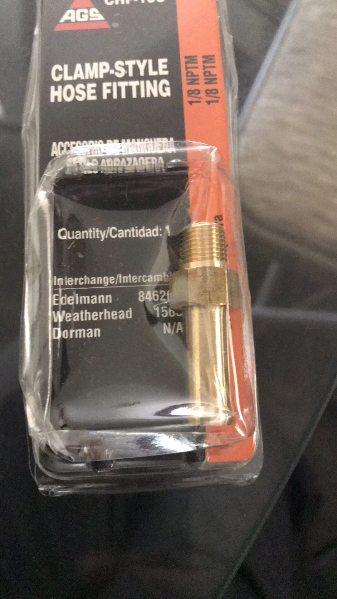

I of course fixed mine too, used an NPT Tap and Brass nipple. Should be good for life.
Not even worried about it, but when it happened I bet my neighbors heard me.
Thanks for the write up. I got the shorter 1.5 inch pipe, I sanded and cleaned the pipe and radiator. Instead of pipe thread I coated them with JB weld. Just screwing the pipe in it felt a lot more solid them the original nipple. Then I built it up with jb weld and when it cured that seems 100 times more solid then the original design. I would see no reason to replace this with a new radiator that I would consider more fragile. Very happy with this fix, my local hardware had the parts (Home depot did not). $13 and fixed better then new.

Thank you so much your posting. I just finish mine but I prefer no JB glue and I bought a brass 1/8 27 nipple! Hopefully it will work fine!
Good idea for the fix.
Just a tiny issue, but the JB weld won't bond with the PTFE thread tape - trimming the exposed tape off the pipe will give a better surface for the JB to adhere to.
