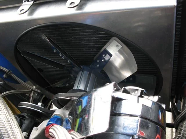

did you buy that shroud or make it?
Its very nice!
BTW...thanks for the pics.
Keep em coming!
the support clamps the radiator on the sides then there is a support that comes down similar to the OEM radiator support. There are rubber isolators wherever there would be metal to metal contact.

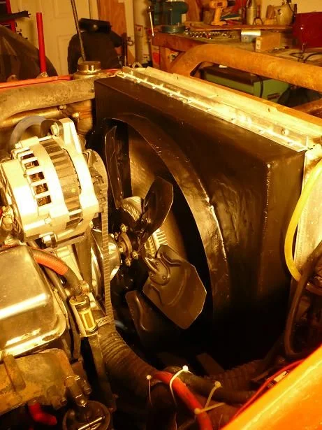

My stock rad support was a U shape and my 19x26 rad wouldn't fit in the U so I secured it from the bottom and sides. As far as the shroud if I did it again I would use the stretchy fabric approach instead of a mold.

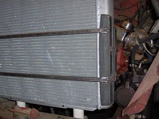

So here's what I came up with thus far...
cap at the top and the bottom...then vertical supports bolted at the top and the bottom to essentially CLAMP the rad. in place.
Ill be applying some bed line stuff INSIDE of the caps to protect the the rad from the steel. I have 1/2 in thick rubber pads, but the liner is for extra measure.
Better understand if you see it...
After I scrapped the first design and figured out what I wanted to do...things went together pretty smooth. This only took a few hours to get to where Im at now.
Pleased with it so far.
