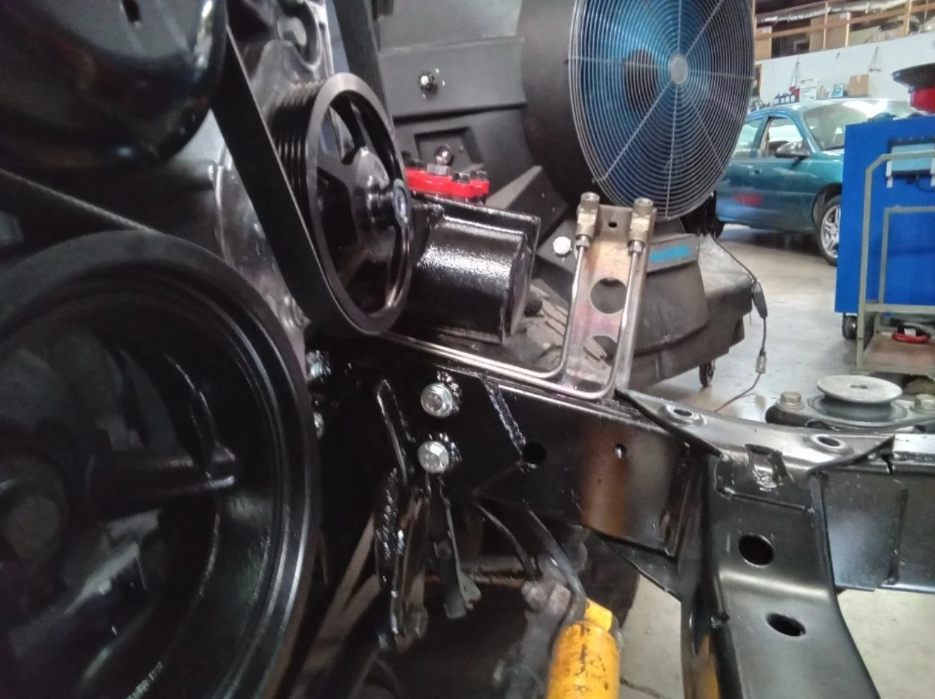

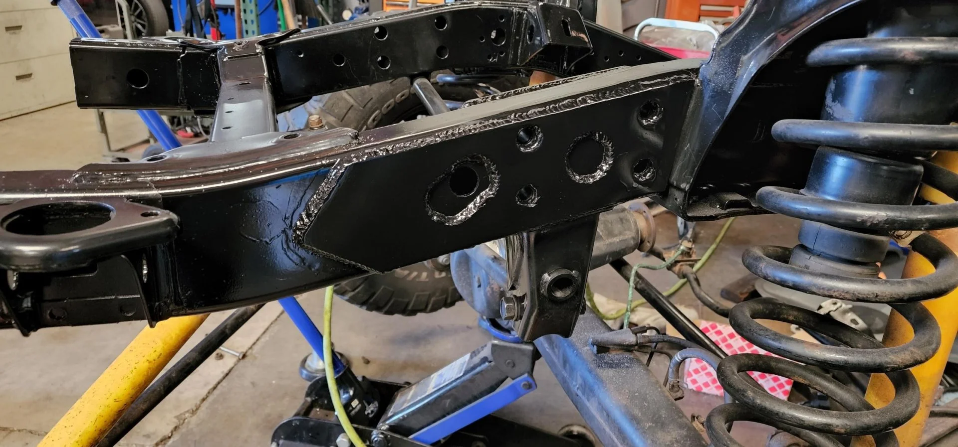

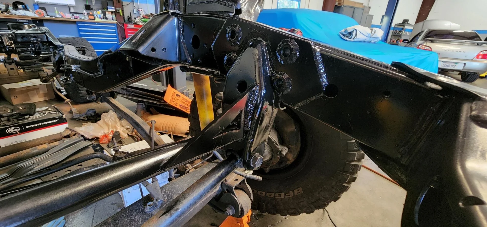

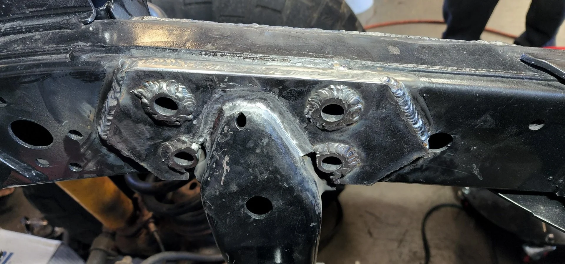

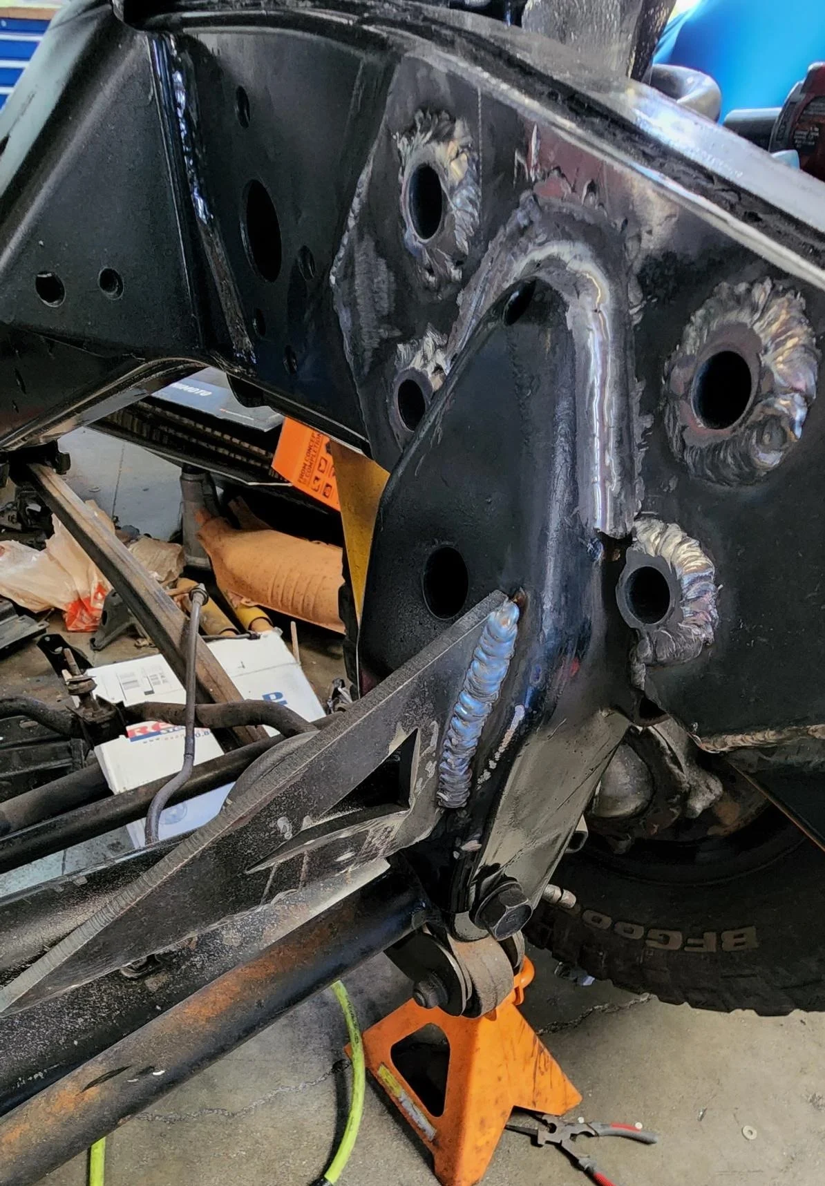

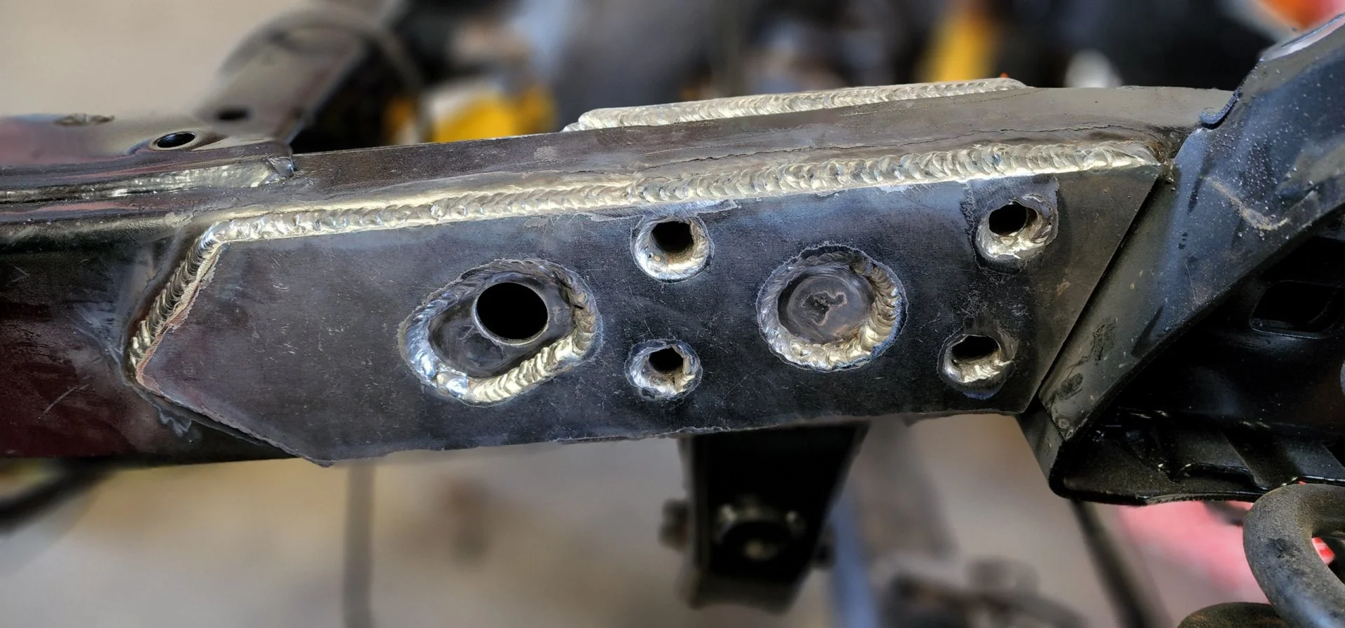

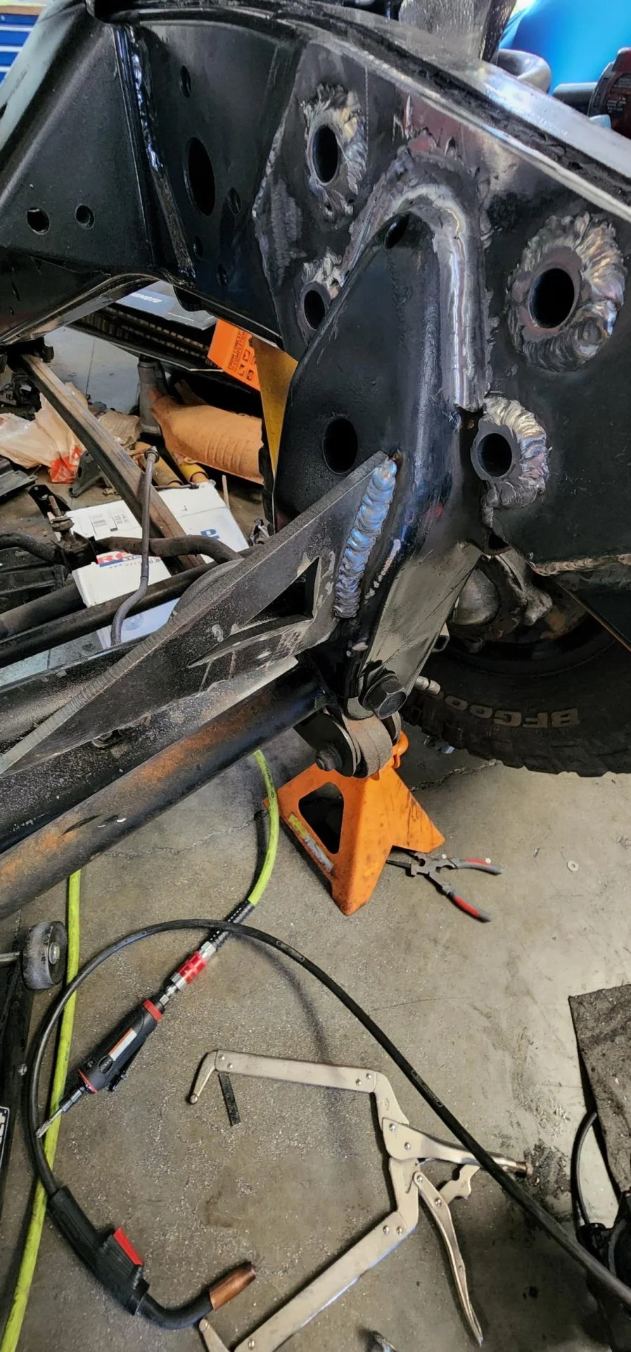

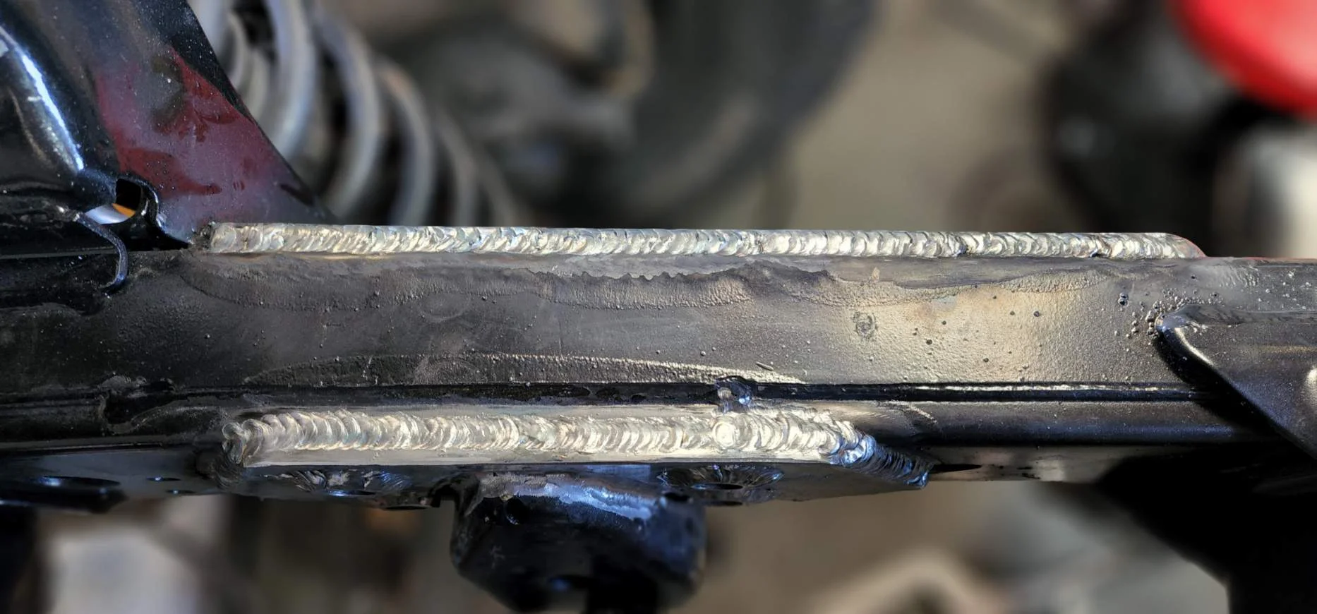

So I finally got back around to working on the FJ. I took the advice here and ordered up some frame stiffening plates for the steering box area from Australia from Rampt Customs. I got the outer one welded on. That one went on pretty smooth, other than it being a PITA to weld around the holes for the bolt shafts. I've only ever welded straight pieces, and then only in an easily accessible position (and even then I don't weld often). Filling in the gaps around the bolt shafts while constantly changing the gun angle (same with the two center holes) and contorting myself between the tire and frame to overhead weld the bottom was definitely a learning experience. I'm going to have to drill and tap a hole towards the front of the frame as the plate covered the mounting screw for the brake line bracket.
Then I moved on to the inside plate. That one required quite a bit of trimming. The holes on the plate for the bolt shafts were interfering with the stock welds around the shafts. I had to trim all of the holes, as well as take about 3/8" off the top of the plate as it was too tall and stuck out above the frame. Some of the gaps around the bolt shafts were pretty big and it was a bugger to fill them in. The welds I made filling in the gap around the panhard bar bracket were doodoo, so I just beveled those out.
Next was the bracket for the cross bar, that went pretty well
There is a 4th plate that goes on the panhard bar mount. However, I didn't like the way it was fitting. I'll modify it and weld it on later as that is accessible with the body and stuff on.

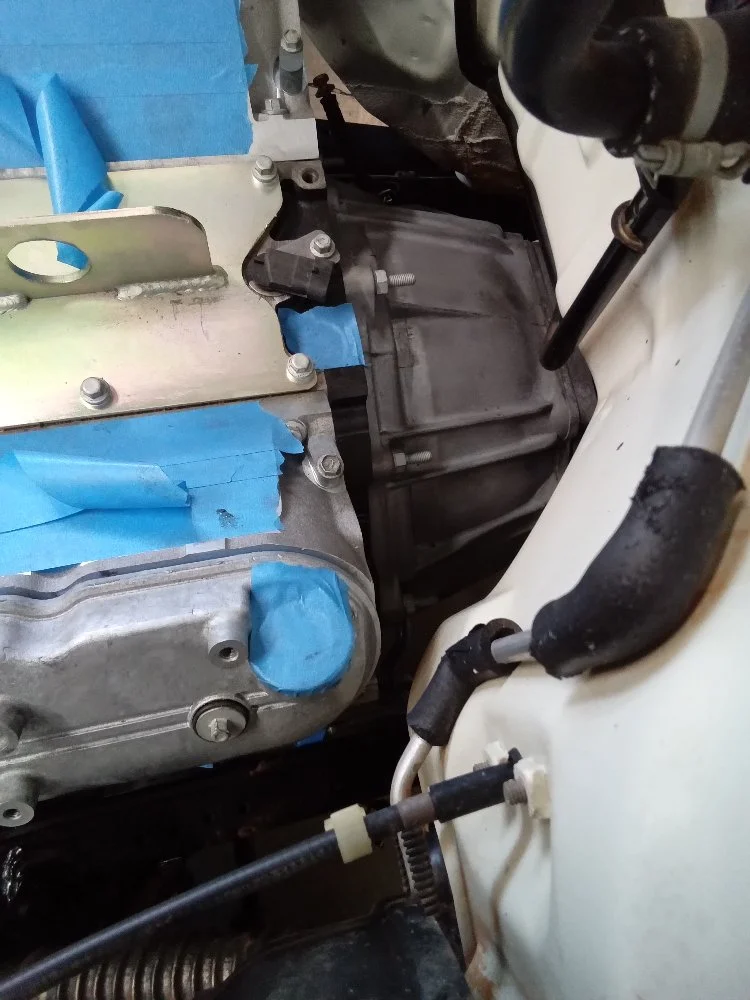

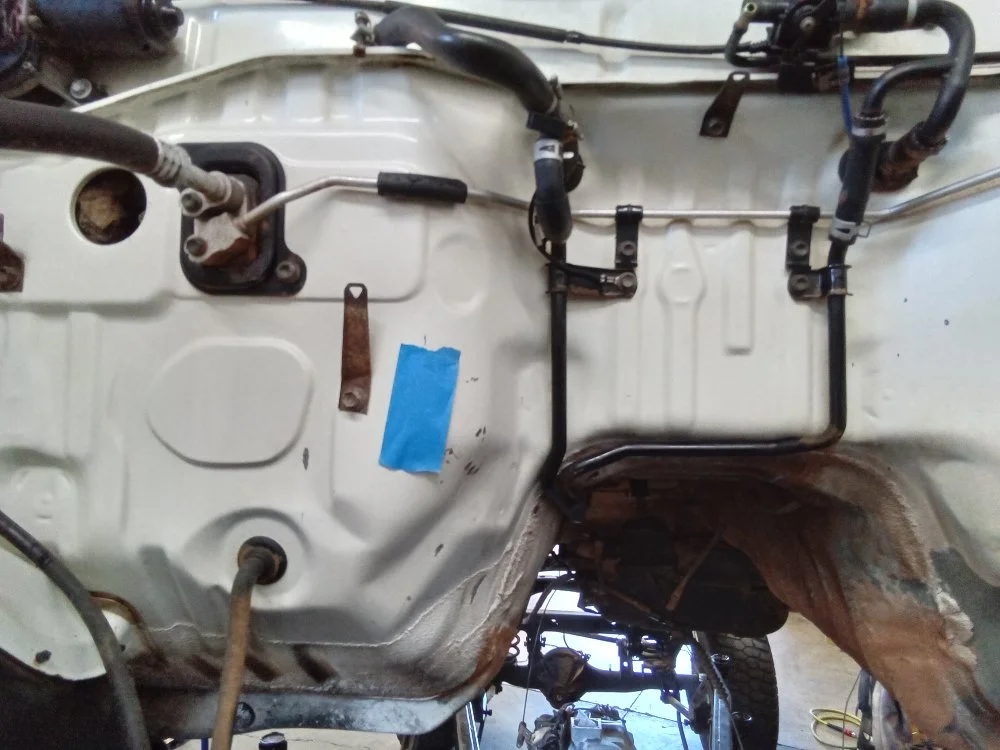

Next was to check the clearance for the engine against the firewall. The marks4wd instructions mentioned you'd need to massage the firewall, and they were right. I moved the frame around until it lined up with the body, and lowered and raised the body more times than I could count to check, adjust, and recheck clearances. The left side of the engine had no issues.

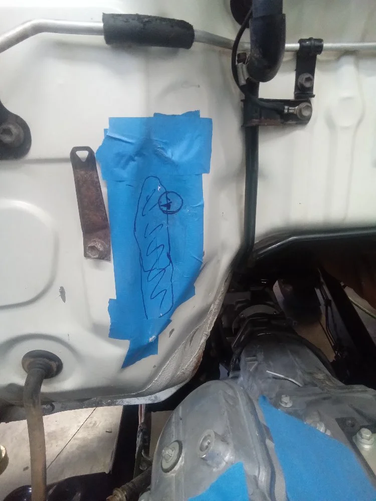

However, the right side was definitely going to hit. The area with the tape is the section of the firewall that needs modification. This is pre pounding.

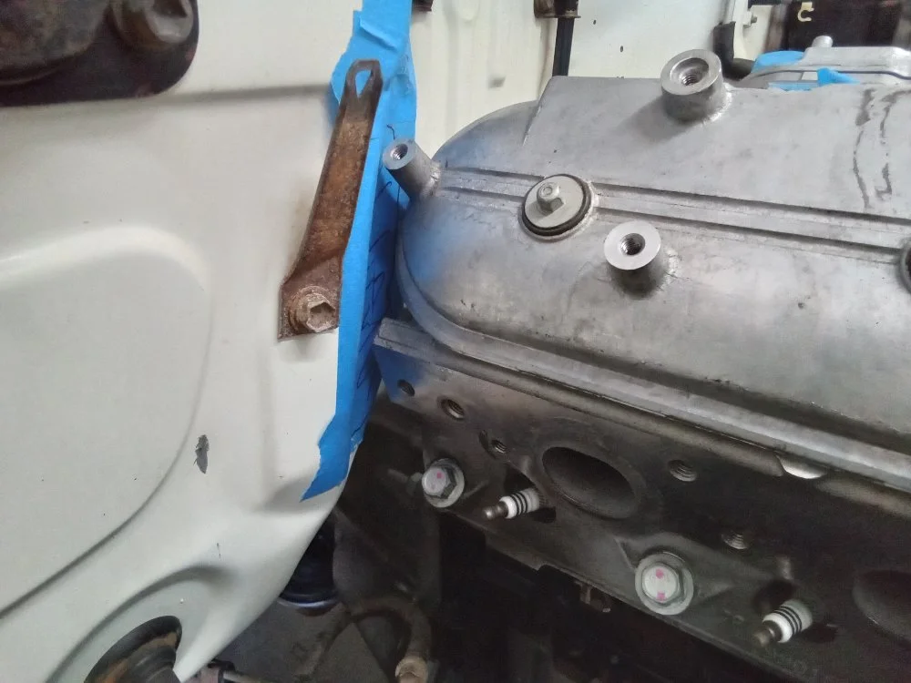

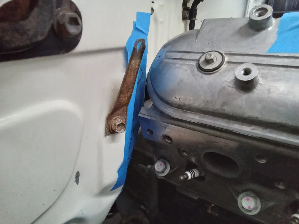

I covered the whole area with tape to protect the paint, then took a 2x4 and a sledge hammer and began reshaping. This pic was during one of my checks. I could still not lower the body all the way down without hitting. Still not enough room, and I found the bolt boss at the end of the valve cover was going to be an issue, as I would have to bang on the firewall near a crease to make clearance, which was going to come out ugly. I decided to shave that boss off of the valve cover. It just holds the coil pack bracket. There are 3 other bolts left to hold the bracket on. It won't be a problem.
Some more pounding and checking, and this is the final shape of the firewall. I concentrated on the vertical shaded area, then had to give it some extra pounding along the circle area to the top right to get good clearance on the valve cover.

And here's the final clearance with the body all the way on. You can see the shaved bolt boss on the valve cover.

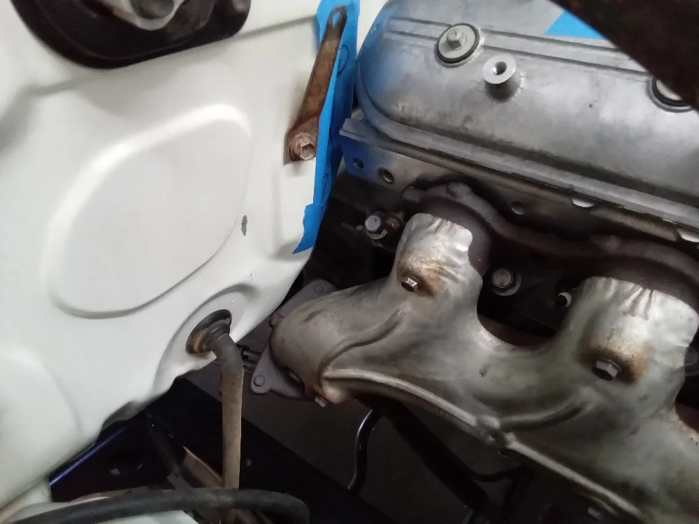

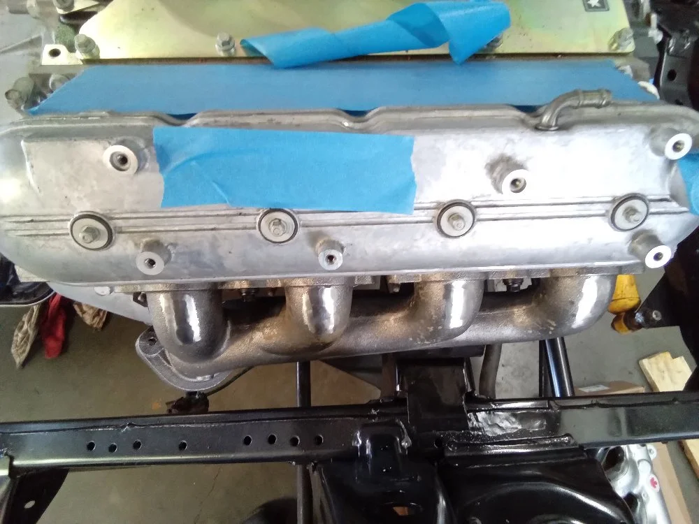

Next I started checking the exhaust manifold clearances. The left manifold points right at the top of the frame. I found this out earlier when I test fit it with the body off. My initial plan was to cut off and reweld the outlet flange so it goes over the frame rail like the stock exhaust did. During the test fit, the right side manifold looked like it would be fine. However, when I test fit it with the body in place, the outlet flange hit the firewall. The exhaust bolt was in on the last bolt hole near the firewall, but the front part of the manifold could not come down to match the front bolt hole on the head because that flange was hitting the firewall.
I shaved that flange down to gain extra clearance, but no dice. It was not enough room for the the front of the manifold to line up. I was left with either pounding out the firewall or cutting and rewelding the flange. This was going to be a lot of work rewelding both manifolds, so I just ordered some G8 manifolds from the dealer. Hopefully I'll get those this week and can test fit to see which route I want to go.

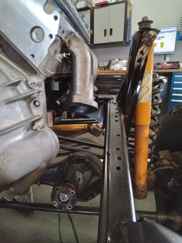

So I got the Summit Racing manifolds in today. Test fit them and it looks like these are ticket (part number G9080). Here's the clearance on the passenger side. It clears the frame and the firewall with plenty of room.

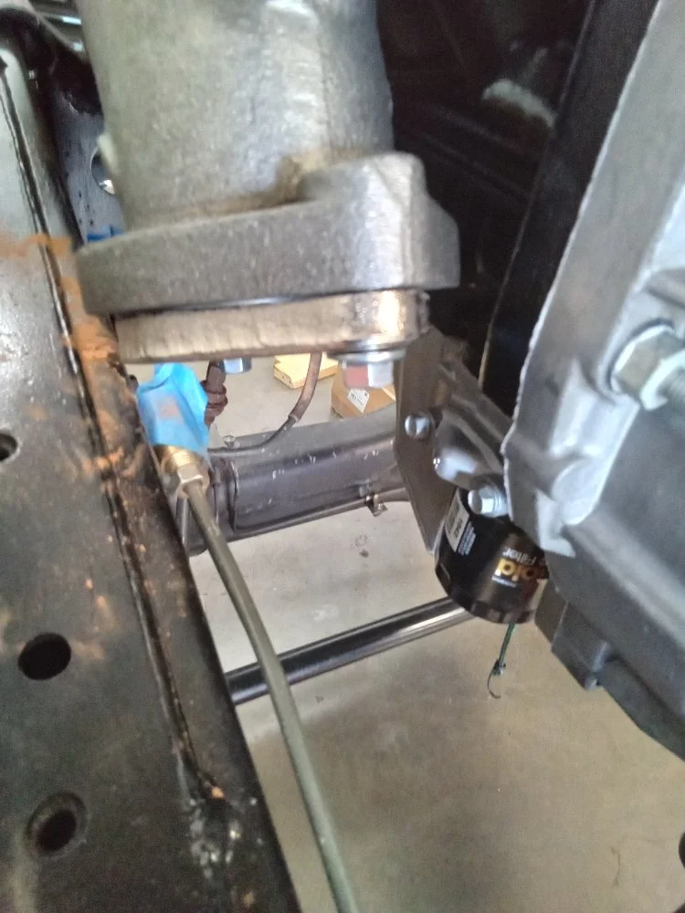

The left side is a close fit, but it's going to work. I'll need to bring the exhasut pipe off of the flange at a bit of an inward angle for best clearance. The thing I'm not liking is how close it is to the brake lines, especially the coupler for one of the new brake lines I made. I'm going to reroute one brake line a bit lower then up into the splitter for the front left brake, and the other I'll run up and on top of the frame. Looks like I'll have to scrap one of the new brake lines I made and make another.

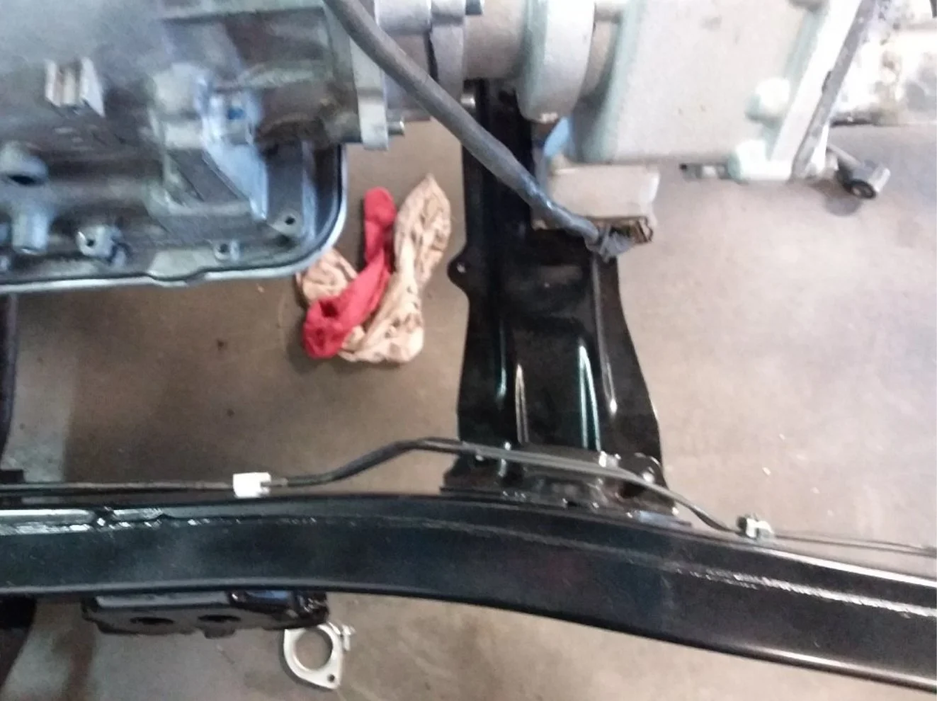

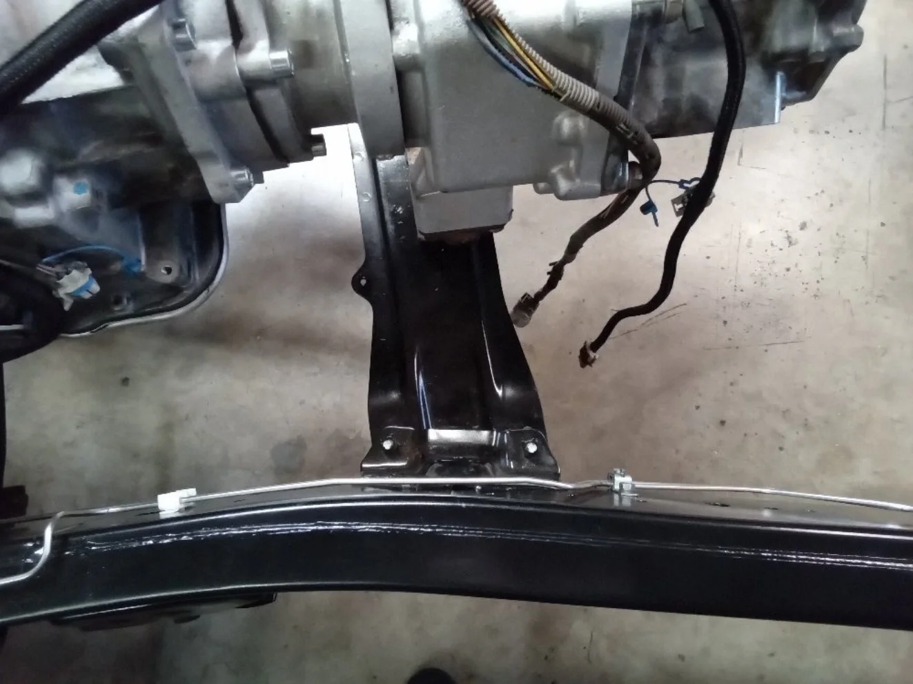

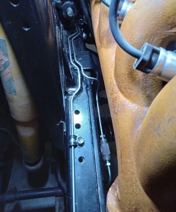

Well, I got some more work done since last update. I took care of the brake line routing to get more clearance from the exhaust manifold. The lines running along the frame had a bend around a weldment that were pretty extreme. Being as how I'm going to run the exhaust between the drivetrain and frame, I wanted to get more clearance there too.

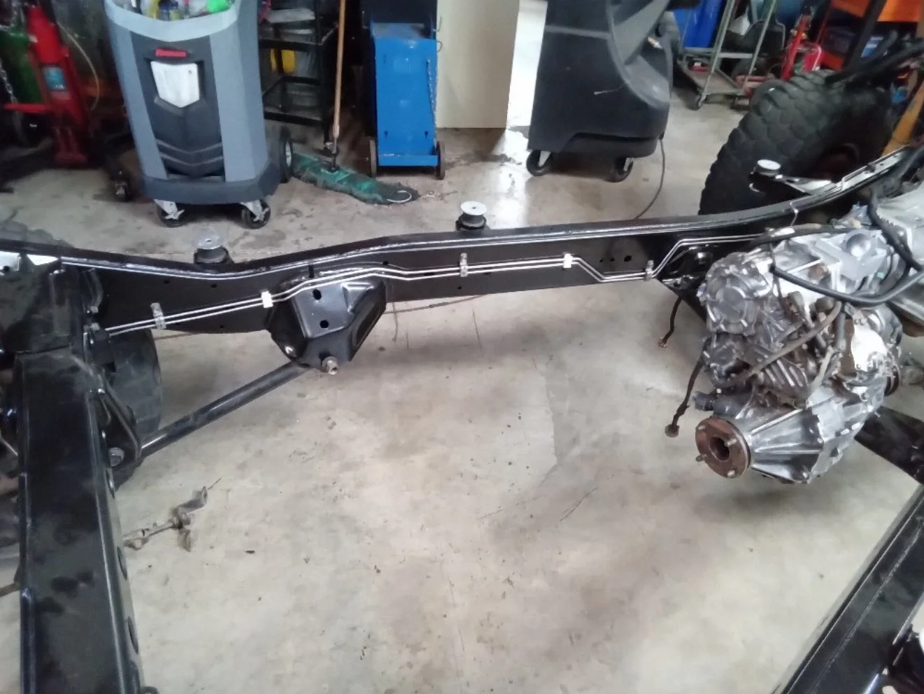

So I decided to just make new frame lines, and get rid of the union I installed originally. Less points of failure and all that. I figured why not make them out of stainless steel. They should last the life of the car and we'll never have to worry about them again.
You can see they're hugging the frame a lot closer now.
