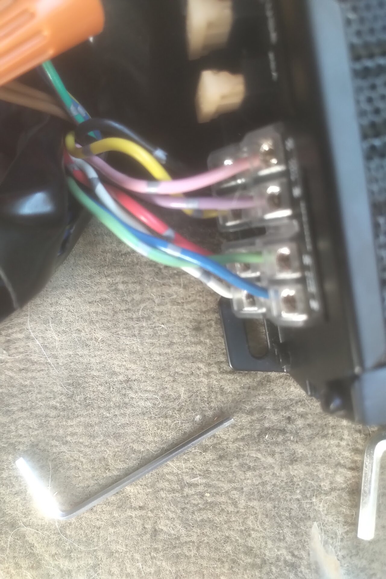

Here is a picture of the 2002 LX speaker wires off the wire harness (almost forgot I took it) I can't remember if it was the nav ECU or ML amp. Certainly very possible that the wire colors changed between years.
All + then -
Front L, Front R
Rear L, Rear R
Almost sure that's the order I used from left to right, top to bottom. Of course you can verify at the doors if you change out your speakers.
