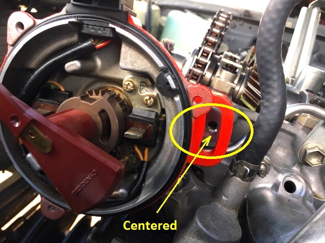

Centre of rotor button should point at centre of plug lead #1 with the distributor housing bolt door centred.

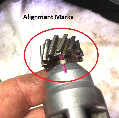

Try shifting the dizzy gear one tooth clockwise as you install it.
It'll either fix the problem or it won't. There nothing to lose here.
It took me a few goes to be satisfied I had it right on mine.

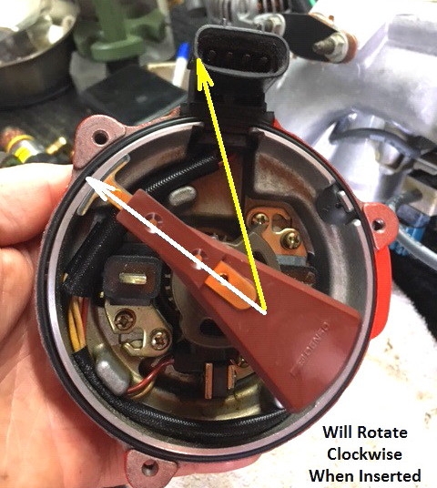

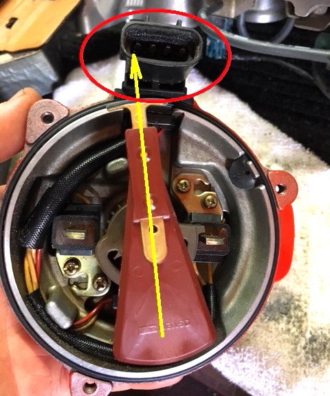

Yeah, don’t bother with that. Set crank to TDC. Pull the distributor cap and make sure it’s set at #1 TDC, rotor position (pointed at Cyl #1 on the cap AND at TDC). rotor rotates (counter clockwise? can’t remember) as it comes out. Turn the rotor just a bit (counter clockwise?) I think the gears turn the rotor clockwise when you insert it, and try it again.
<edit> looking at the very helpful photos from that other post, it looks like you still need to be just a tick counterclockwise. Again, you can put the cap on to visually check if you’re right at #1 TDC. You’re really close.

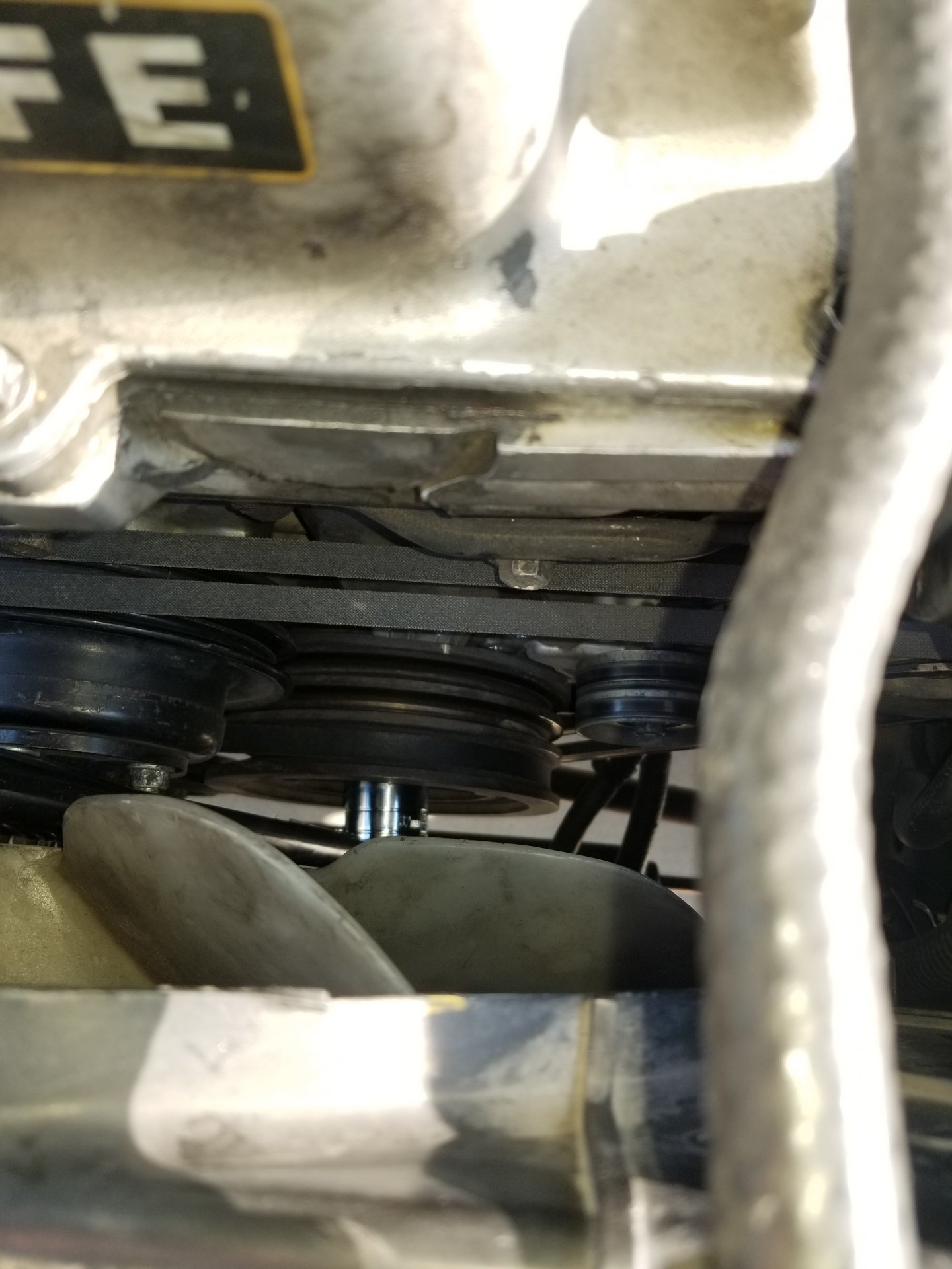

Ok. So with an extension in the spark plugs hole I rotated to 0TDC. The extension was at the top of it's movement but the diz rotor was facing toward the 4-5 o'clock position.
The other times I would keep rotating and when it came back to 0TDC and top of it's movement it would be pointing at the #1 wire on the diz cap. This is where I would pull the diz and try to make adjustments.

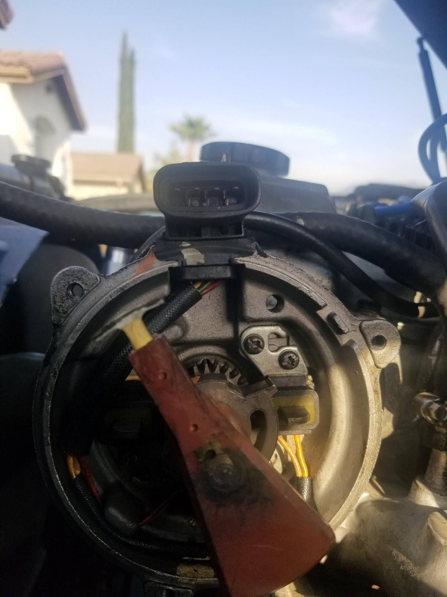

This time I pulled it from the first position I described. When I lined up the diz marks and inserted it looked like this...
Wich looks like what you guys have been telling me it should look like. I button it up but it won't start.
