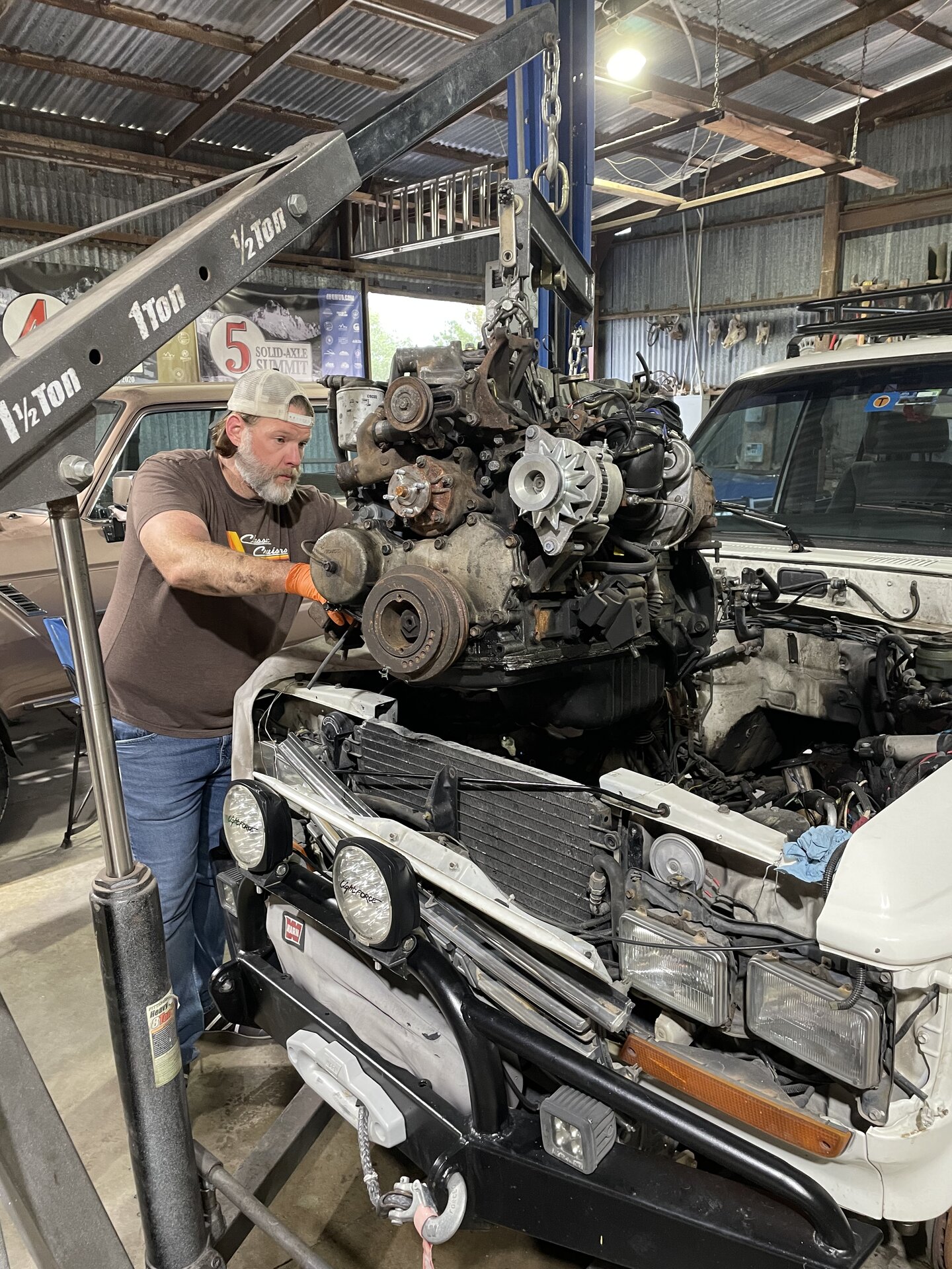

Curious if there’s any feedback on this gasket kit. I’m building up a long block that someone else put together with this kit. I have a complete Toyota gasket kit but really don’t want to break it down unless there’s good reason to. Thanks. Jimmy.
