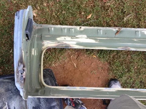

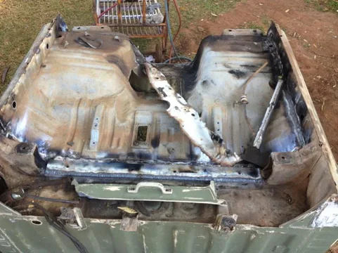

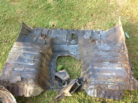

We took this out
And replaced it with this
Had to braze a few cracks & rusted bits
One or 5 mounting holes needed closing a little & grinding, clearly this cruiser had done plenty hunting through washboard roads, have asked where but had no response

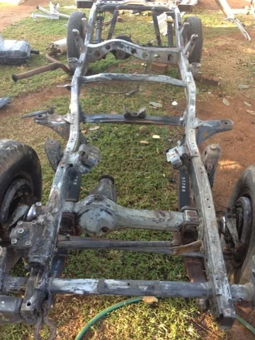

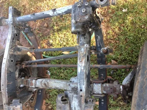

Looks like I will need to replace the steering links & get some power steering to replace a 90 degree play on the wheel with current manual steering

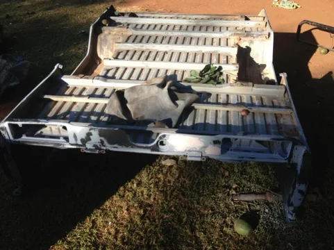

The tray cleaned up nicely and had one spot to braze & needed a new tailgate
So the Big question is "what color" ? Let me know your thoughts...

Then I need to do the build list... Seen it lots on TV... Gonna start with engine, water system, alternator, starter & solenoid so it starts & stops and charges. Then add gearbox and propshafts, front diff needs attention, back diff done. Shackles and bushes done. Got a few new sets of shocks around, once the drive train is sorted I want to put on the tub and get it driving and stopping
