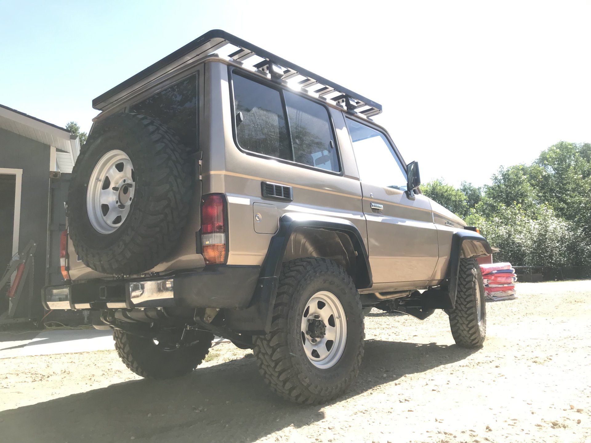

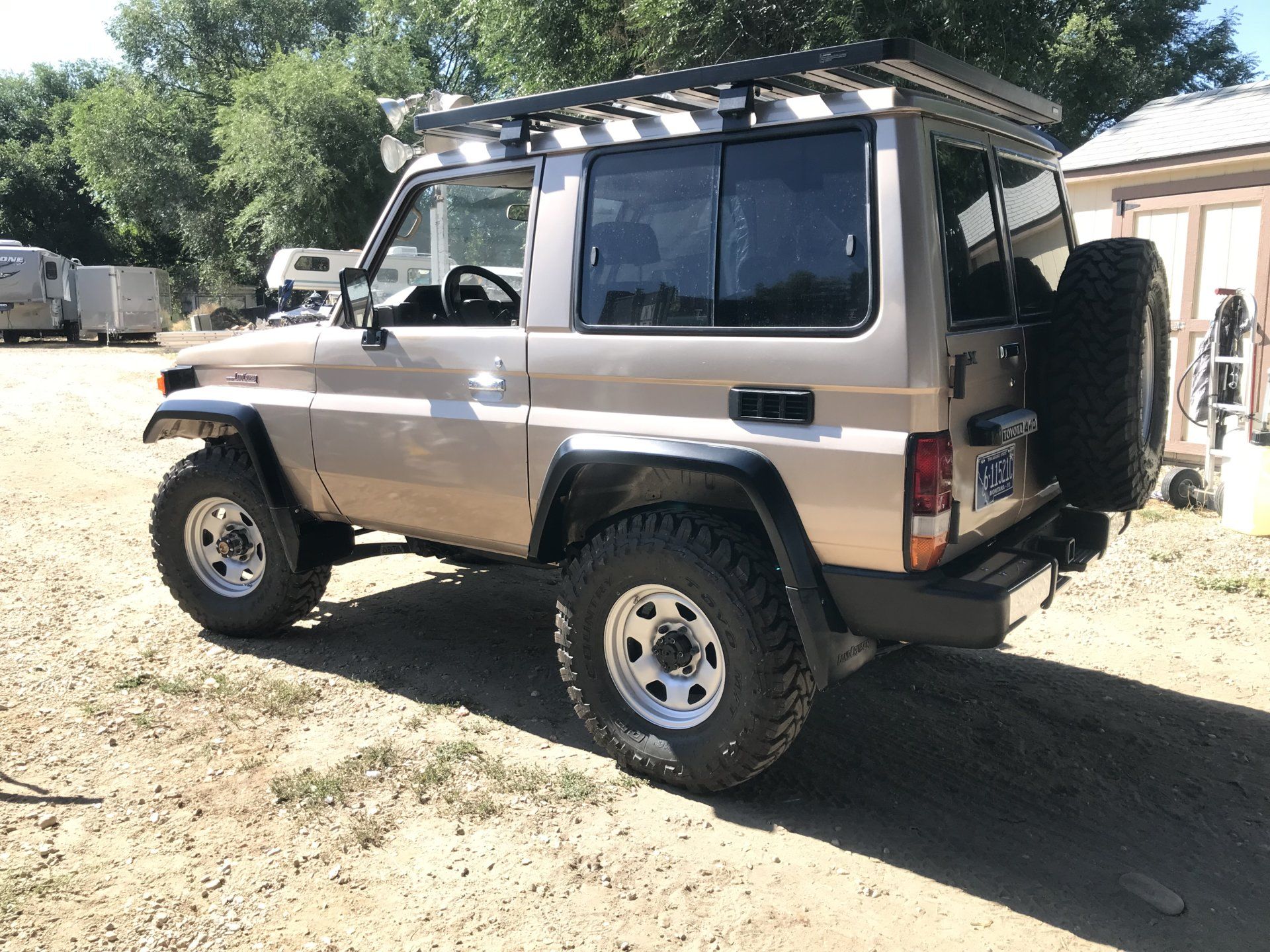

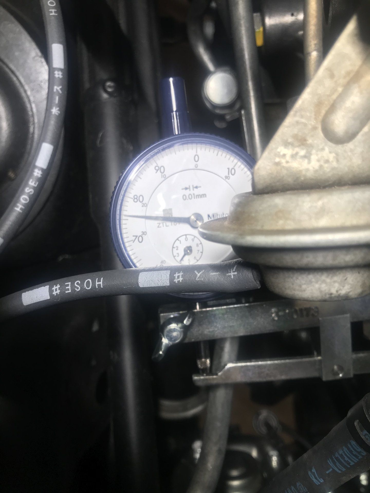

Client showed up so had to visit with him awhile. Finished timing it, put it back together and took it for a drive.
WOW this truck runs stupendous now! Out by .08mm seems to make a lot of difference.
Cheers
Clutch adjusted today until it was just right.
Steering box adjusted multiple times today until it was just right.
Shocks softened up a lot, feels way better.
Front driveline is groaning in phase or out of phase. No vibes, just groaning. Looks like a DC shaft will have to go in it.
Need to adjust headlights in the morning, toss on drivers seat cover and yank the front driveline. That’s it and the truck is off on it’s first road trip with the owner! That makes me happy. :)

Are these tools specific to the IP that they are used on?? I ask this because the lever pivot does not seem to be in the middle, which would amplify the movement (reading) on the guage side?? Or does it pivot in the middle. Sorry if this is a dumb question, but i once made a fitting to get the guage directly in the IP of a 3BII ( rotary pump), and I never got it right. The right tool may have solved the problem!!
As far as I know it is for 1PZ/1HZ & 1HDT. I bought it from Toyota using the part number listed in the FSM. Not sure if it works on other diesels. It worked well and after setting the timing the engine is running the best it has ever ran.

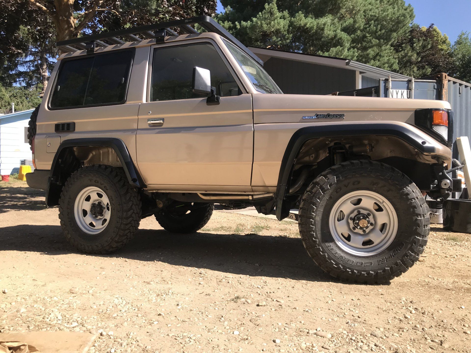

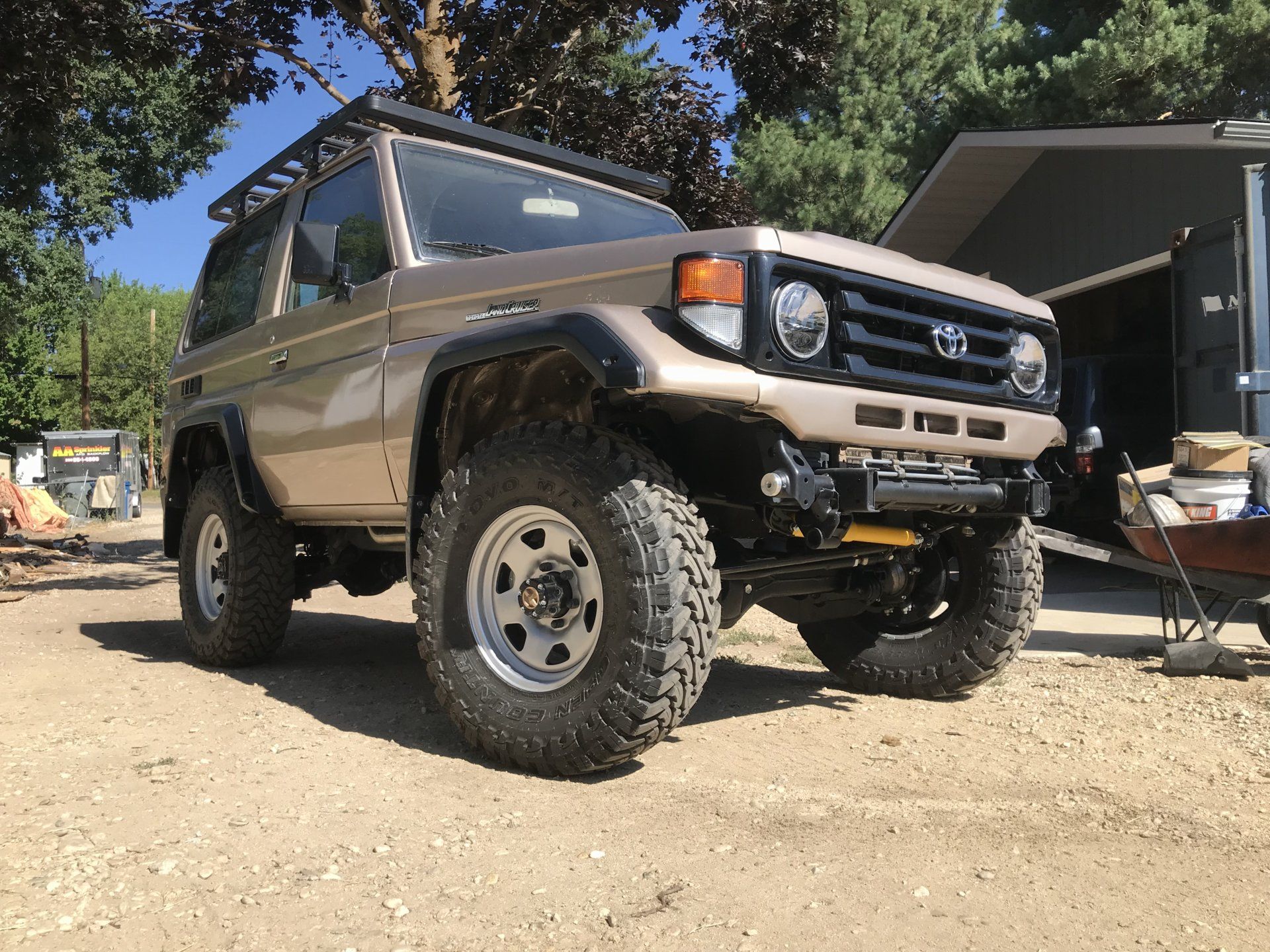

So if you follow @Delta VS on Instagram you can see sneak pics of the front bumper.
I will post pics once it is back from powder coating and mounted.

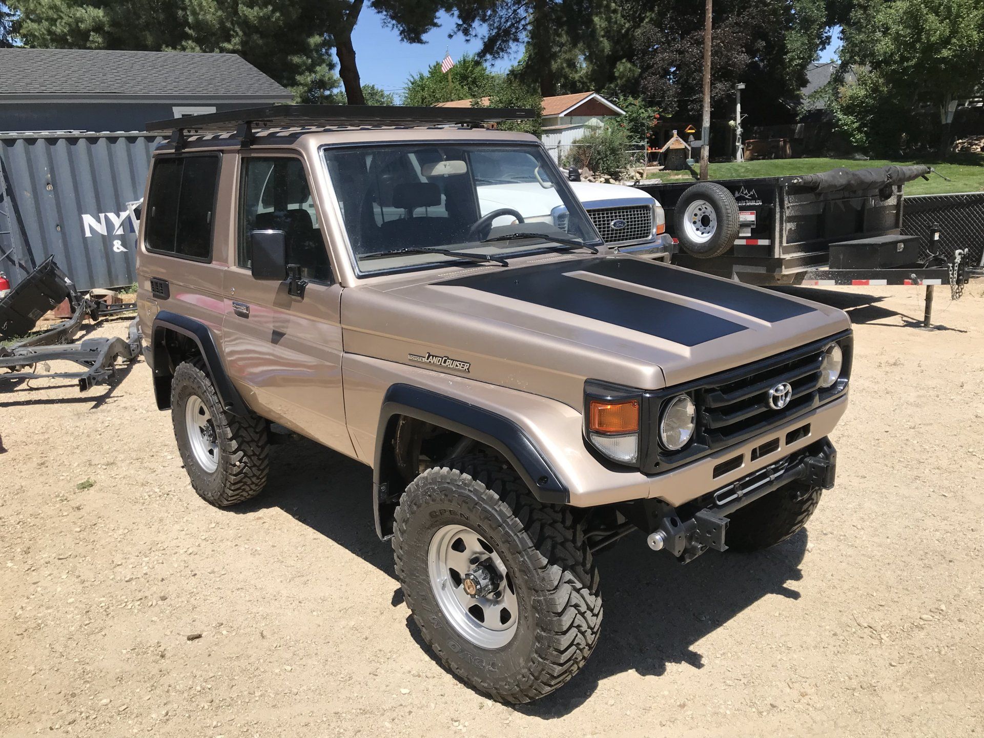

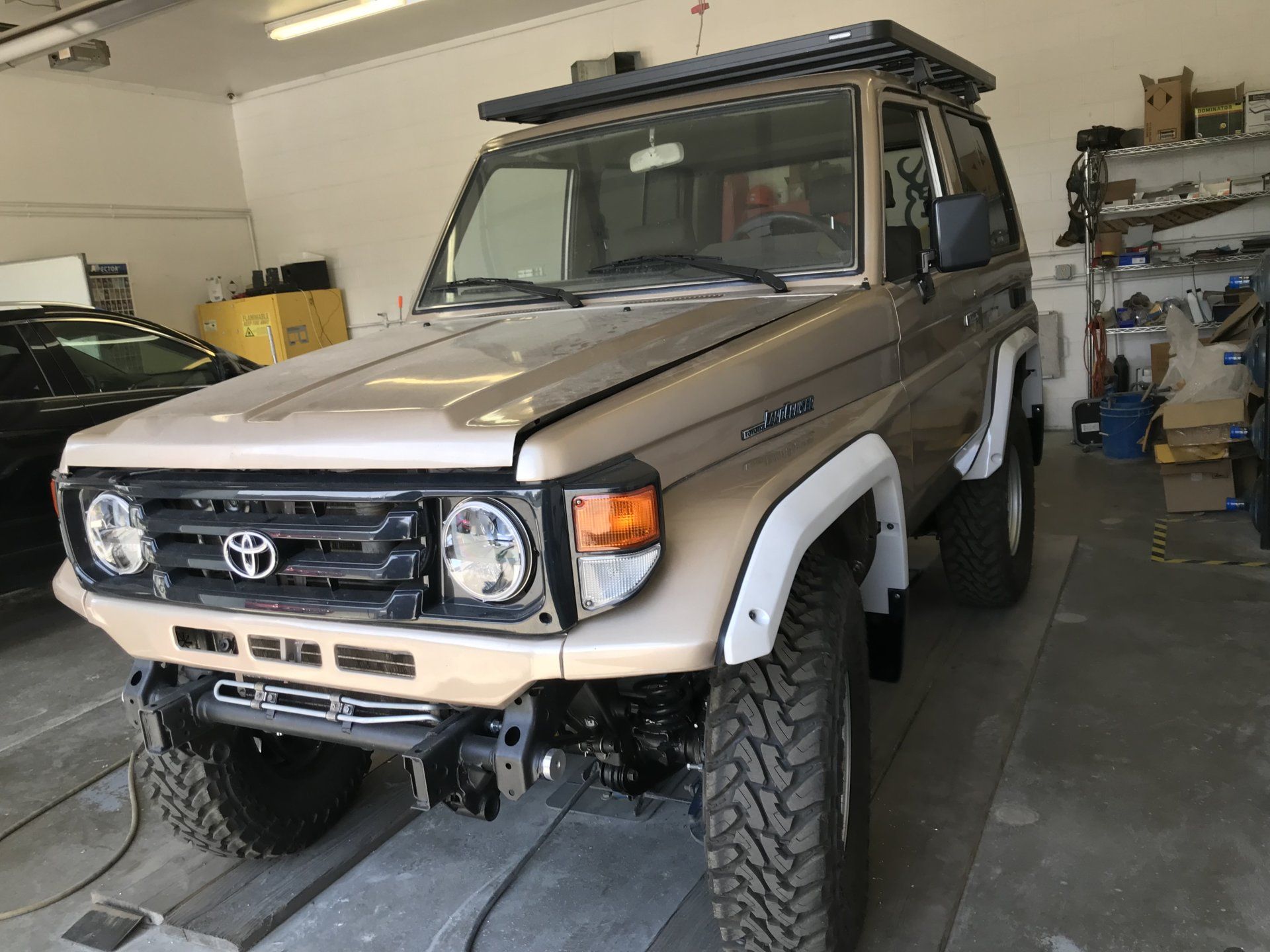

You are either going to like this or hate it! :lol:
Personally, I like it and think it will look great once the black front bumper and sliders are fitted. Certainly changed the look of the truck, gold and black. :)
