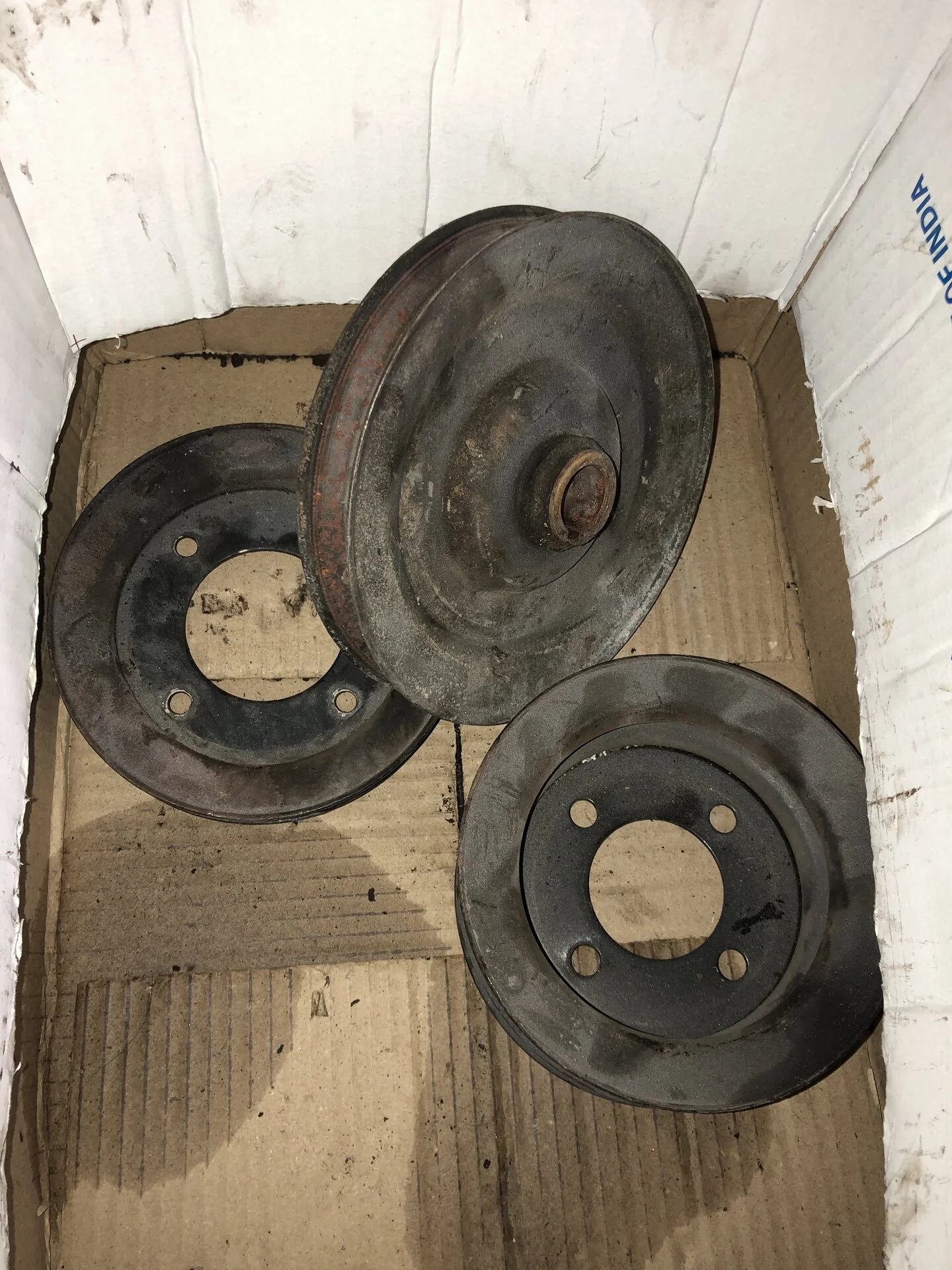

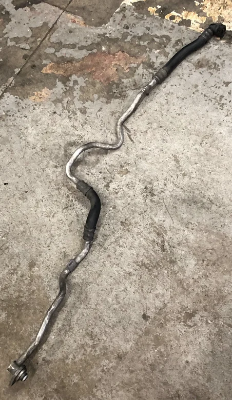

Hey guys, Put all the smog stuff I knew was smog stuff in a box, im trying to sell all together but ran into a few roadblocks.

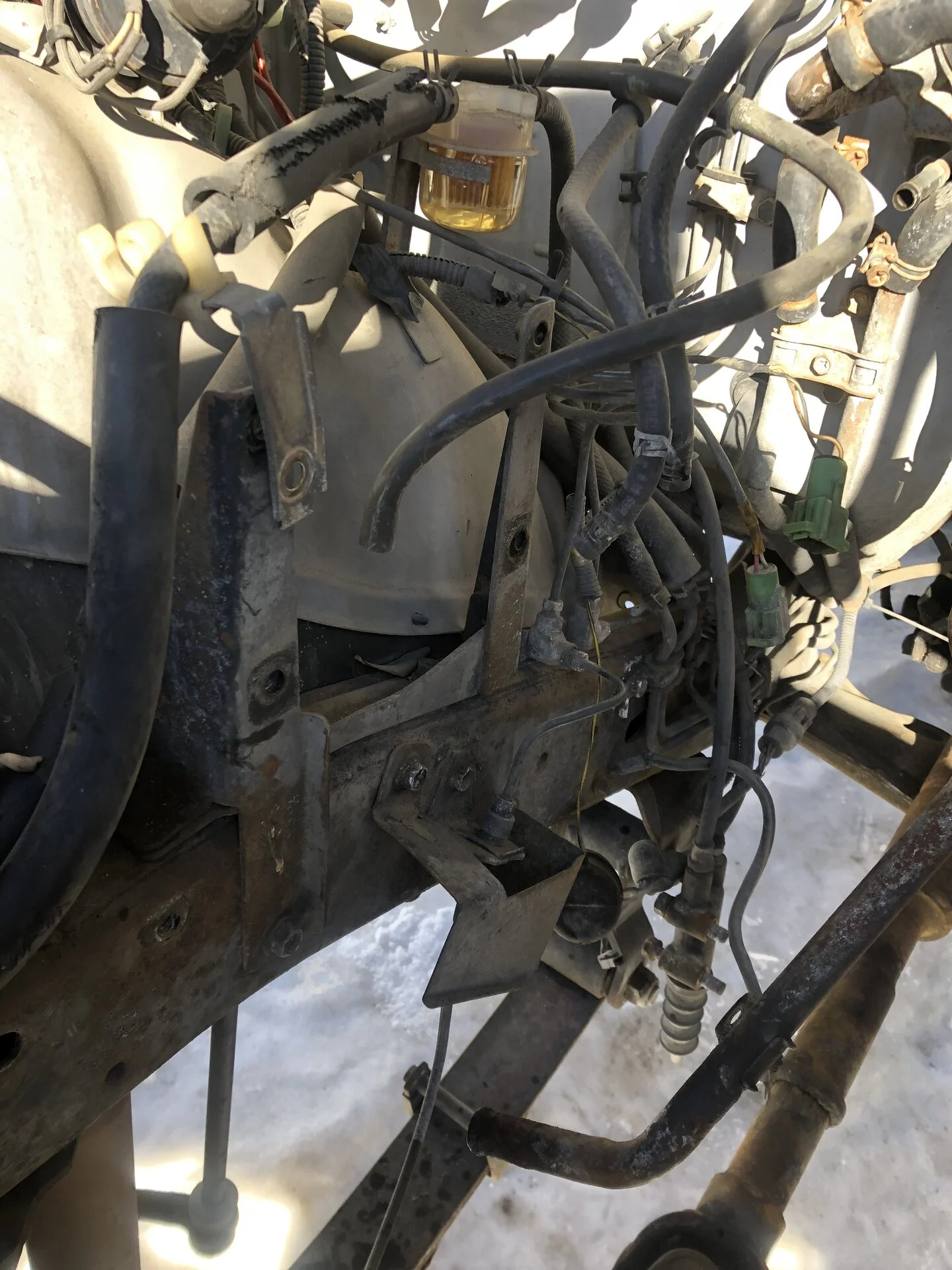

I think a lot of the vacuum lines and such are still attached within the engine bay, and not sure what I need and what can come off.
Same goes for random things I have in my bins, so if anyone has a I minute I uploaded pics of what I have and if any of it is smog feel free to speak up.

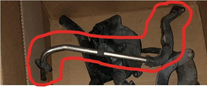

The other road block the air injection hose had something snap off I think when it was on its way here. pic of that is up as well if you guys can confirm its garbage.
First two photos are of the broken hose and the other one is of the box I already have prepared. Rest of the photos are there to go thru for double checking. (PS No sign of charcoal canister as far as i can tell. BUST!)

@Beehanger your dropbox link shows alot of non-smog parts that you will need to run your truck like your throw out bearing fork, oil cooler, power steering pump bracket, engine mount, etc. Also, some parts that maybe they are from a different truck look like they are mixed in with your FJ60 parts, like the alternator. Can anyone tell what these are and where they came from on an FJ60?

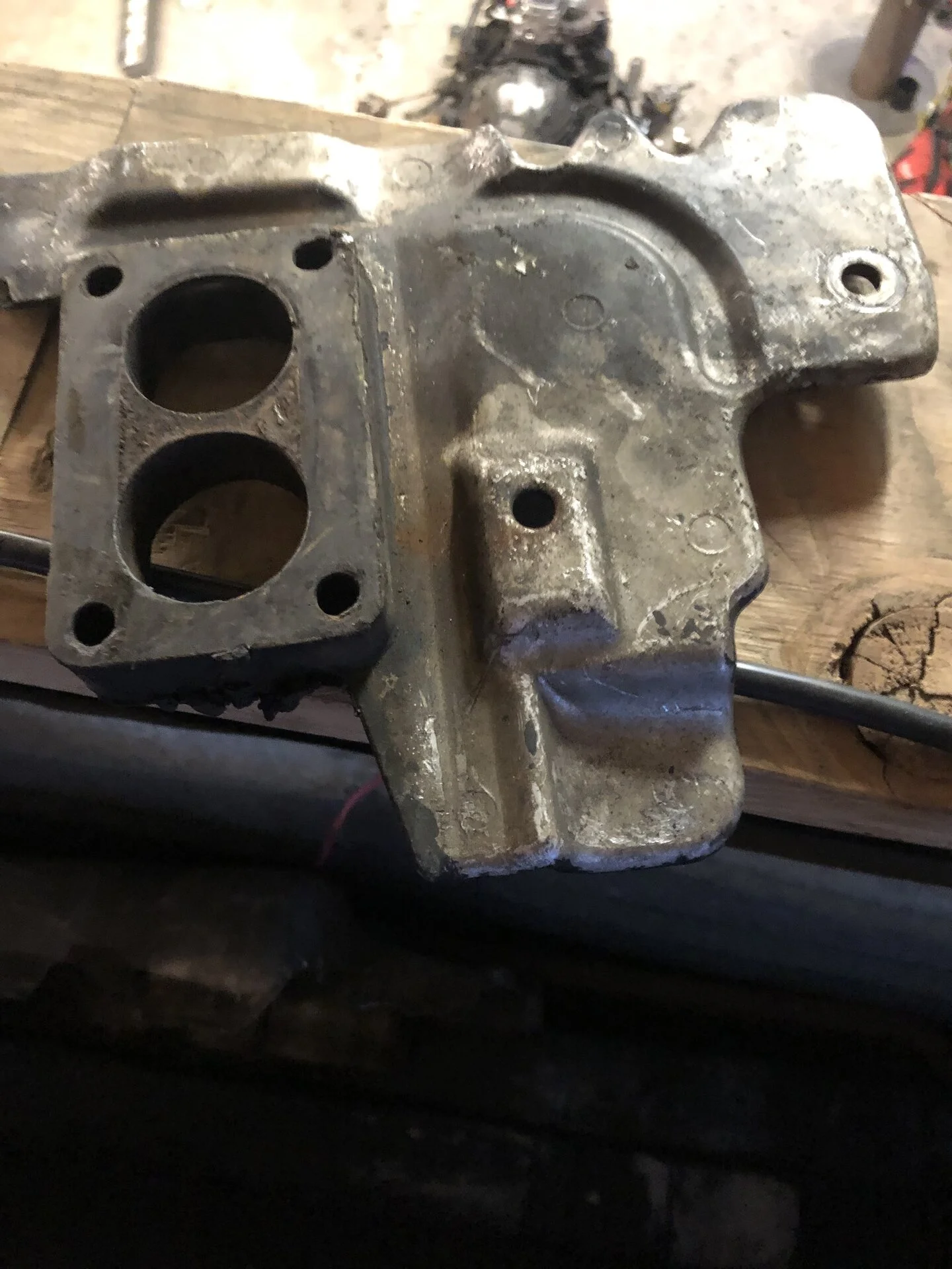

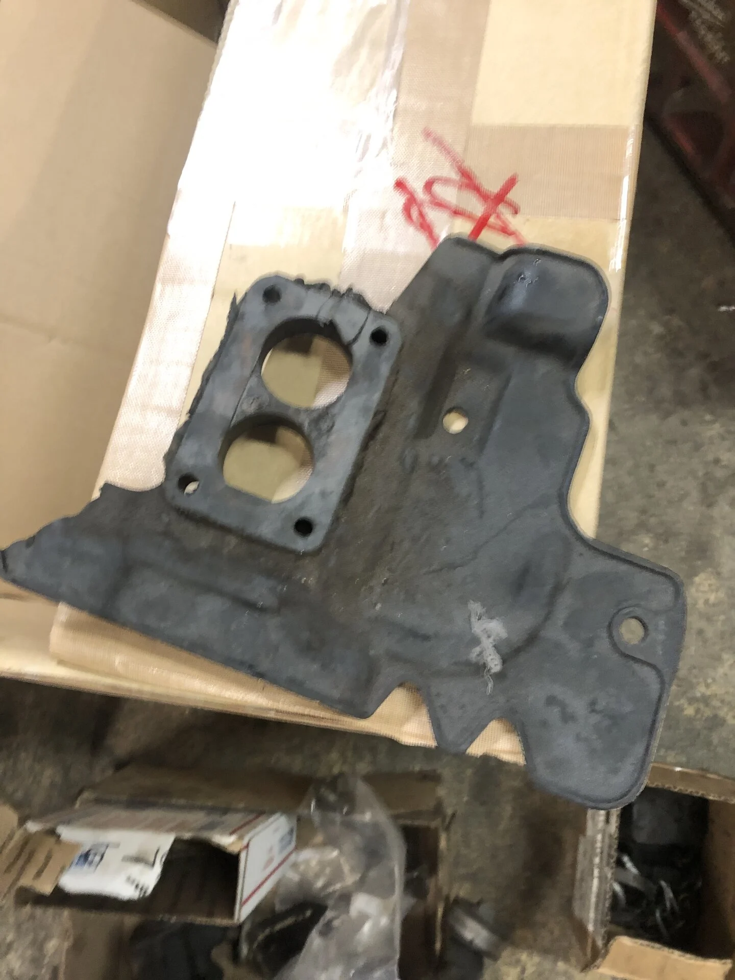

Any others? This one? Getting block of late so may not need it yeah?
I think I went a little overboard considering me and the mechanic semi helping me pointed out the PO sent me 3 ****ing exhaust manifolds. I thought they were smog related but no they weren’t. Unfolds amount of s*** was sent with my stuff for reasons I’ll never know. I’ve narrowed it down except for the items I’ll post next
I think I went a little overboard considering me and the mechanic semi helping me pointed out the PO sent me 3 f***ing exhaust manifolds. I thought they were smog related but no they weren’t. Unfolds amount of s*** was sent with my stuff for reasons I’ll never know. I’ve narrowed it down except for the items I’ll post next
I am still assembling my engine following a rebuild as well. If I were in a non smog state I would still save the smog parts until the engine is put together, installed, tuned, and running how I want it and then sell the emissions equipment. Especially since you are still learning how the truck is going to go together. Some stuff can be left off, like the EGR cooler, EGR valve, and catalytic converter. But if you want to run your factory carburetor you might want to keep your fuel line, the carburetor linkage and other items. Some people also keep the lower smog pump brackets and run an idler pulley in place of the air pump. If you have access to seeing someone else's desmogged truck and their setup, that would be the biggest help.
Keep that. It deflects heat from whatever air/fuel device you put on there. It's not disposable. You can trim it later, but it is a friend.
My Sniper doesn't mind it. Lots of heat coming off the manifold.
