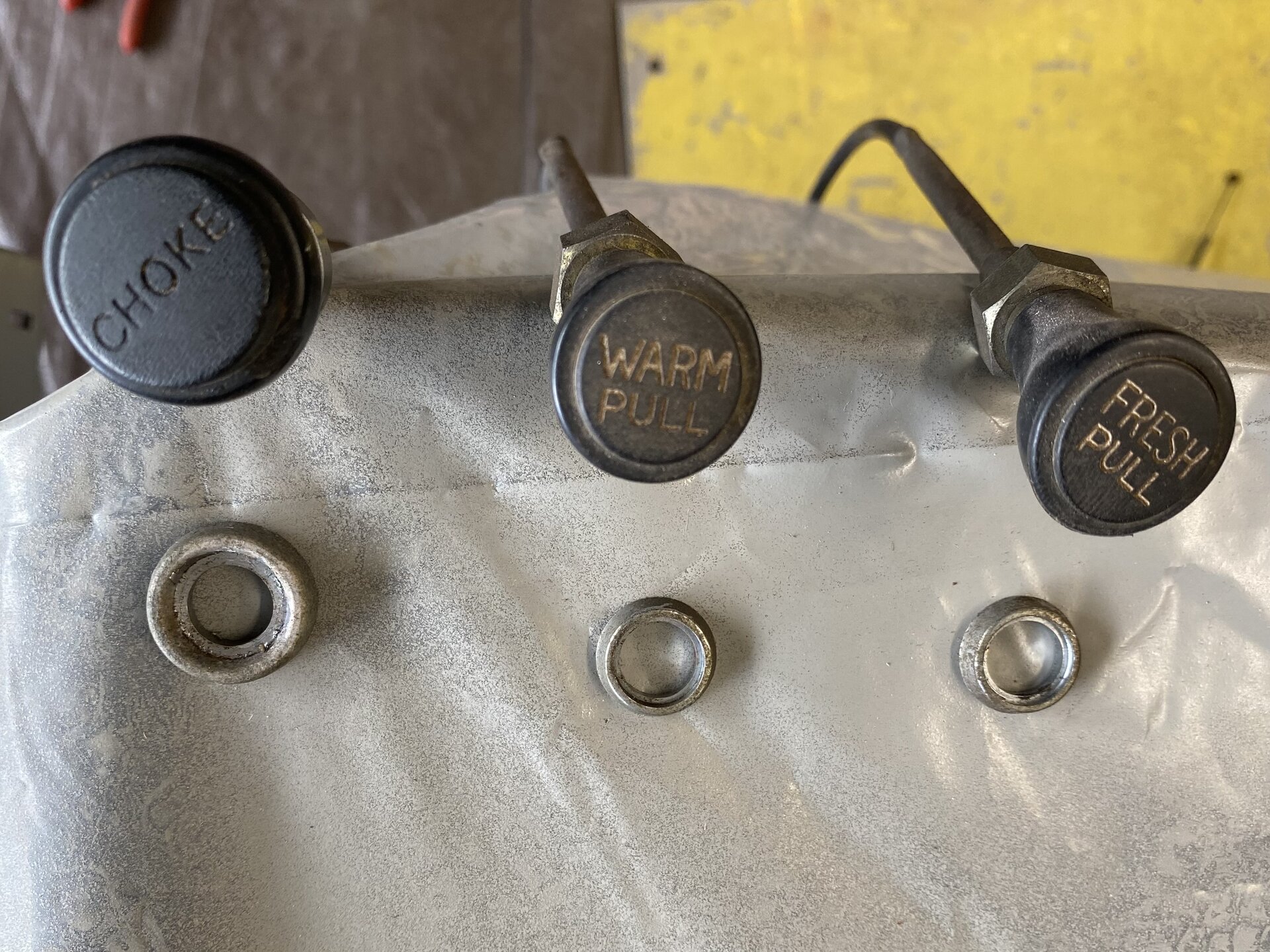

Depending which knobs they are, the ones that don’t have set screws don’t come off. You have a nut in the back side of the dash that needs to loosen and the the whole knob and cable pull through and out (choke, warm pull, fresh pull, etc).

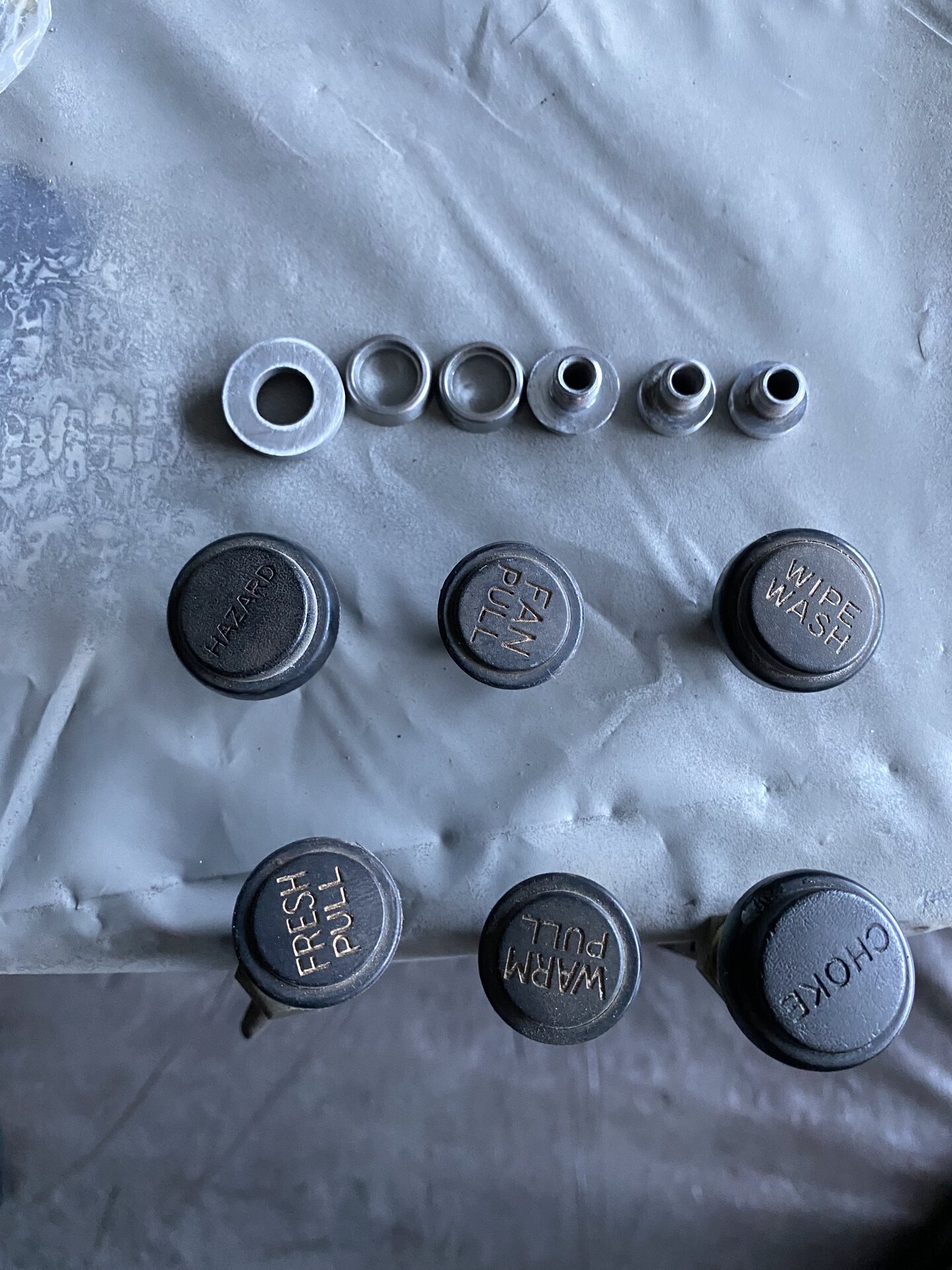

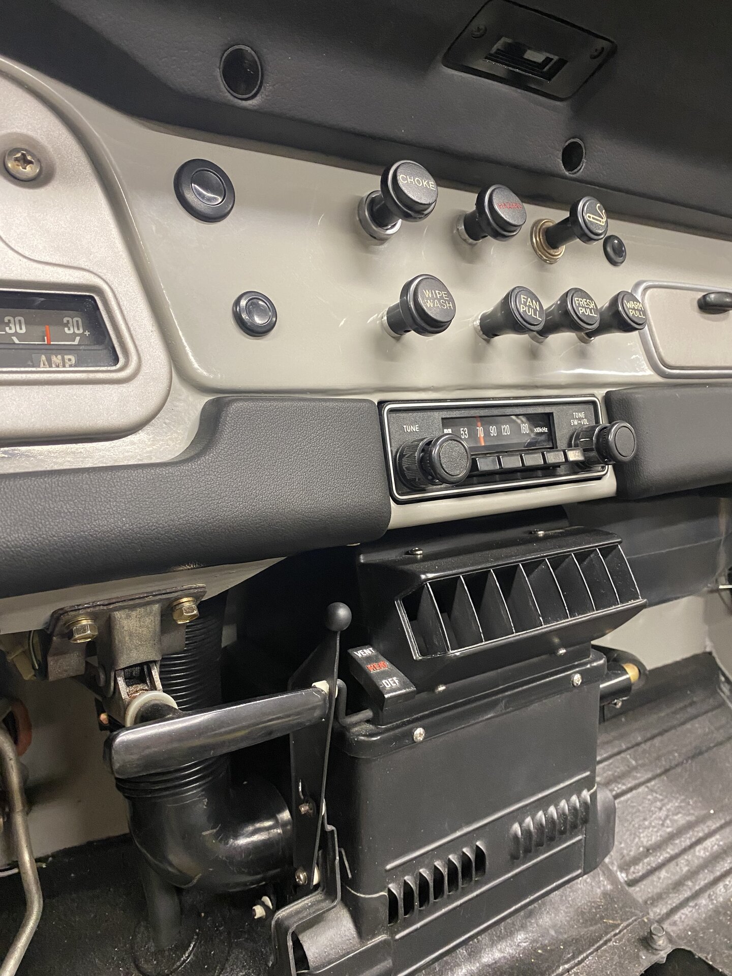

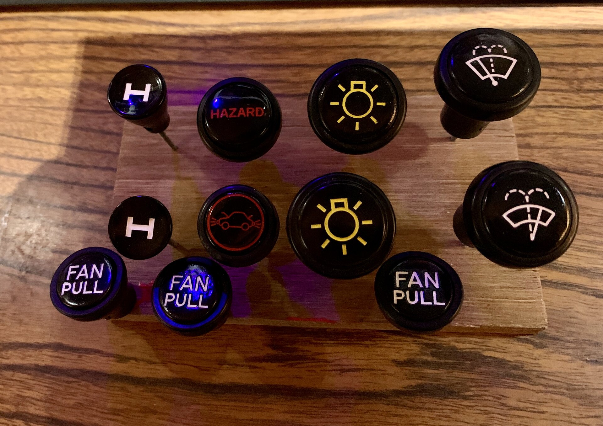

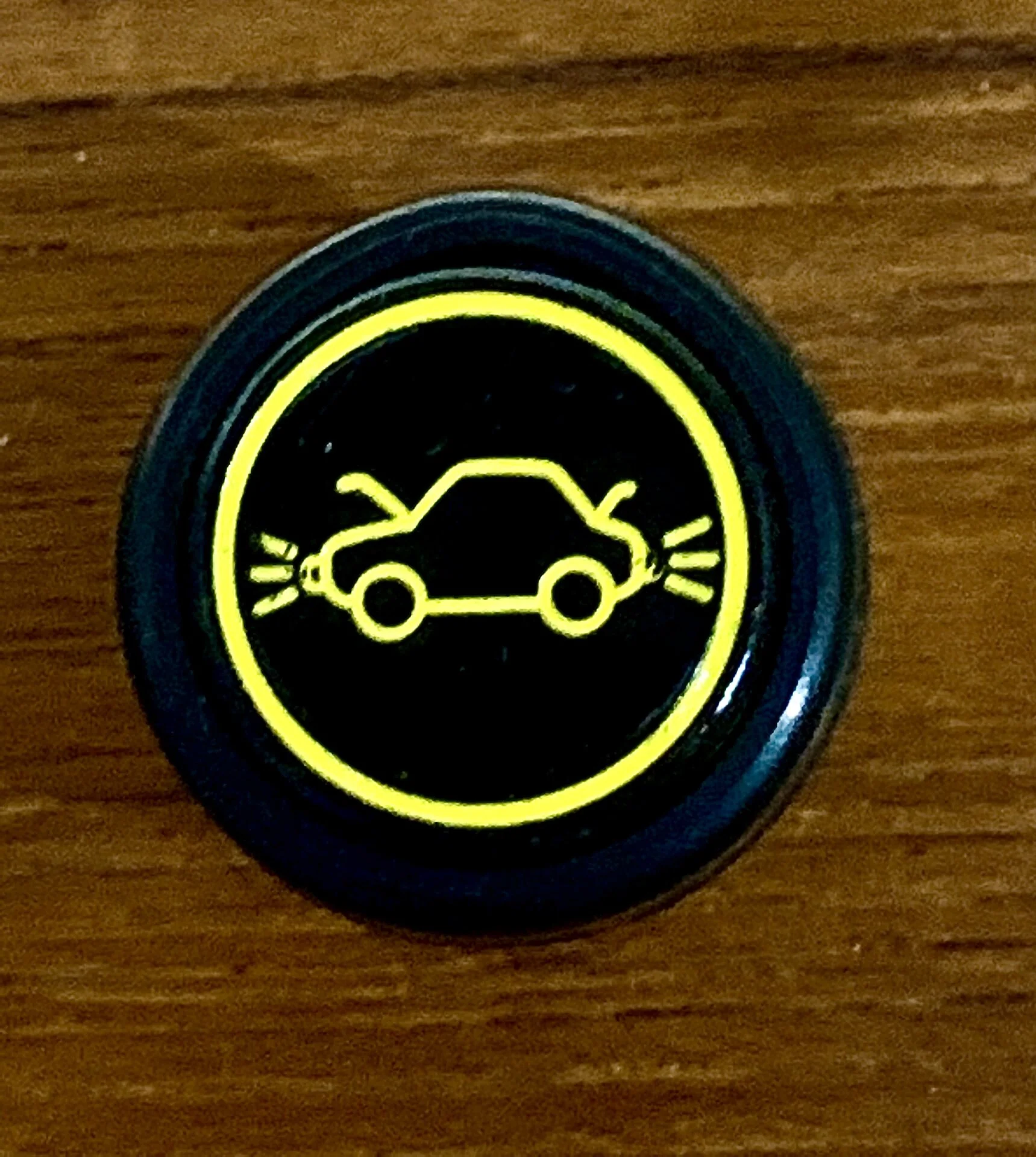

Here are mine in my 1975 fj40 that I just restored:
These don’t have set screws and need to be pulled out after loosening the nut behind them.

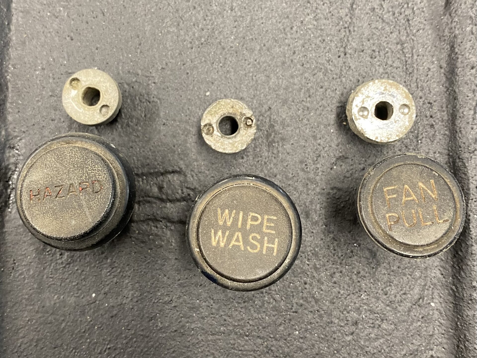

These are the ones with set screws:

WARM PULL
FRESH PULL
HAND THROTTLE
CHOKE
Are all cast / vulcanized onto the D-GROOVE shafts
You must pull the whole cable
NOTE the D -GROOVE profile holes in your meter dash …

The cable knobs should have a 17 MM nut on the backside of them. Shorty wrenches to get them started, hopefully the rest of way it will loosen with the 2 fingers you can reach them with.

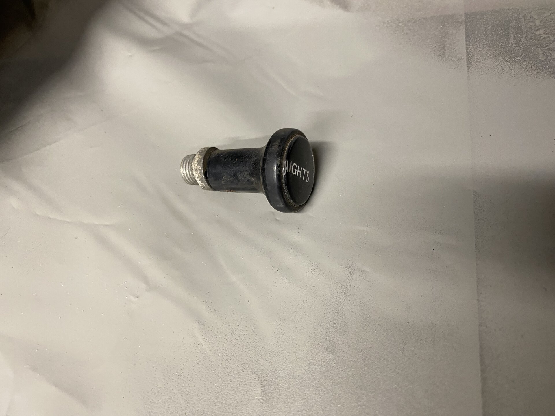

The set screw (switch type) are a small phillips head, loosen and unscrew the knob off the stalk. Should be able to access the grommet and remove.
Here is a picture that might help. I think someone replaced the Choke cable nut with a weird 15 MM?
