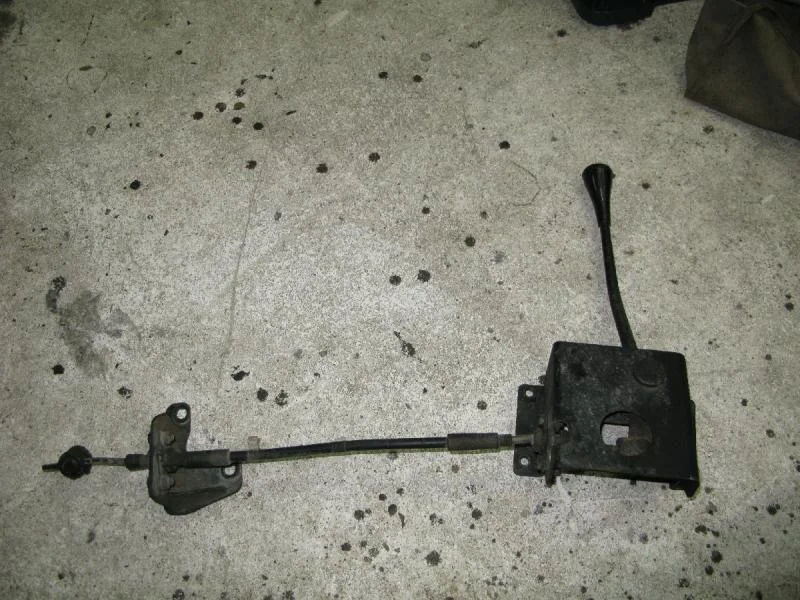

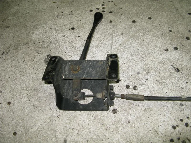

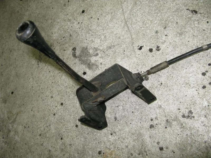

There is a cable type shifter from toyota that was used in some late 40 series (very rare apparently but saw one for sale recently) as well as in some 60 series trucks (maybe not so rare?) Might check in with the 60 series forum and see what they can tell you. No affiliation to the sale but the pics are of mine (as of yet un-installed.) I have been told that it is mounted to the tunnel. I need a new cable for mine.
Will you do something to keep the cable laid in like the jimny guy did? I've never seen that before.

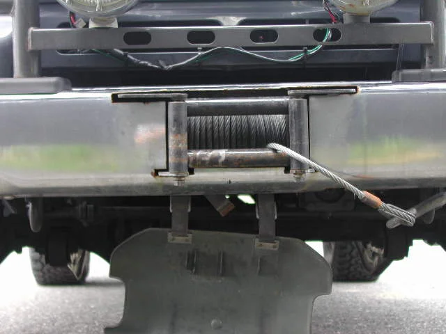

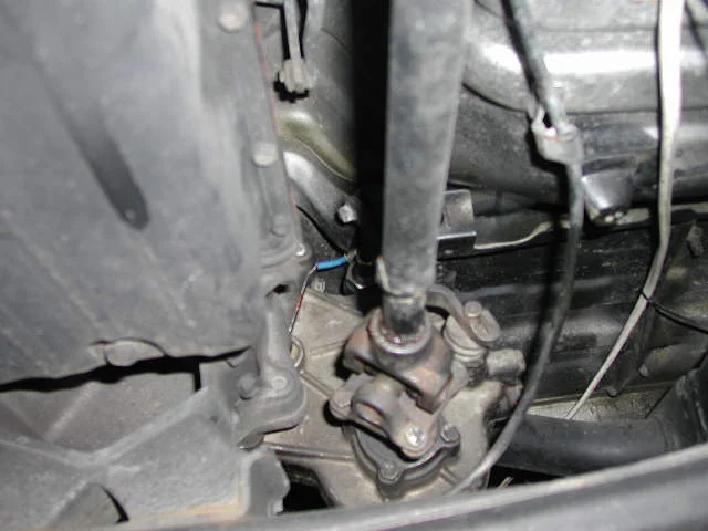

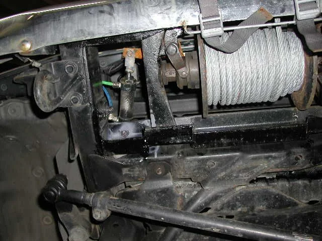

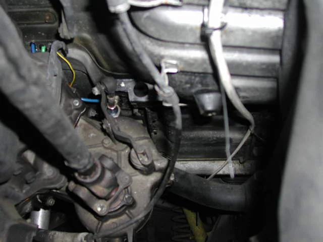

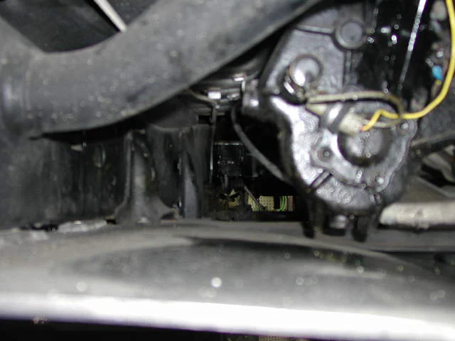

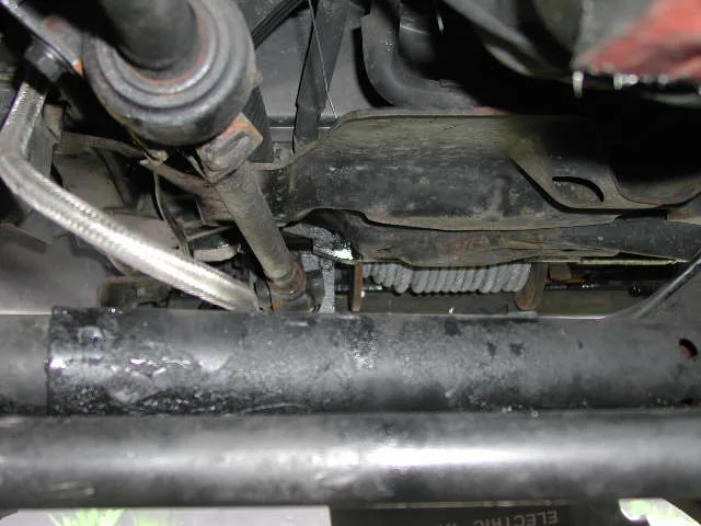

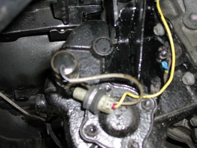

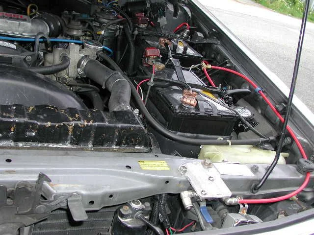

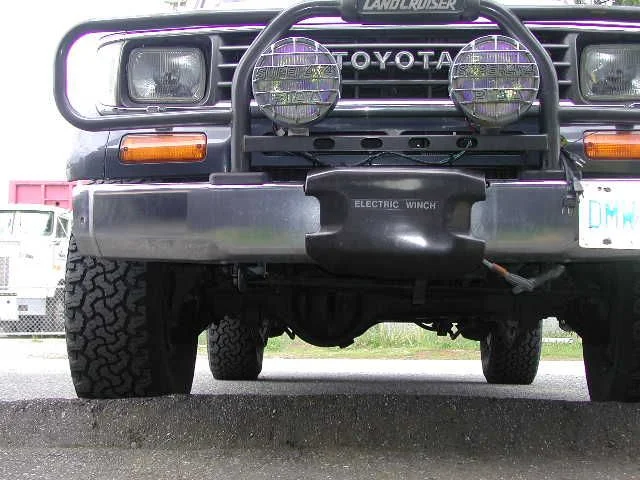

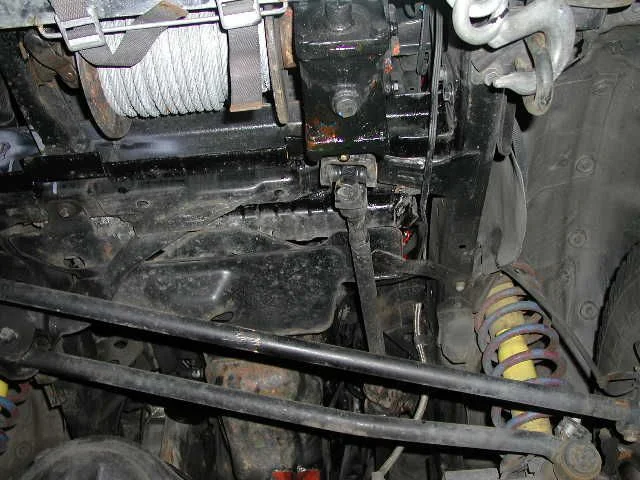

air pump installed under hood for operating actuators to winching or releasing cable or for pumping tire pressure. it need 60 psi min to operate.can pump up to120 psi. a 3x12 inch alluminiun air tank installed inside the left frt fender.

Nice looking setup.
I am trying to avoid air operated anything at the present time.
Even my freespool will probably be hydraulic (clutch master and slave system)
The winch input drive looks low and venerable to knocks.
The guys here have notched the front chassis cross member a little more than the factory one and moved the radiators up a bit and or get the bottom tank notched to clear the drive shaft.
I wont have this problem being a mid mount.
Thanks for sharing.
