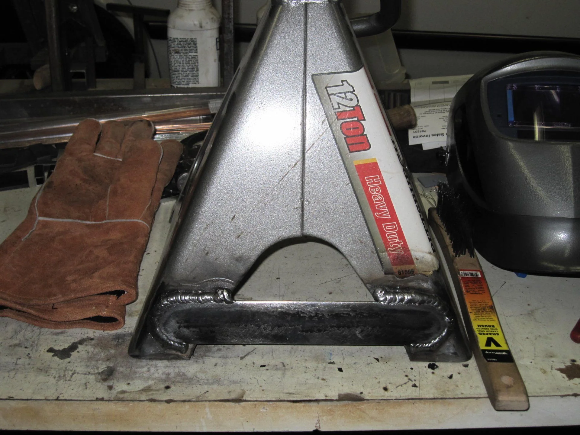

The failure at that welded seam is pretty much a product design failure, done simply for manufacturing ease. Those vertical welds tying the 2 stamped steel legs together - puts the welds under tensile stress - is a fundamental no-no. Stress on welds should always be placed under shear load along the length of the weld seam. If your jack-stands are made that way, you can easily reinforce that properly, if you have access to a welder. Just put a strap of 1 inch wide x 1/8" thick hot rolled steel (for example) across from one leg to the other, with horizontal weld seams. Easy,cheap - strong.

Interesting. They'll take any jack on that list back according to this. Tempting in principle. The question for me, though, is what would I replace my HF 12 tons with, that is both clearly better and still reasonably affordable? And would I not be better off to just weld on some -or a lot of- steel across the legs if I do become uncomfortable with the jacks to make them safer at much lower cost overall?

Oh!!! You guys and your nagging and worry-warting - NOW look what you've gone and made me do...and I was perfectly happy with my ridiculously huge HF 12 tonners bought on sale...like I needed a welding project? It's 97 friggin degrees around here at midnight!
