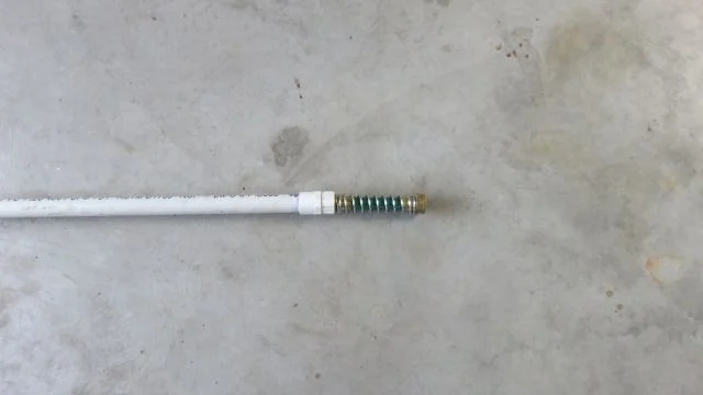

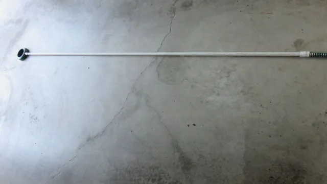

I haven't been seriously off road in my 200 (yet) but I've been using something like this on all my cars for something like 35 years for dirt & road salt:
  1. 10 ft 3/4 in. PVC pipe
  2. Garden hose strain reliever
  3. Female hose to pvc adapter
  4. Male hose to pvc adapter
  5. Circular sprinkler
It's not fancy but I made it mostly out of junk I just had laying around the garage.
I just slide it around under the cars; the sprinkler puts out a pretty good spray and gets the underside pretty clean too!

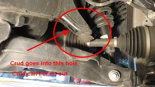

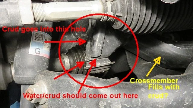

I see what you're saying about the rear bumper - pic1. But what I observed didn't quite match your description shown in pic 2 - unless I'm misunderstanding, plus I'm wondering about another issue with the crossmember.
Pic 1 - rear bumper - camera behind the front right tire facing forward - yep there's an issue:
Pic 2- front bumper - camera in front of the front right tire facing rear - there are weep holes and they should let water out the bottom right? HOWEVER - regarding the crossmember - is it hollow and does it fill up with water/crud with no escape?
