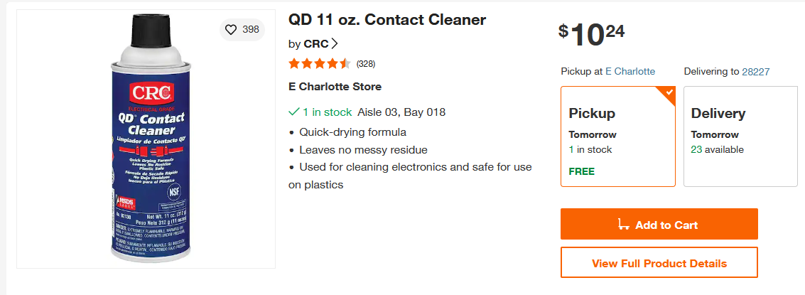

I'd recommend you get a can of CRC plastic safe electronic cleaner and go to work on the connector housings. Those things are nasty. You definitely have a lack of connectivity problem.
Didn't do anything but drive it today - now it all seems to be working perfectly ¯\_(ツ)_/¯
