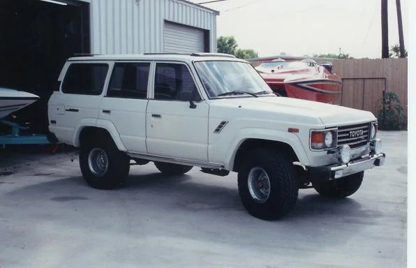

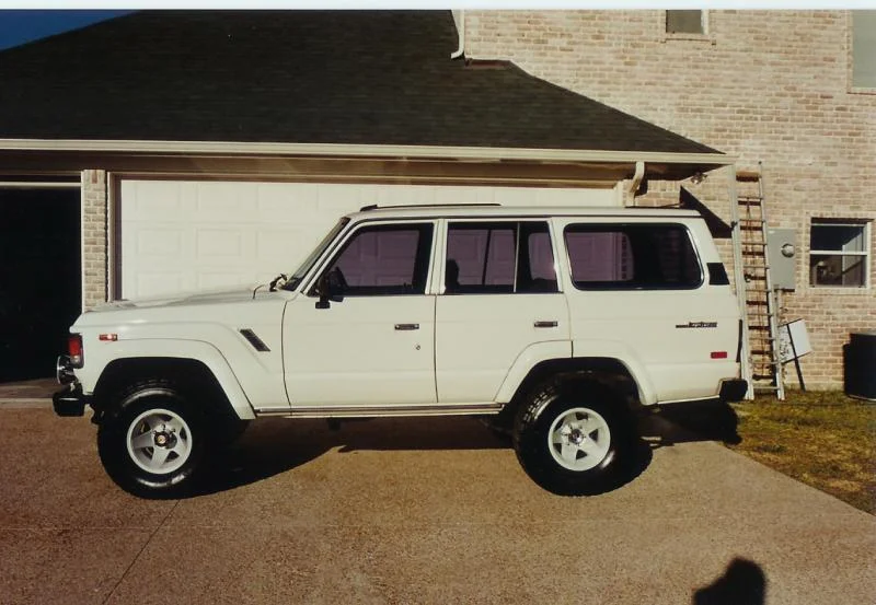

My goal is to make it look like my first 60 I built back in '87 minus the 350 TPI engine and such, but with 35's instead of 33's. A cool mod back in the 80's for Cruisers was to cut the centers out of GM Ralley wheels to run on your Cruiser. Back then there were not very many options for aftermarket wheels that looked right on Cruisers so I went along with the trend. Went aftermarket for a short time, then back to the GMs. Dig that Armor All

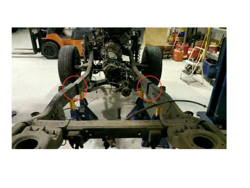

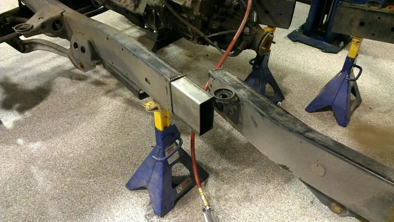

Thanks...Made some progress today. I had to have some 12" pieces of rectangular tubing made to sleeve the inside of the cut frame. Thanks to Slee's machine shop, the frame came back together perfectly and even square. Imagine that.
I am not going to plate. I will weld around the seam then rosette weld in several areas. I do not want to see where it was ever done. The sleeve was thick and with side, upper, and lower rosettes, it should be at least as strong as factory. On top of this, I am going to use a Slee belly pan for an 80 that will overlap this seam and bolt the 2 frame halves together.

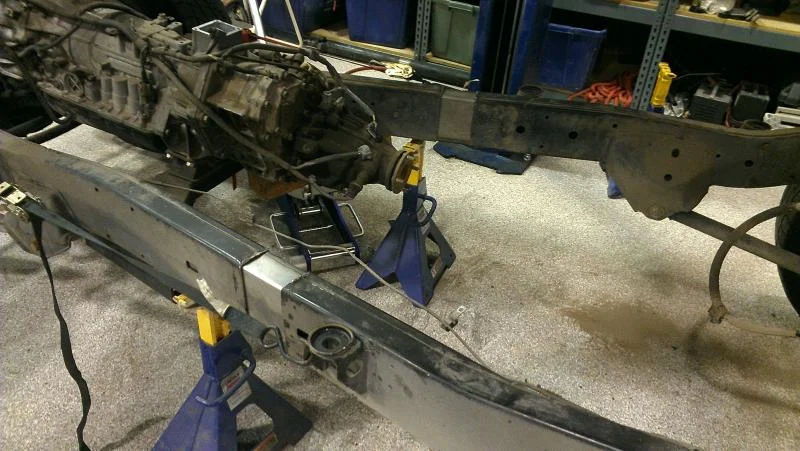

Just curious how big a deal or not this is/was to deal with...I noticed you used a ratchet strap so maybe there's enough easy flex in the frame (width wise) to easily accommodate your splice without worrying about alignment issues?

Honestly I was a little worried about that as well. The frame turned out to be 3/4" off on each side and I was considering making a frame splice that would make up that difference. I decided to have the inserts made anyway and give it a try first. By sliding the inserts 1/2 the way inside the engine side frame first and tacking them, it brought the rear frame to within 1/8" on each side. I slid one side in some, then worked the other side in some, all by hand and without the use of a strap side to side, then attached 2 come-alongs, one per side, and started ratcheting. I was pretty surprised when the 2 sides of the frame slid together with no real friction. The 12" insert is evenly spaced and the frame is still perfectly square. My only concern was the rear lower arms binding because of the frame being pulled in, but after measuring at the splice and at the control arm mount, the frame had pulled in only between the control arm mount and the transmission mount area. The engine side of the frame had spread apart almost an equal amount. Christo wanted me to cut the frame where the control arm mount is, but I'm lazy and didnt want to have to cut the mount off, shorten the frame, then reattach the mount. This was easy and I'm relatively certain that it will be plenty strong.
By rosette welds, you mean there are holes in the frame through which you can see the insert and you're going to run a bead around the inside of the holes to the insert?

I'm no engineer-- but it sure seems like rosette welding along the factory holes in the frame-- to the insert-- should be plenty strong enough, especially with butt welding the frame halves.
sandcruiser said:
I'm no engineer-- /QUOTE]
Just like sandcruiser, I have never driven a train...but I agree with his assessment!
I'd leave a 1/4" gap so the welds at the butt joint had good penetration into the insert. If you did so you could grind it flat and you wouldn't even know it was there.
"The welder giveth and the grinder taketh away."
Beveled it to about an 1/8", but my welder can burn through the frame easy.
Yes, Rosette welding the outer existing holes to the insert. I cannot imagine it not being adequate, but I'm no engineer either.
