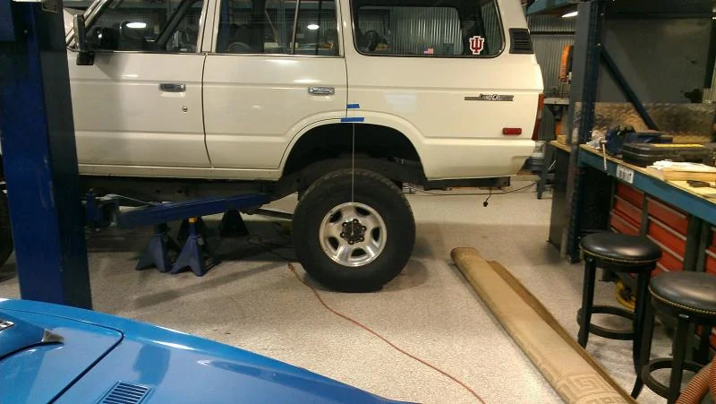

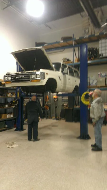

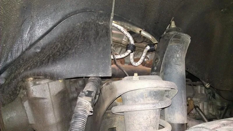

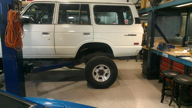

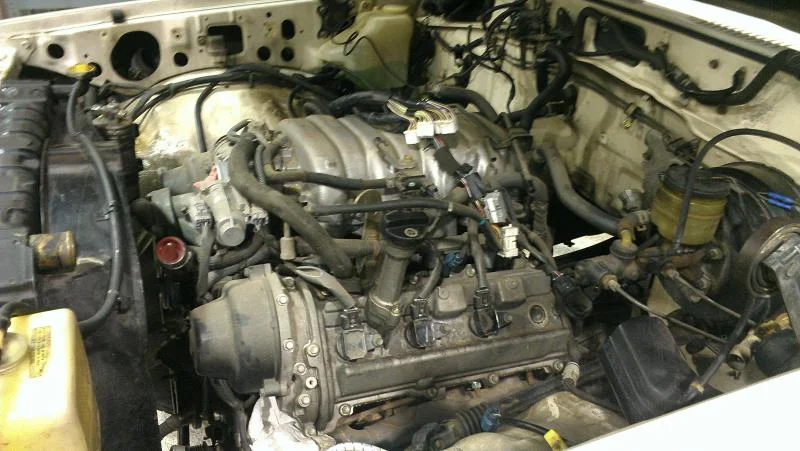

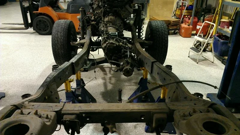

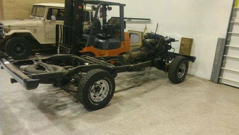

Just got the body off today. 2.5 hours total with 2 extra sets of hands. The V8 will have to be lowered about 3" and pushed back about 4" to sit where I want it in the body. The chassis will have be shortened about 6" and the rear of the 80 frame will have to be cut off and new rear frame rails be grafted on to align with the 62 body. For some reason the rear of the 80 frame dips down and the 62 goes straight back. There is lots of frame work to make this conversion look like factory, but in the end, I think it will be pretty cool. The 62 chassis is nicer than I realized and I may have it sold to a friend to put under his pig. We unplugged and unbolted everything with 0 wires cut and 0 hoses cut.

Gary I probably made a mistake with mine. I added 6" to the rear wheel well to make up for the difference in the frame instead of cutting the frame. I cut it out and moved it back and then put a new 6" of the same body piece. And I haven't done it yet, but I'm doing exactly what you are describing. I'm cutting the frame off right where it starts to turn down and going straight out. Mine will not look factory but will be plenty strong. I'm using 3x5 and then plating both the inside and out at the joint. You should not have problems with wheels. I'm running 4.75" backspaced 17x9s with 37x13.50 Toyos and they barely stick out. If you do the flares like you have on other wagons you won't be showing any tire. What has taken me so long is I got the whole thing wired for a 3FE and then changed my mind when I bought a wrecked FZJ. So I had to rip everything out and start over. I'm hoping to start work on it again in a few weeks. I've not touched it in almost 1.5 years due to injuries. I'm envious of your ability to tackle the 2UZ. I wish I would have had the wiring skill to pull that off. I could have bought one locally for $250 but it didn't have a harness. I'm insanely jealous as I know you'll be done before me and I know yours will be beautiful!

Cut the frame today to correct for the wheelbase. It turns out that for a minimal amount of work the frame can be cut at the angled parts just behind the tcase and sleeved inside or out(mine will be inside just for looks) to allow for the correct 107.5" FJ62 wheelbase. The frame will also have to be pulled back together to close the 1" gap on each side from cutting it on the angles. This could have been avoided by cutting the frame right at the lower control arm mounts, but that would have created many more issues. It appears that there will be quite a bit more frame work to make the 62 channel over the 80 frame so you won't have to look at so much framework hanging down, but most of this would be for cosmetic reasons and probably not all that necessary. I want some frame hanging down to keep the body off the rocks if this truck is wheeled, but not so much that its an eyesore.The rear of the frame will be cut and made straight to tuck it up under the body and the 62 fuel tank will be moved from hanging off the body, to mounted into the 80 frame. The front inner fenders will have to be cut to fit the spring buckets and shock mounts on the 80, and the rear inner fenders will have to be cut to fit the higher 80 series frame rails. The end result will be a channelled body over the frame which will look pretty cool. I am going with stock bumpers with a hidden winch to keep the classic 62 lines as well.
