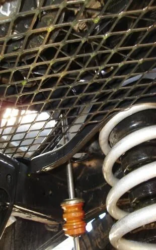

After some minor breakage in Pismo the 45 is back, beter than ever. We, and I say we lightly, had a little mishap involving a shock and a radiator. Apparently the 1/4" thick shock mount bracket was not enough to handle some air as it tore off putting the shock right through the brand new radiator, taking a perfectly good shroud with it. The upper shock mounts were made from 1/4 strap and work fine in most offroad stuff but I never put on bump stops thinking I would never be jumping this thing anyway. Wrong. I beefed up the mounts and will be making bump stops in the near future.

It wasn't made for jumping. Butch called me as I was on my way from SEMA to ask how to get the front spring back in. It seems that although on the trail you never really unload both front springs....you do when in the air :) Its all back together now so I am happy.

You know...I did think about bump stops but the shocks have them built in and this truck was to be more of a slow goer than a jumper, so I let it pass. Oh well....live and learn. I am thinking about the air stops inside the springs just like factory.
