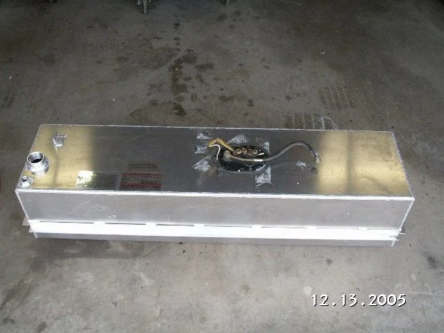

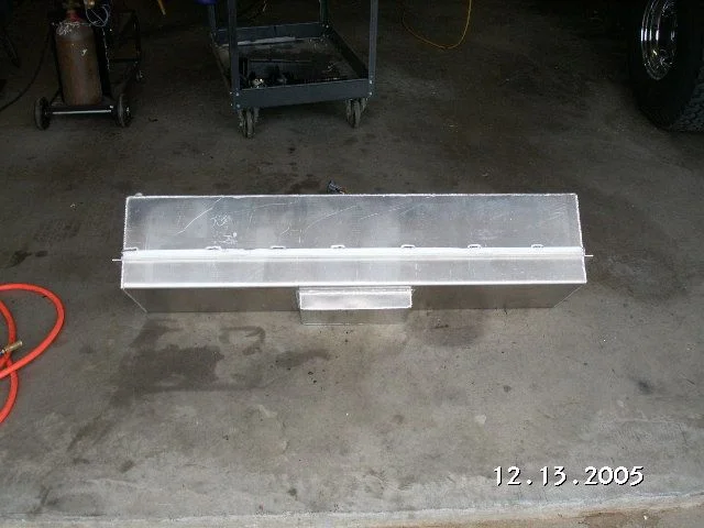

Here is a shot of the final build of the fuel tank. It is 24 gallons, and has an internal box that surrounds the pump and sending unit. The box as you see it is sunk 2" below the bottom but has internal sides that come within 2" from the inside top. The box has 6 5/16 holes at the bottom on the sides to allow fuel to enter but not slosh around. We have used this design in the offshore boats for years and it has worked great. It runs the stock 80 series pump and sending unit.
