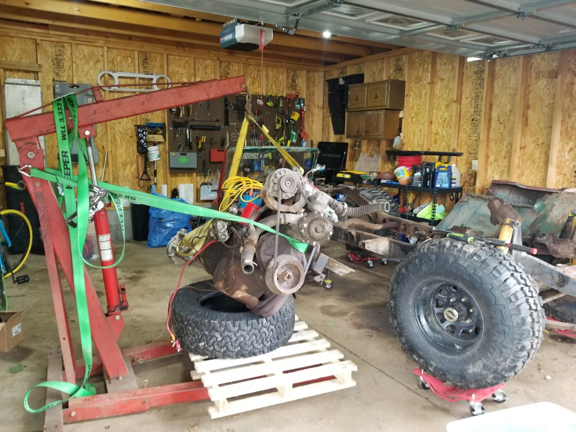

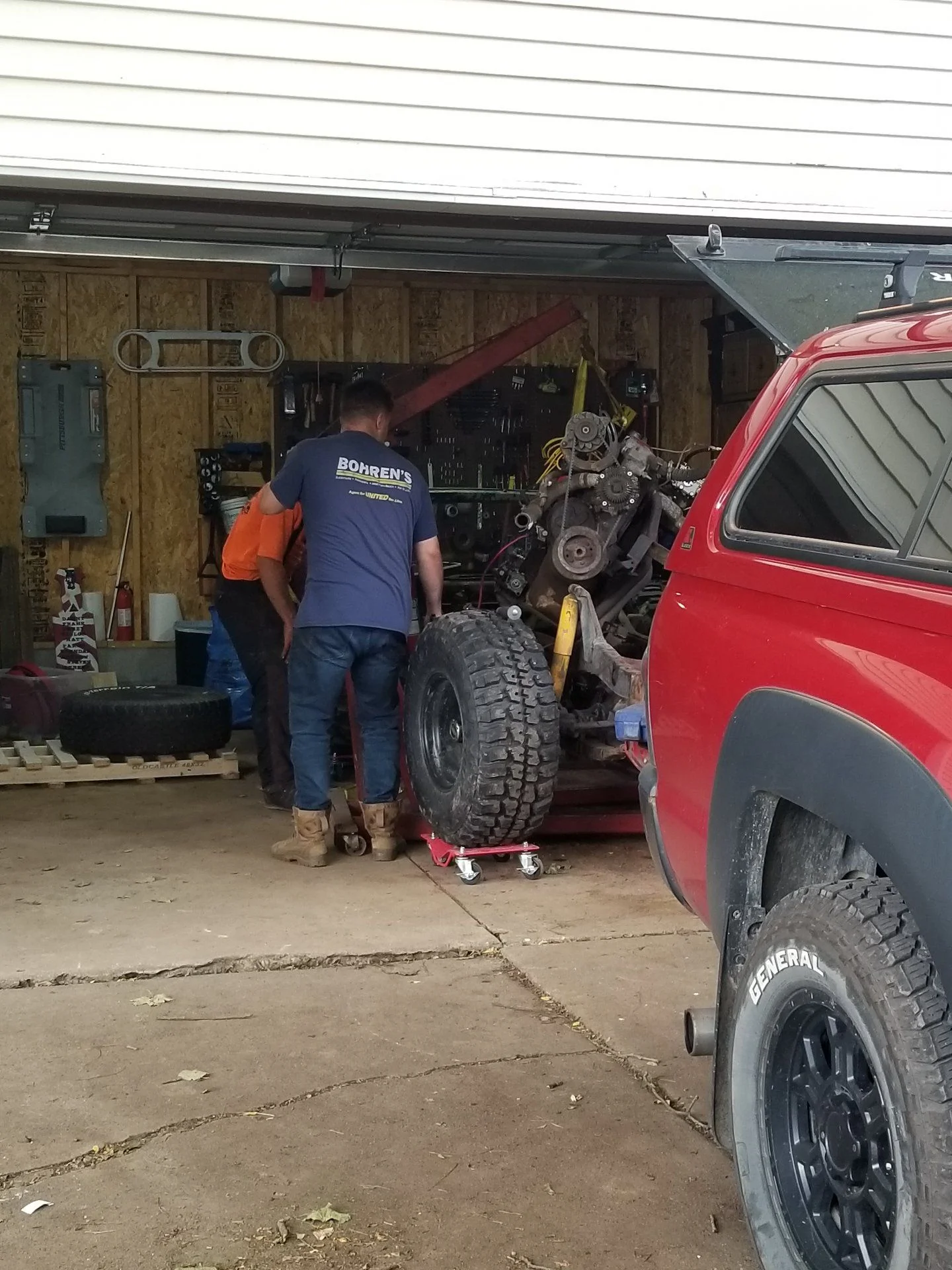

Engine/tranny/tcase are out. Had a buddy who with a hoist that swung by and got right to it. Whole thing took about 45 mins (plus all the time spent spraying the bolts with wd40 every time i walked in the garage).
Its sitting a bit more precariously than i would like but it is certainly secure.
Any recomendations for engine cradles for the 2f with tranny still attached?

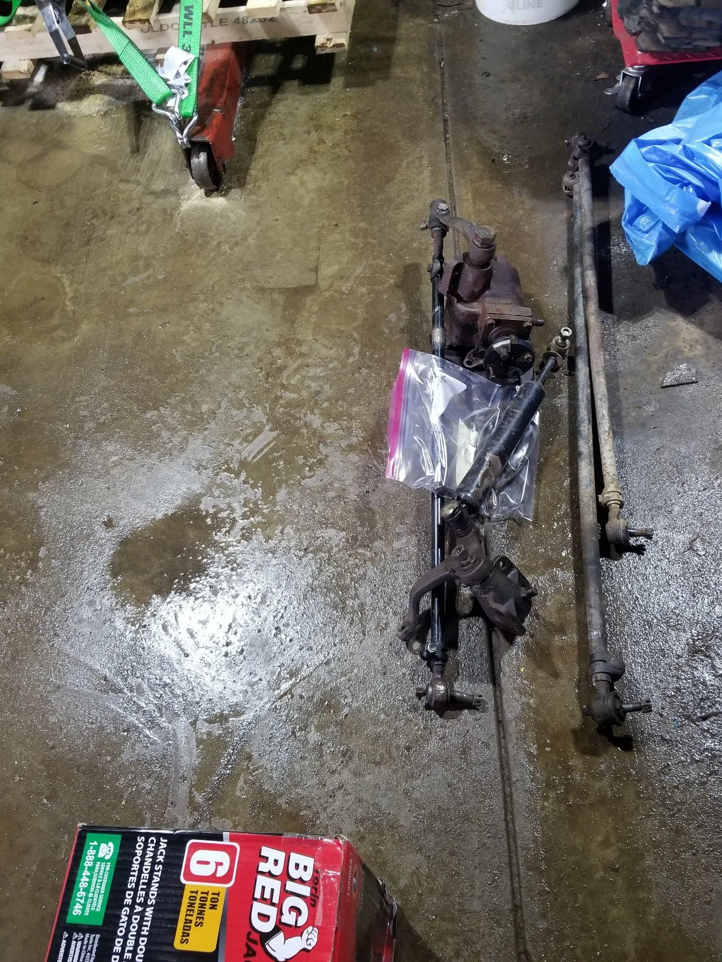

Steering components out. Came off easy with the help of my $20 Amazon pickle fork set.

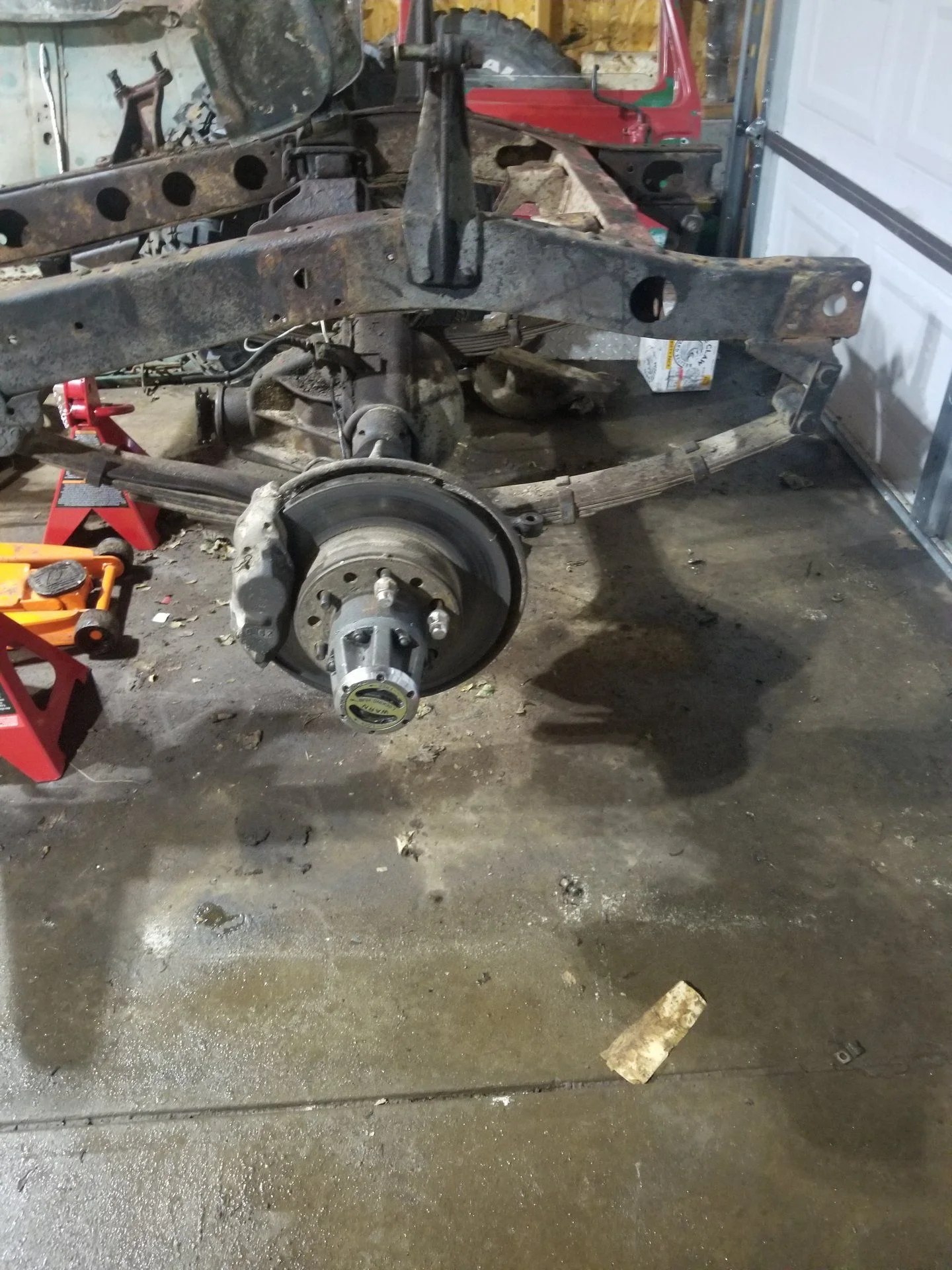

Wheels off and surprise! I have disc brakes in the front. Never thought to check. U bolts nuts are siezed but hit them with wd40 and will fight with them tomorow.

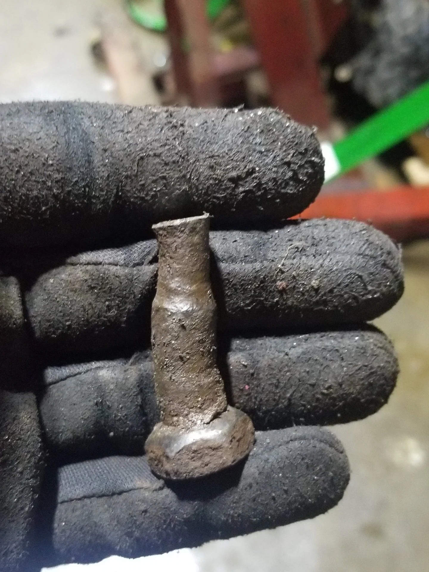

Side note - got a new ryobi wired sawzall and it has balls. With the help of Diablo metal cutting blades, it chopped off the bent engine mount bolts like butter. Way better than the battery powered one i had, and cheap too.
Should I be concerned about having bent engine mount bolts?

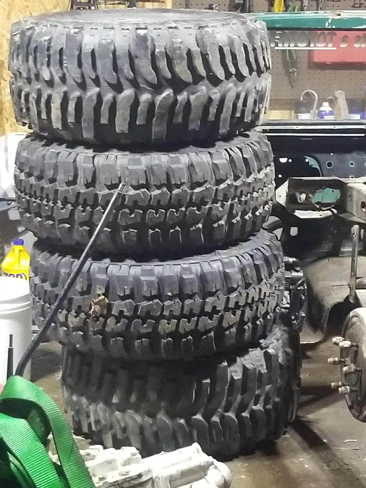

Frame went off to the welder today. He was a recommendation from a few people up here so I feel pretty good about it. Also was able to sell the old swampers and MT's to a kid who will get way better use out of them than I will. With the frame out of the garage I'll have some extra space to clean up the axles and other parts before it gets back.

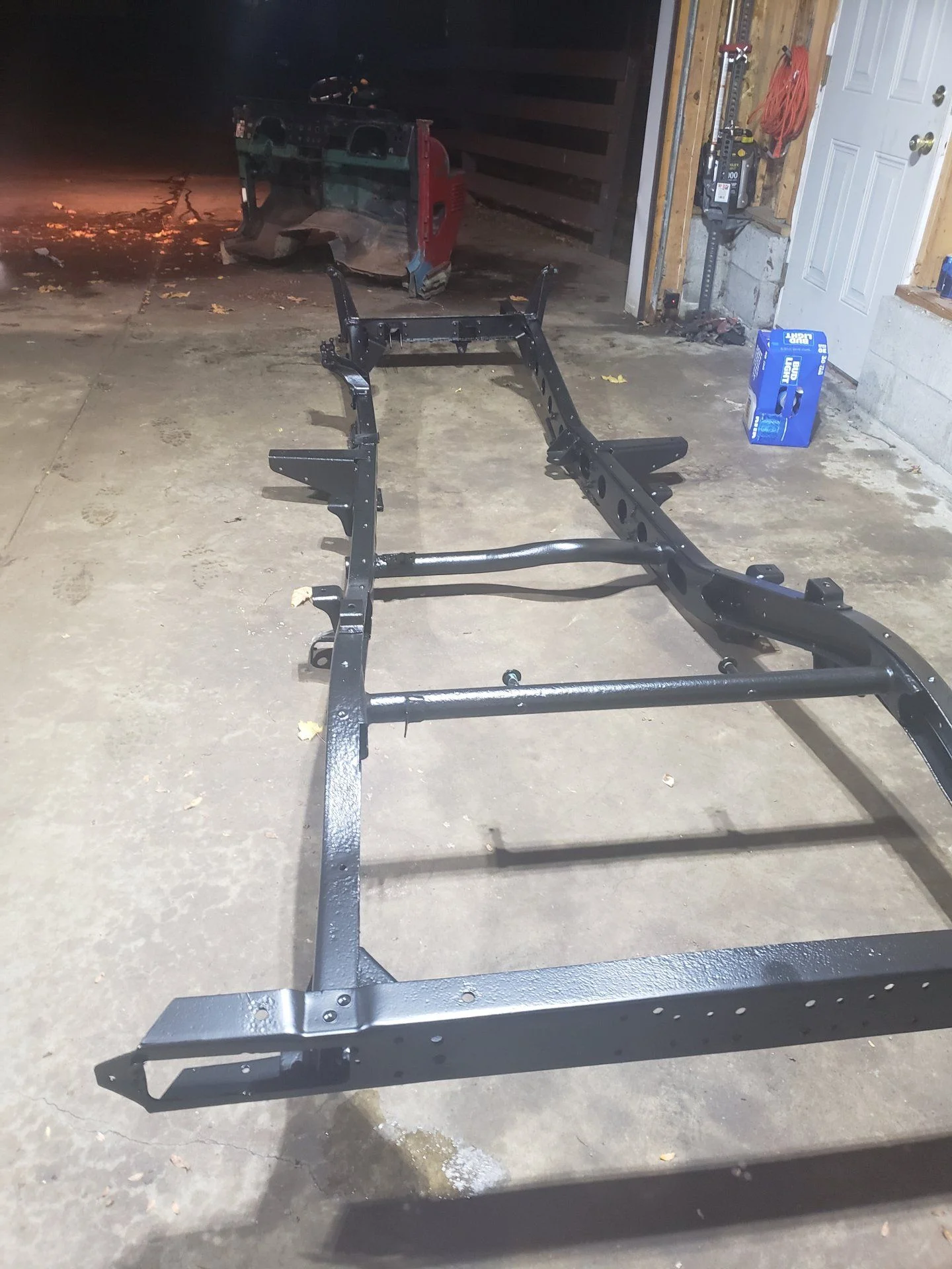

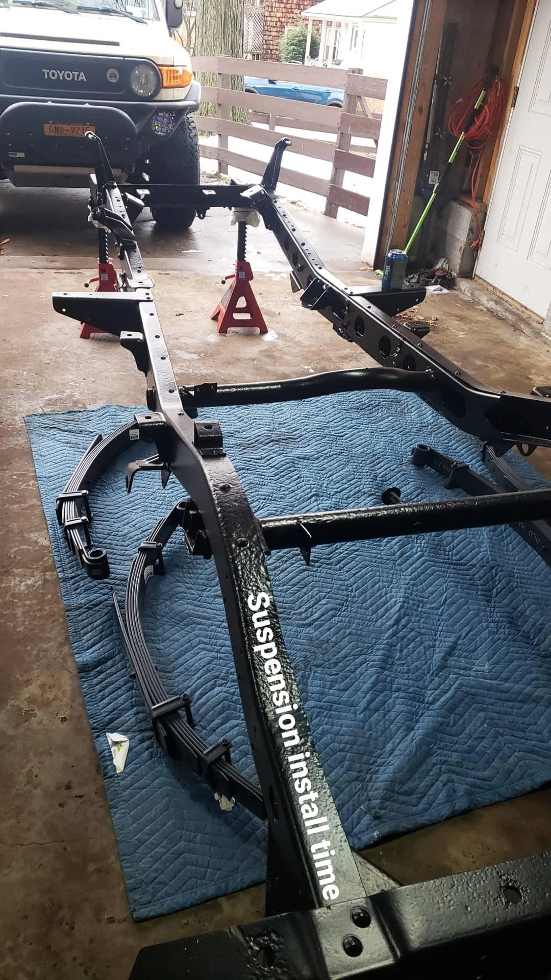

Frame has been welded, blasted and powdercoated. I got a bit ahead of myself with the PC timing and i still have some broken bolts to drill out. Going to have to be careful to not mess up the powdercoating but that's what I get, I guess. **the frame is now on jack stands, just needed to make some space on the other side of the garage.
Took the engine mount brackets off and wire brushed, wheeled, degreased, wire brushed some more. Hit the flat areas with a grinder then painted with high temp primer and paint.
Will be cleaning up the axles and looking for wheels and tires this week. Not sure if i want to splurge on new tires or try and find some used ones for the rig to sit on for the rest of the build up.

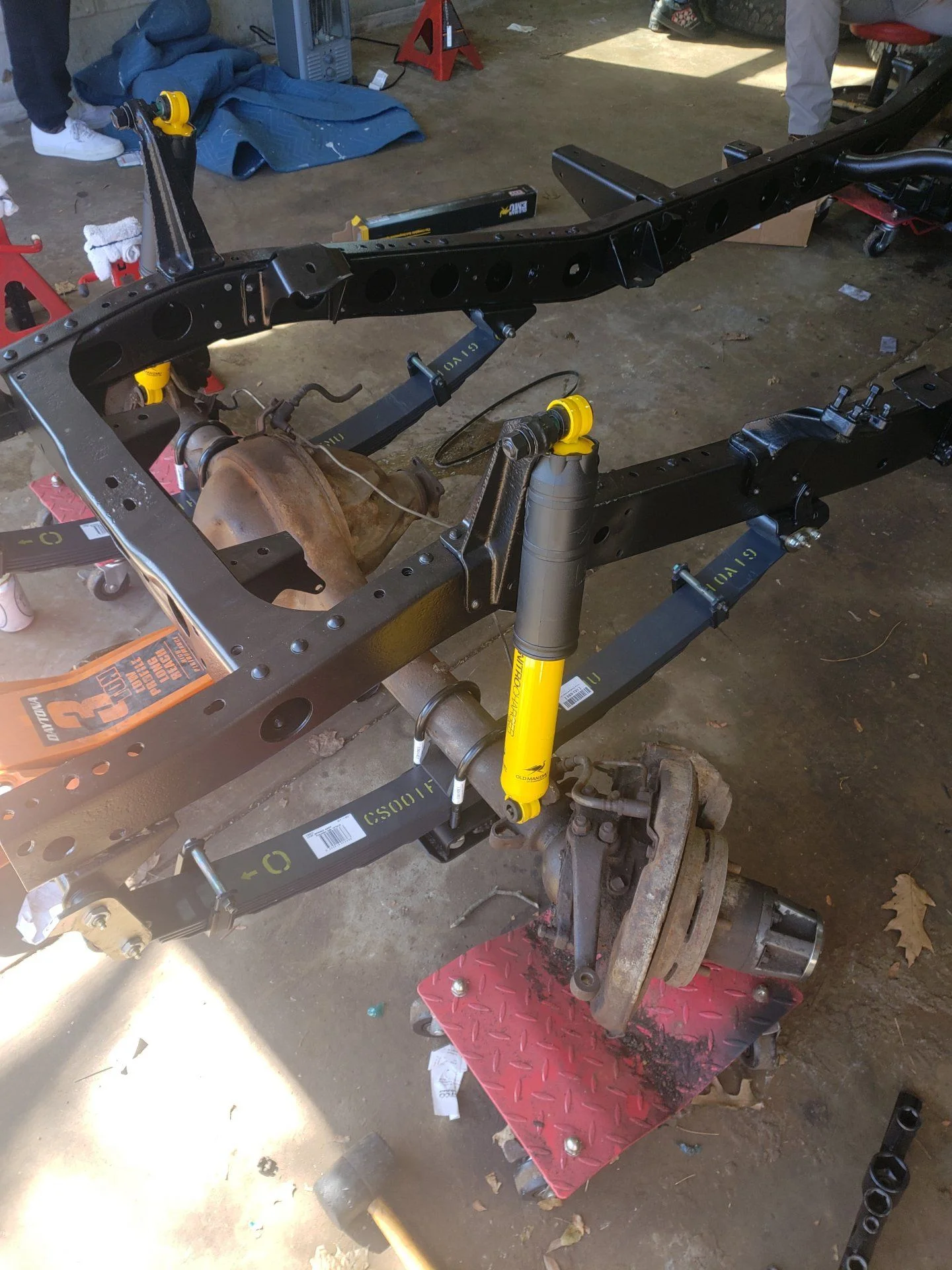

Had to wait a painfully long time for spring plates after waiting a painfully long time for suspension and finally had the time to get the plates mounted this weekend.
The front shocks seem to be sitting kinda cockeyed putting stress on the bushings. I followed the directions (i think) but it looks like the axle is sitting really far forward. The shock mount is hitting the plastic of the shock. Maybe thats what its there for?
When i put the wheels on and engine in, will the weight force the frame down thus axle back or did i do it wrong?
Sorry if this has been asked before. I did some looking but all the videos/threads that i found had body or engine already on so it doesnt directly correlate.
