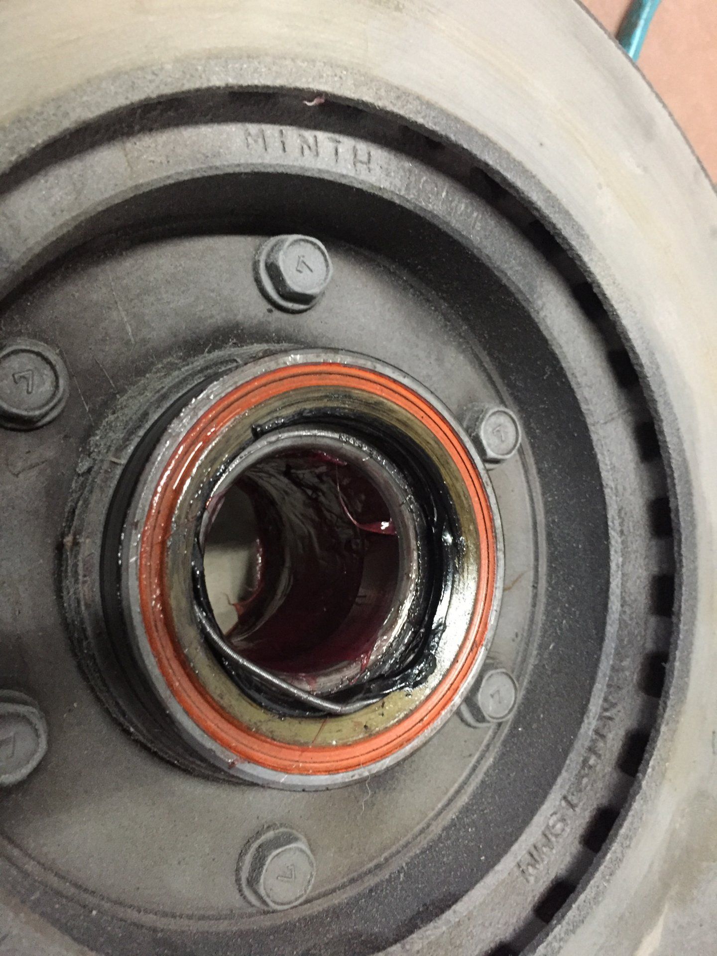

On the appointed day I went back to the ranch and started the axle tear down. As soon as I opened up the locking hubs, it was obvious someone had been in the axle before. But why the duddy loose wheel bearings?
I kept going anyways. Once I had the left rotor off, I was appalled to discover the wheel bearing seal was mutilated. Installer error. Not like I’ve never damaged one before. But this one was really fubar, and unlike me, who can just go to the shelf and get another one, whoever did this had no spare, so they just put it together anyways!:bang:

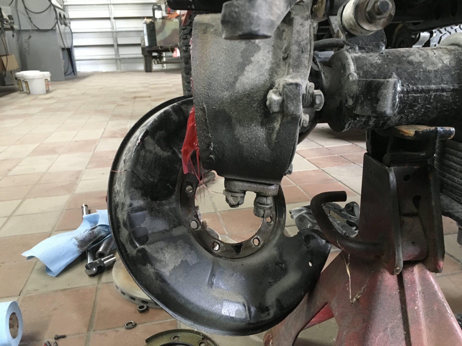

And I really freaked out when I hit the passenger knuckle arm to unseat it...and a cone fell on the floor! :eek:
I bent down for a look and discovered that indeed one of the lower knuckle nuts was gone!
And a second one was going!
That just goes to show that even with abuse an FJ40 just keeps on going and going...

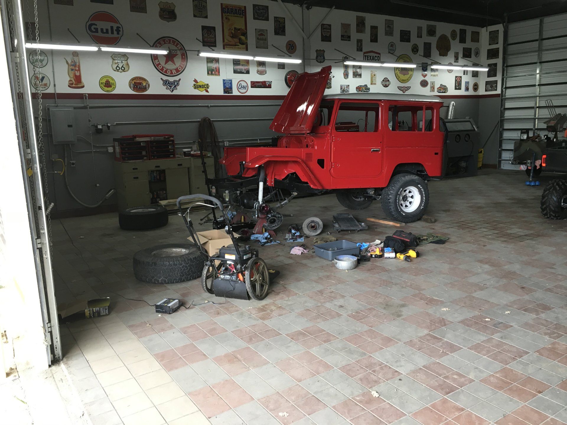

FYI looks like that mower could use a wheel alignment while your in there!
It is an interesting weedwhacker for sure. Actually designed that way. He’s got at least six acres in the immediate vicinity that are too difficult to handle with a riding mower.

So the same wrench that thought evenly distributing the knuckle shims was a better idea than measuring preload also apparently had VERY limited experience installing wheel seals. And also didn’t like admitting they made a mistake.
So they just reinstalled the rotor on the truck as is!

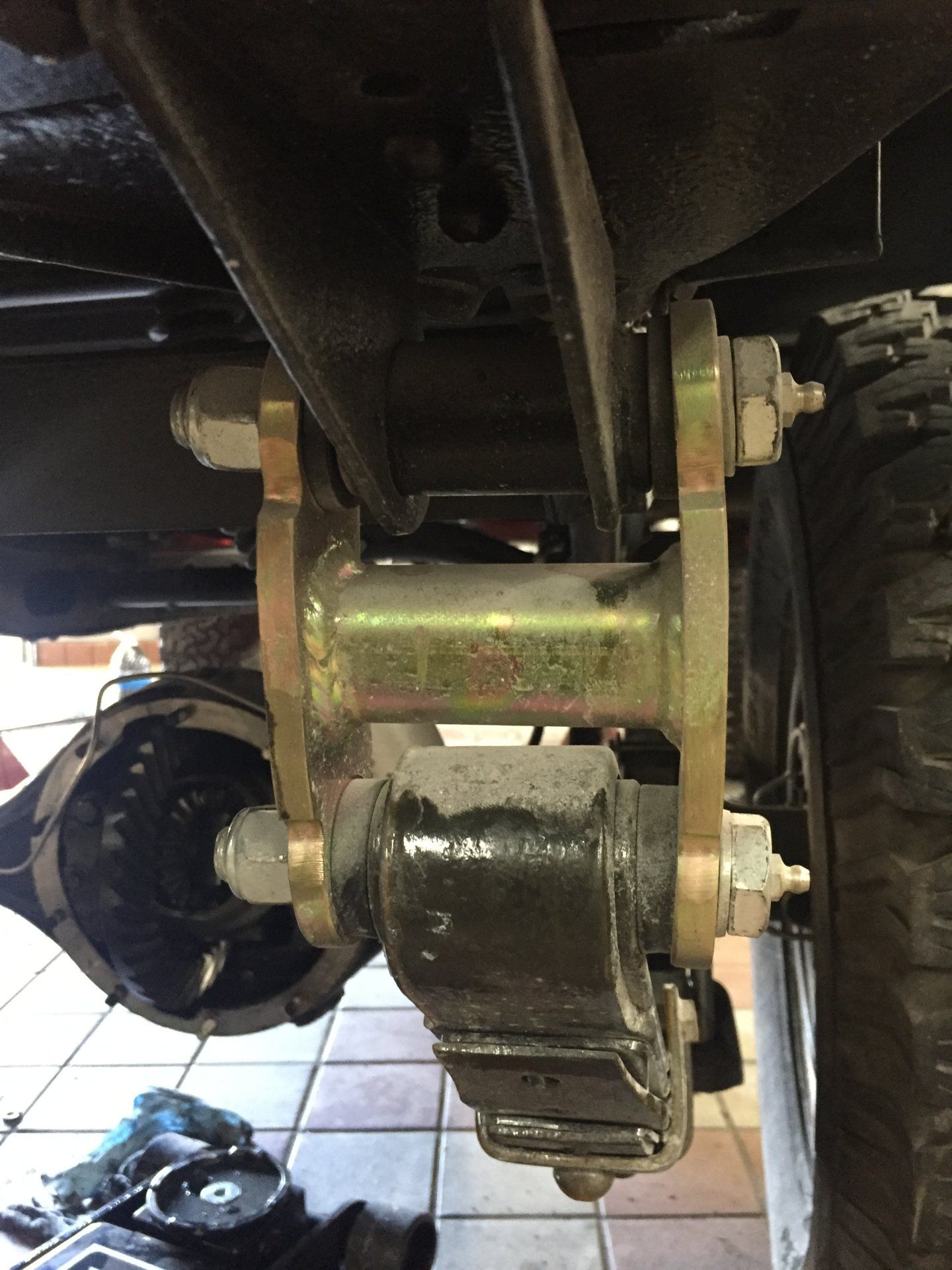

Not surprised to see another case of bowed barbell shackles. I of course brought along some of my dandy Mark’s Off Road Double Duty adjustable-gusset shackles to replace them with. ;)
Before:
After:
Note I took advantage of the accessability of the situation and also added a set of Mark’s Off Road Ubolt skidplates. ;)
