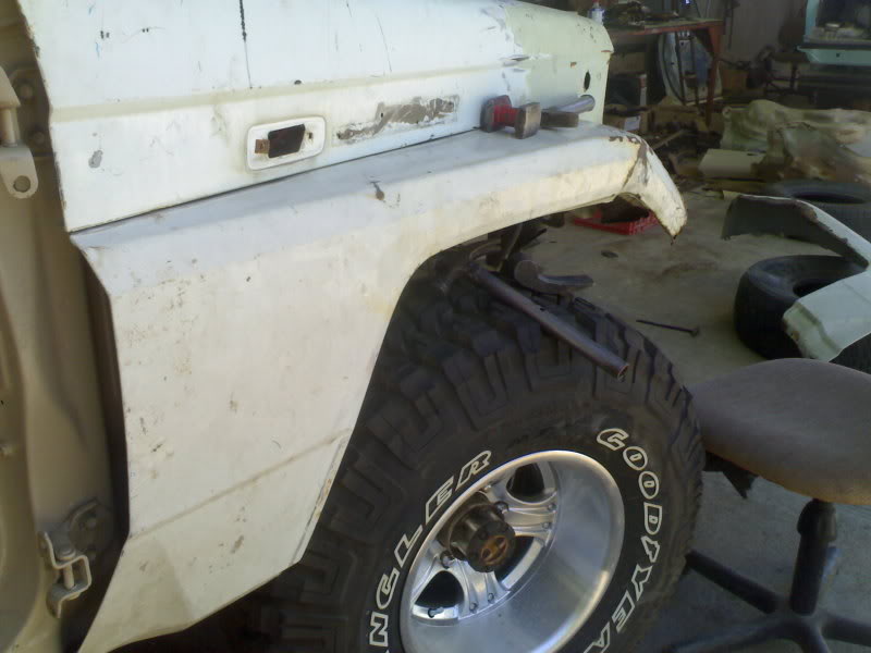

Things got out of hand!
I decided to stay with my first option,cut the body!
Not wanting to trash my new fenders,I took two partialy repaired fenders from a previous project,and started cutting!!!
It came out Ok,now I only need to modify inner fenders to fit.Then some bode prep work and paint.I think it will look fine with the new "wide body " look!

Keep up the good work brayn i like the way you fabricated the front and rear guards would have never thought of that and those wheels look good too Good old wranglers tuff tyre...:)
Looking forward to seeing the end result top jod mate...
