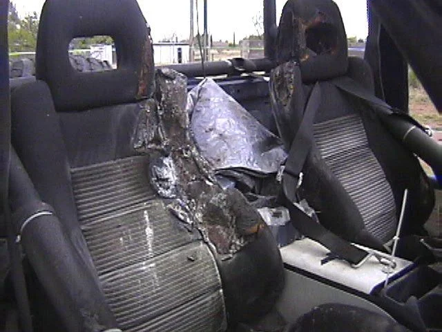

no laughing , here is mine with e D60 /D70 combo . no pics of the interior yet cause I am lazy Alaskan Super FJ60
Let me guess.... CRX seats? I had a set that I gave to a freind of mine for his '85 pickup. He called me the other day wanting to know if i wanted them back. I was all excited till I saw 'em....
yep
looks really familular , aside from the scorch marks
