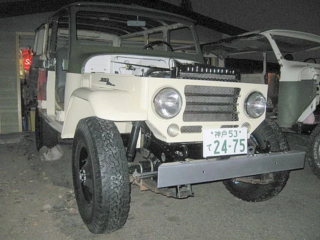

Hope you all has a blast at the 45Run. I spent some good time this weekend working on the LV. I've got the driverside fender and hood to paint and the front end is finished. Here's some crappy night pics. Sorry, but I just got in from working on it. I'll post some better quality pics tomorrow.
Thanks Kellyo. The bottom paint is Rustoleum almond and the green is a custom color I had mixed. Both are the 7-9 hour dry. They go on a lot smoother than the 15 minute dry.
The license plate is an original from Japan. Steve kopito gave it to me when I bought my first LV from him.

Kinda neat how you reversed the paint scheme from the old one to the new one.
I just figured since I'm going FJ35, I might as well go all out for the authentic paint scheme too.

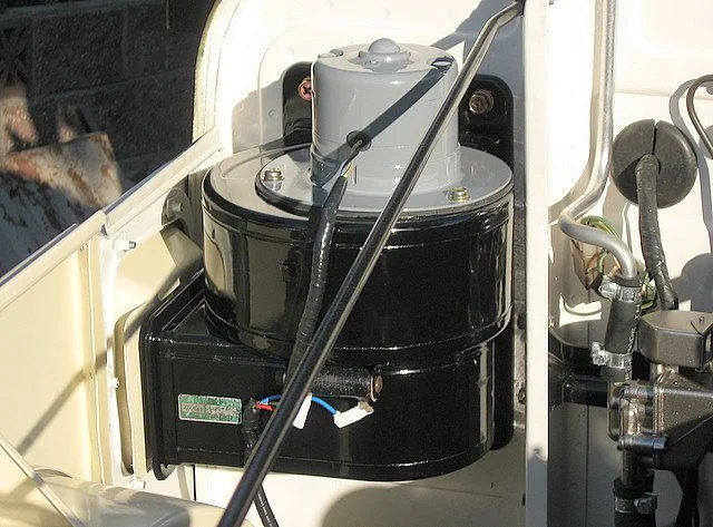

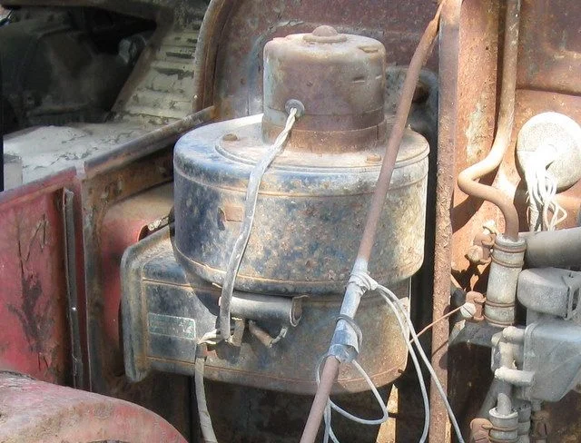

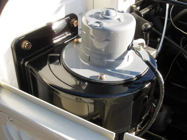

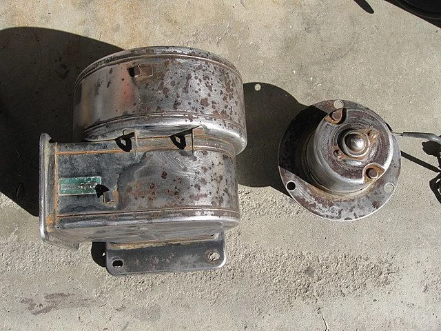

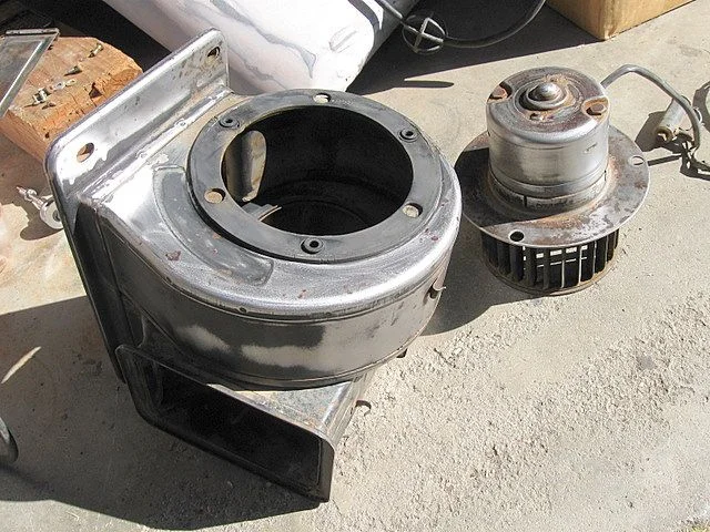

Tomorrow I paint the blower unit black, and then prime and get the first coat of Almond on the driver fender. I pulled the blower unit apart last night and 220 sanded all of the rust off of it. Found more mud-wasp nests inside it. It should look new when I'm done.
Hey what piece am I missing between the blower unit intake and the vent screen on the body?
