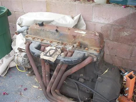

I will pull apaty a parts motor I have and bring the Bellhousing bots

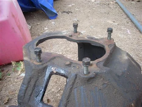

Rob, we don't need the 6 bolts behind the flywheel that hold the bellhousing to the block. We need the 4 bolts that hold the TRANSMISSION [4 speed} to the bellhousing. Those should be easy to get to....if you have them.
I will bring my Landcruiser bolts and nuts selection.
I don't know if I have any of those 12mmx1.25 the correct length.
We went thru the whole list and came up with two items still needed.
One set of manifold nuts and washers [12mmx1.25]that somehow disappeared since we took the engine apart, and...............
One set of 4 bolts to hold a 4 speed transmission to the belllhousing. This is one thing I am sure I am dead out of. I had to scrounge for the last 4 bolts to do FJ45dude's trans conversion.
DOES ANYONE HAVE SOME EXTRAS OF THESE BOLTS THAT IS COMING?
Nuts an Bolts
Here I will bring these and anything else off this motor you want
I just when in the garage to check a bucket of motor mounts hoping I might have throw the bolts in there from one I pulled apart in the mid nineties. before I even started I noticed in my pile of bell housings that one of the four speed bell housings had the bolts in it. So I have a set of transmission bolts I will bring.
John
Edit I guess Rob and I must think a like. The best best to keep them from getting lost was to keep them in the bell housing. I bring my along two.
