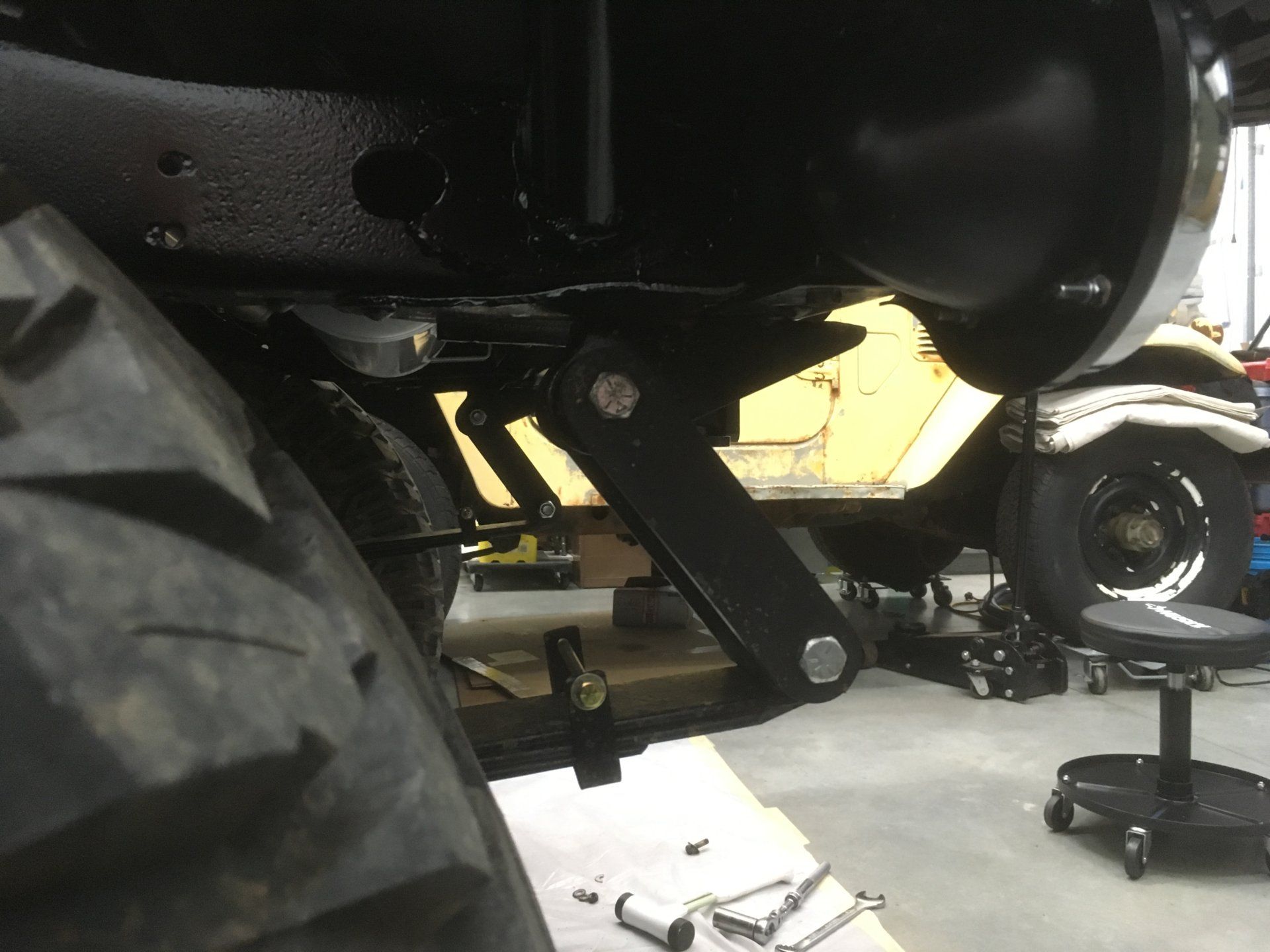

Moved to new / potentially permanent location. This is ~1.5" farther back and is ~65* angle (shackle and spring).
What's the consensus? Leave here or move in ~.5" (which would be ~1" farther back from original)?

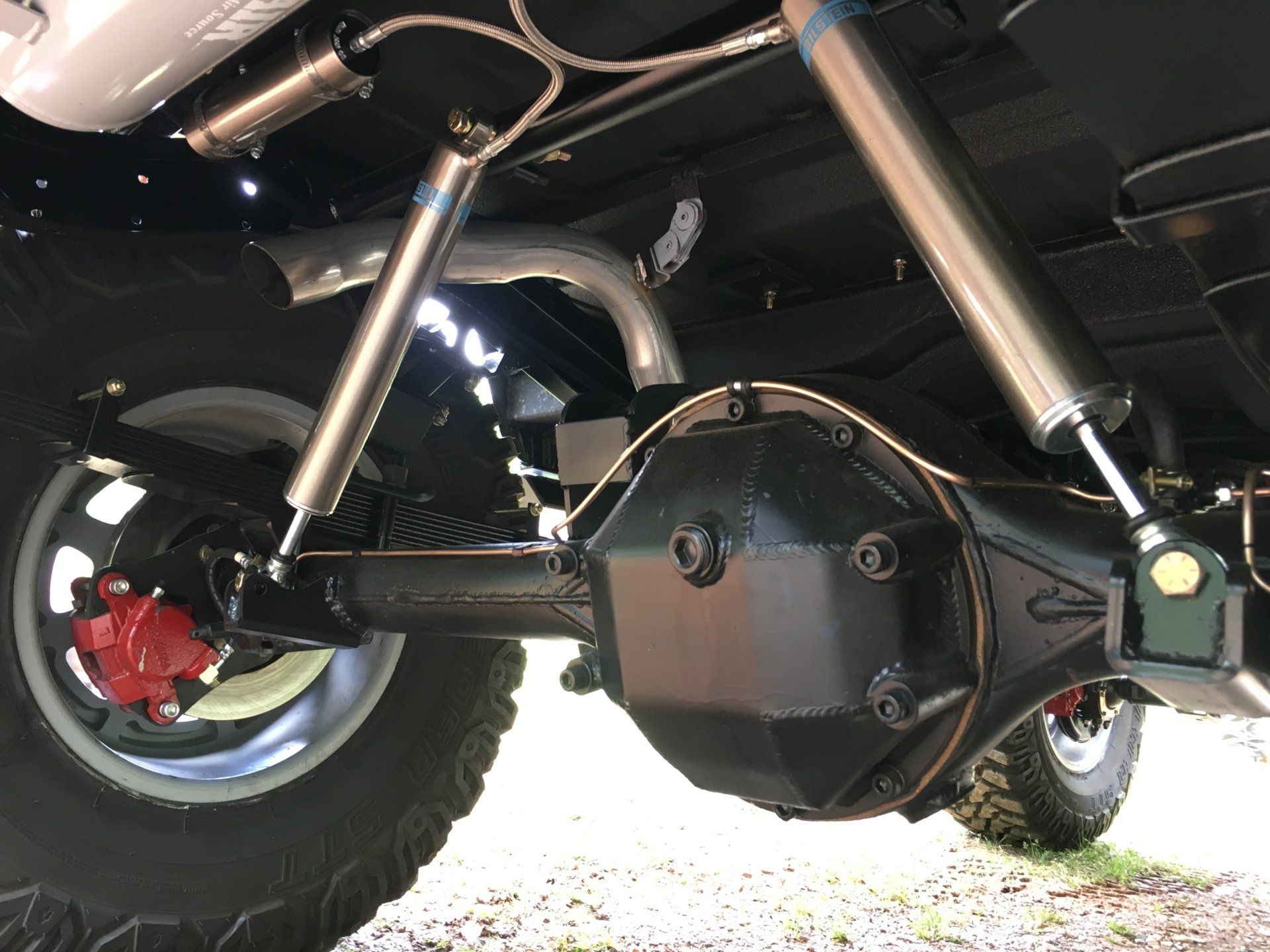

Here is mine, that I am very happy with, for reference. Note, there is some weight in the back on this trip:
