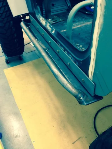

If you're going with sliders, what's with the angle that's against the bottom of the tub? I'd get rid of the angle and get those sliders a little higher and tighter.
Angle is there cause the bottom rockers were fxxxed and filled with bondo by a PO. Easier and quicker to cover with angle than cutout and redo the rockers. They've already been cut a few inches higher then normal.
Sliders are 3/8" from bottom of the angle...you think closer to 1/8" or 1/4"?
Also I flipped the sides so the larger swoop of the tube is front vs rear...no pic but looks better following the line of the front fender.
Nah, you'll need the room for flex in the slider.
If the angle stays then it looks awesome! I'd put it right there :D
