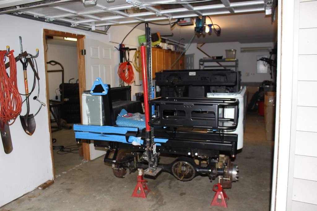

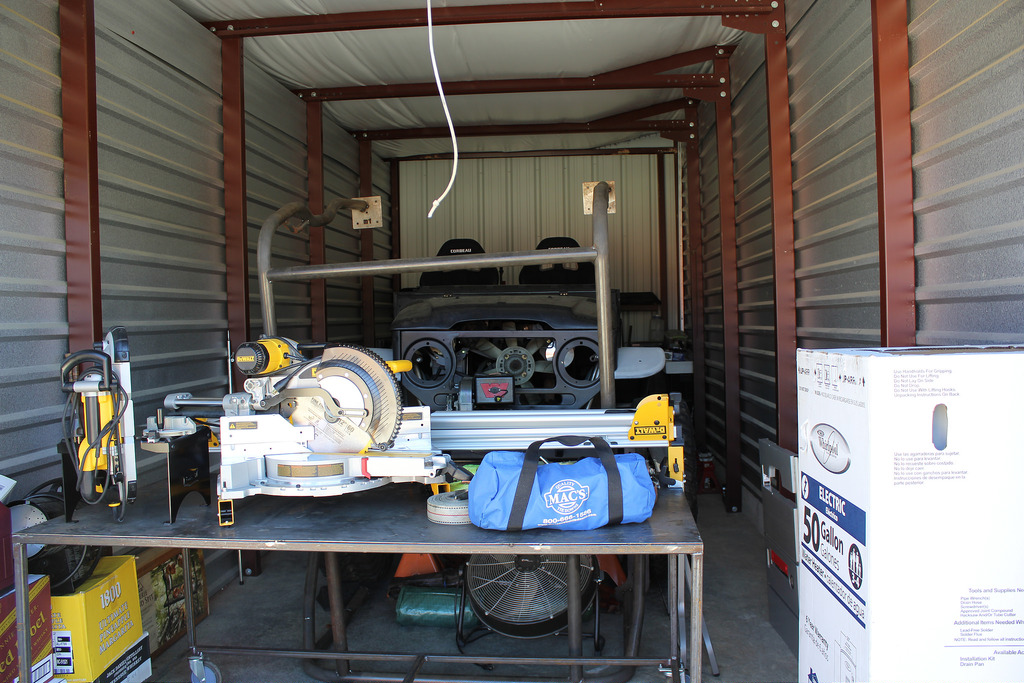

Jon, looking good man. The cross bar for the harnesses is too low though. The conncetion for the shoulder restraints can't be more than 45* from horizontal.
• It is strongly recommended that the shoulder harnesses be fitted as close to horizontal as possible. It is
a must that the angle of the shoulder harness does not exceed 45 degrees in relation to the theoretical horizontal axis of the mounting points. Never anchor straight down behind the back. (See diagram for recommended anchorage points)
Just looking out for your safety - not trying to be critical!
R
Yeah I read that. It's only a shy more than 45 so I'm not gonna sweat it.
I am with Ramon on this one. I would move the belt bar up. You can cause yourself some damage with the harness in that position.

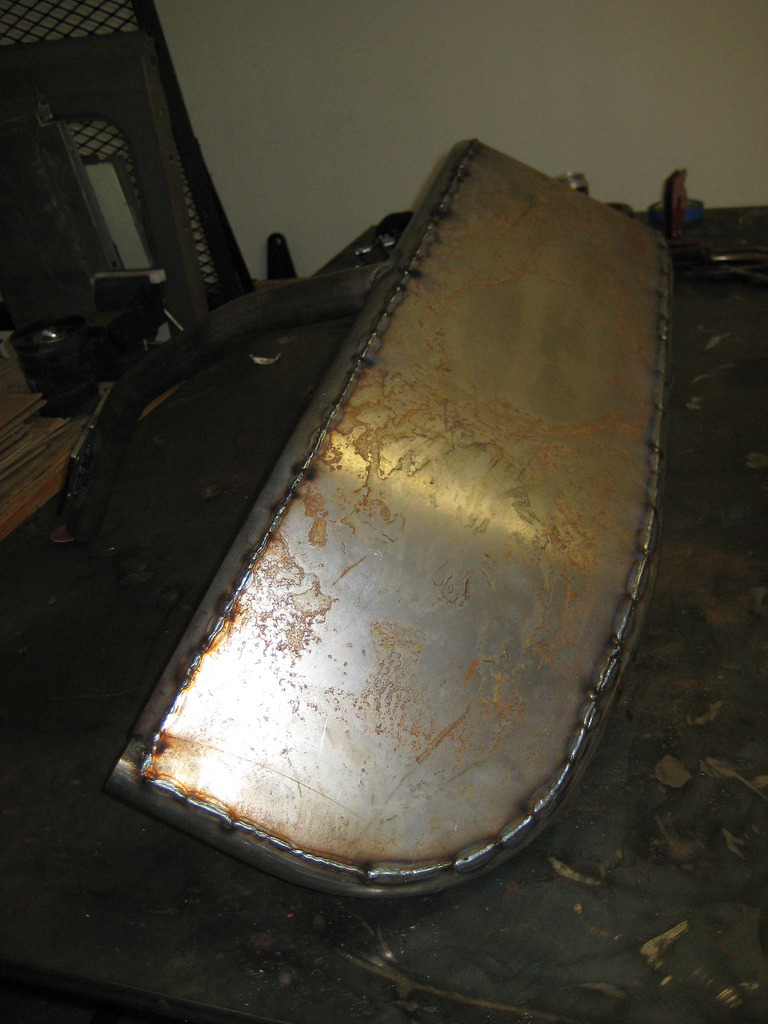

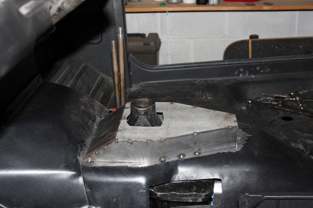

Sweet. Why not taper that tranny tunnel addition in the rear like you did in the front? Good looking metal work there boss!
R

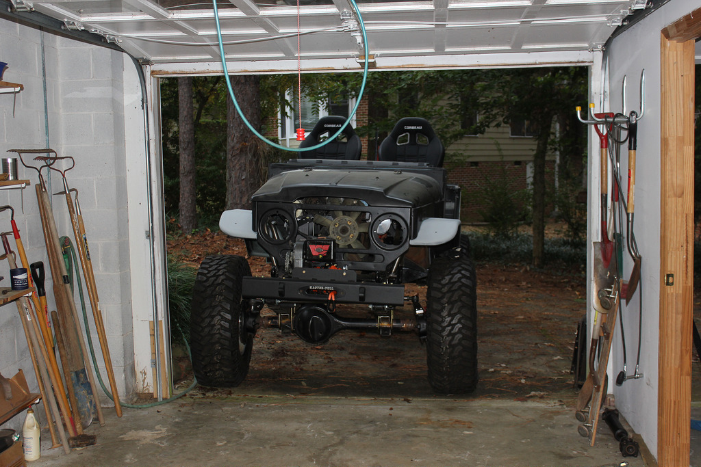

This thing is going to be bigger than I expected.
Getting closer!

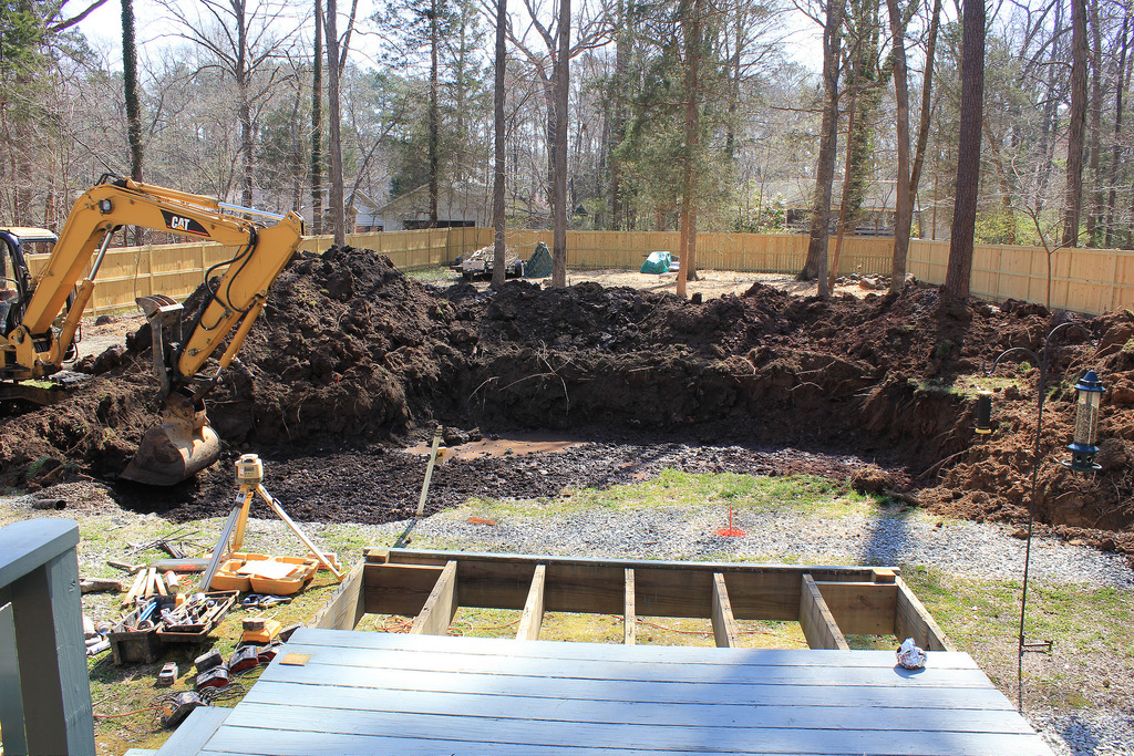

How big is this new garage?
The garage or the cruiser.....or both?
looking good there. i forsee a big push after the move and settling is done. Im sure your ready for a little seat time in a cruiser again.
