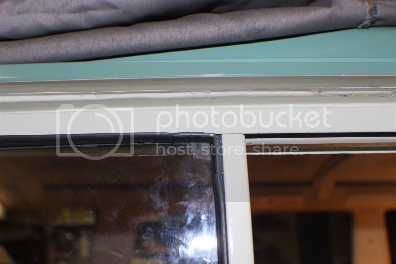

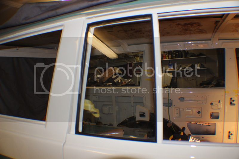

Fitting the rear door fixed window rubber was more challenging than expected. The fit of the new rubber leaves a lot to be desired, but as the choice is this or nothing...I'll take it!
This is the worst fit...top rear corner

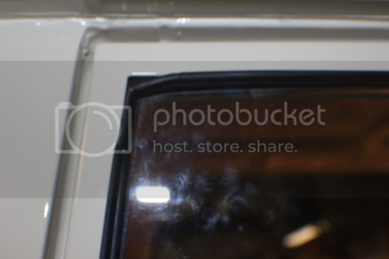

Looks like they tried to notch the rubber to clear the upper bracket here, but not nearly enough, and causes the bulge top front

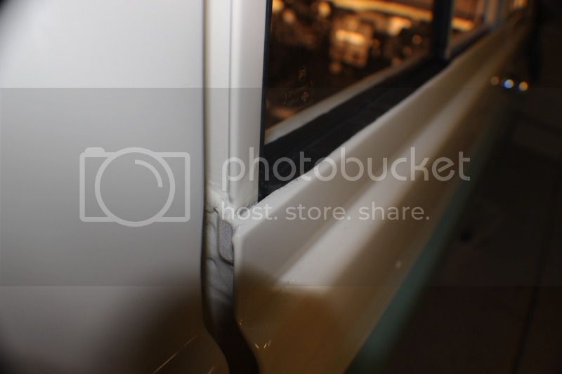

And where lower rear corner just does not quite seal.

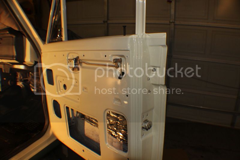

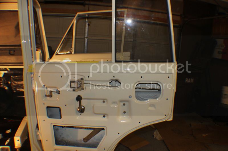

Started assembly on the passenger doors....I have two of everything, thanks to the Frankencruiser....but have to go scavenger hunt for front passenger window regulator and rear passenger door latch. I have 5 rear door regulators, but only one front regulator...I have to be missing a bag somewhere.
Front Passenger door does latch and open from inside and outside....glad I took so many pictures of the doors on disassembly!
