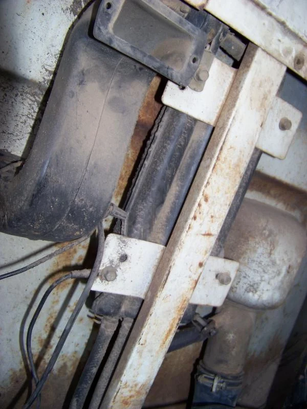

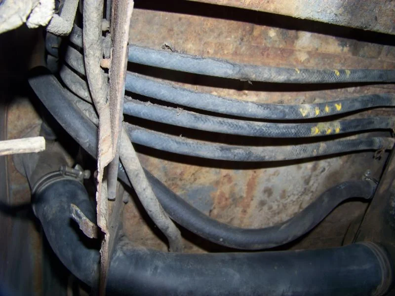

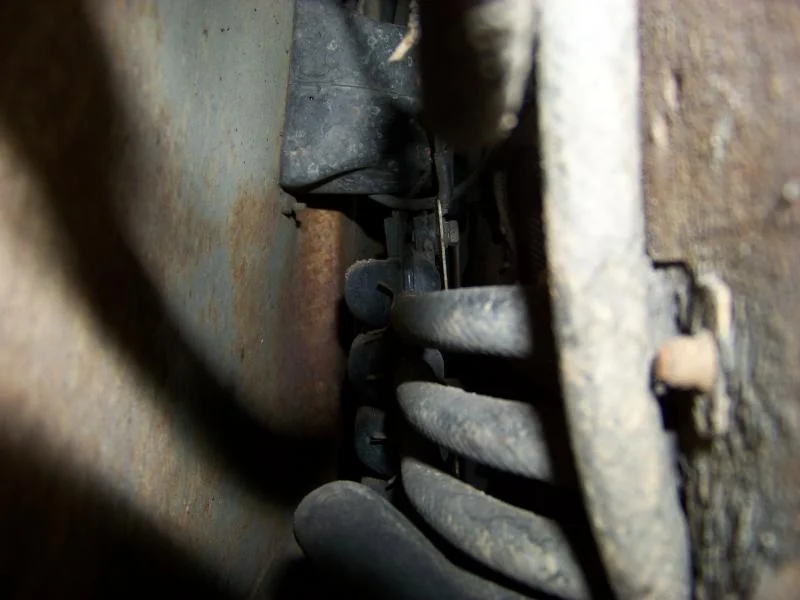

Funnily enough, I'm gonna be trying again to switch gas tanks in my '74 sometime this week...I'll be sure to take some pics. Looks like those 4 smaller hoses go straight up to the vapor separator in pretty much the same order that they come off the tank.
sometimes 3 pics is worth a word...gastank hoses? mines easy to see.
Thanks guys, that almost seems too easy...I will probably get the fuel pickup/return ones backwards somehow...
