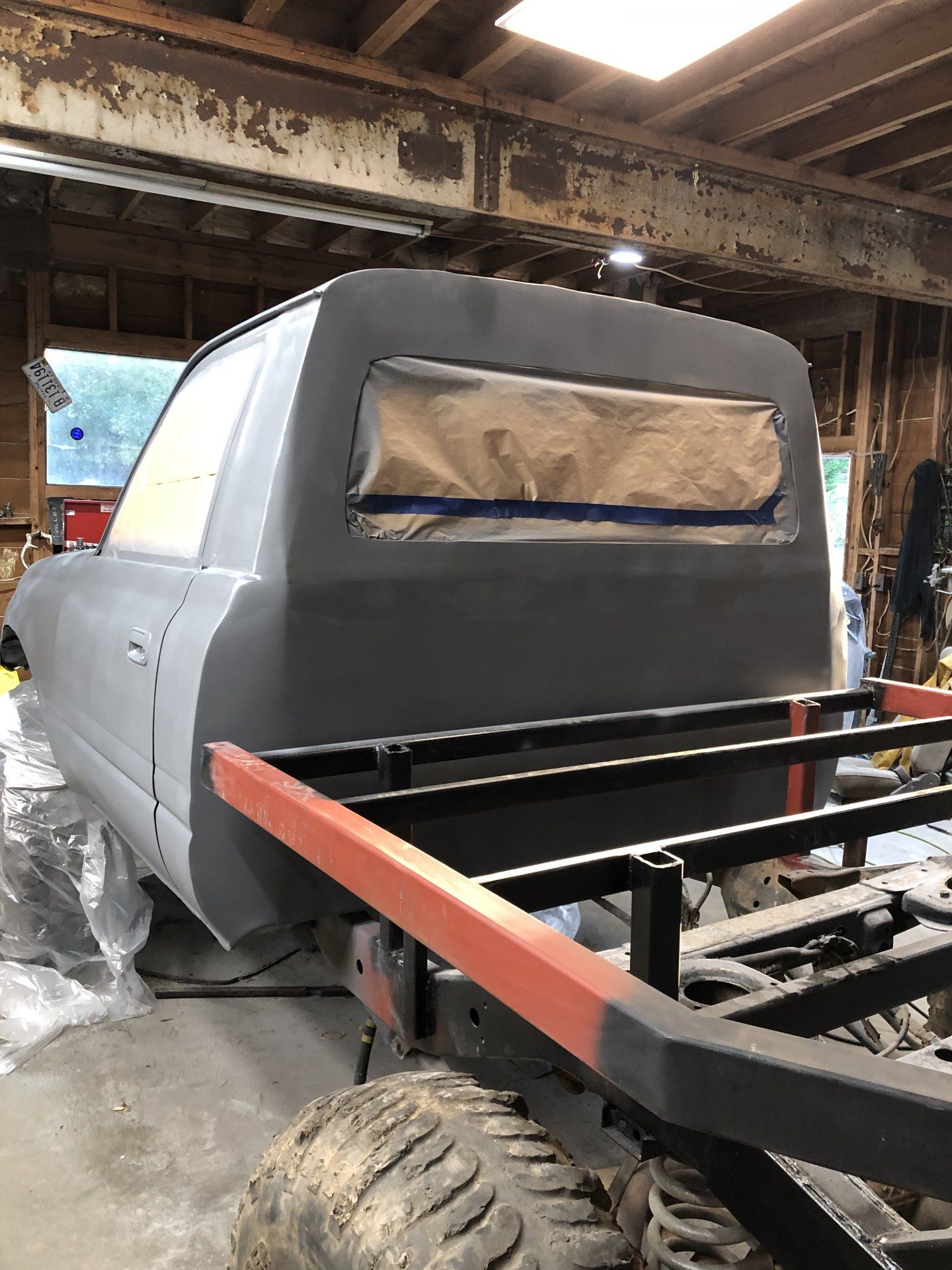

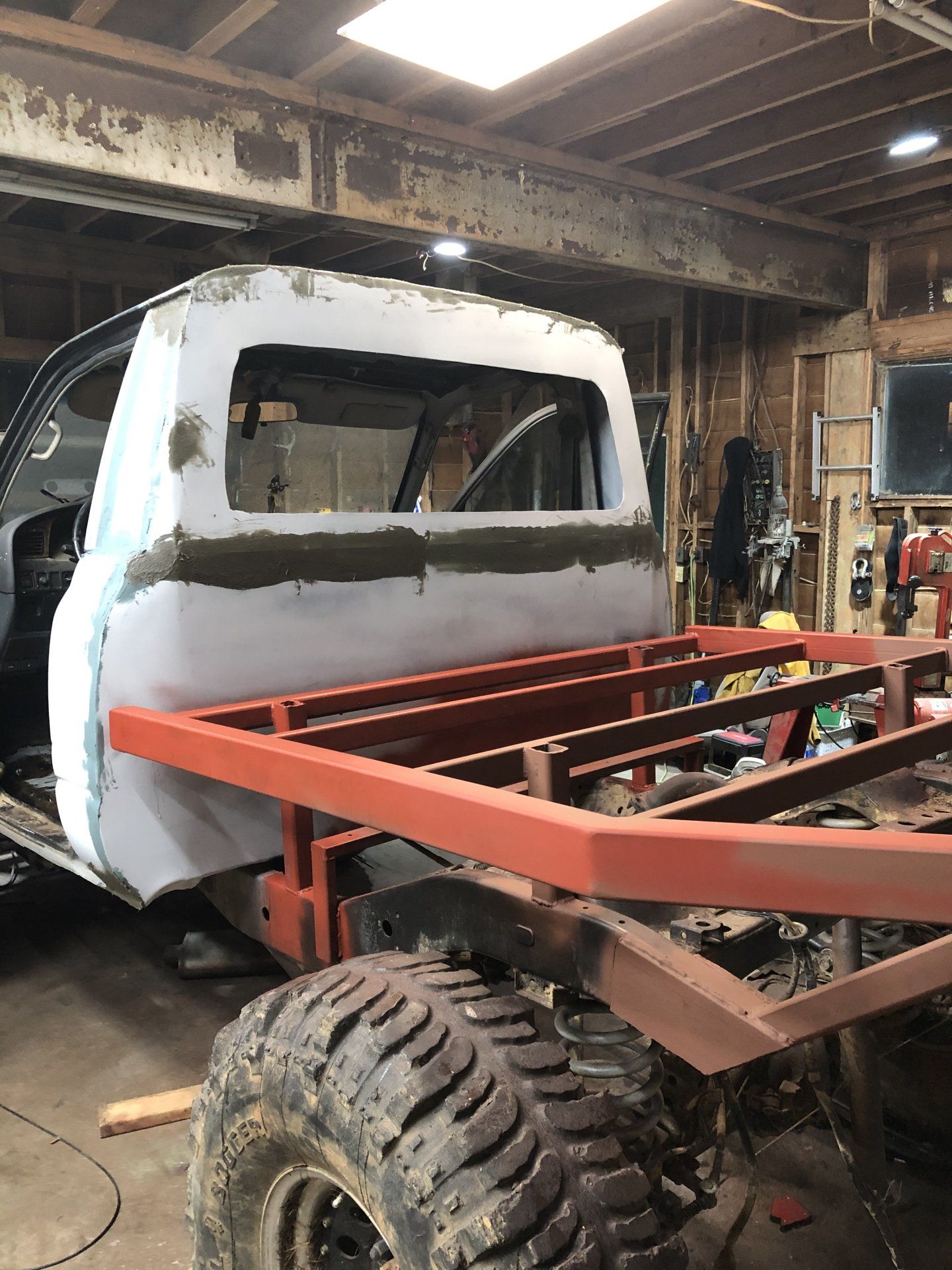

So far, one thing I would change is the length of the cab. I would make it 3-4” longer, mostly for ease of mounting the fuel tank. I haven’t bolted the seats in yet, so we’ll see pretty shortly how it is for leg room. I’m pretty sure that the current configuration of the the rear wall won’t interfere with the seats.

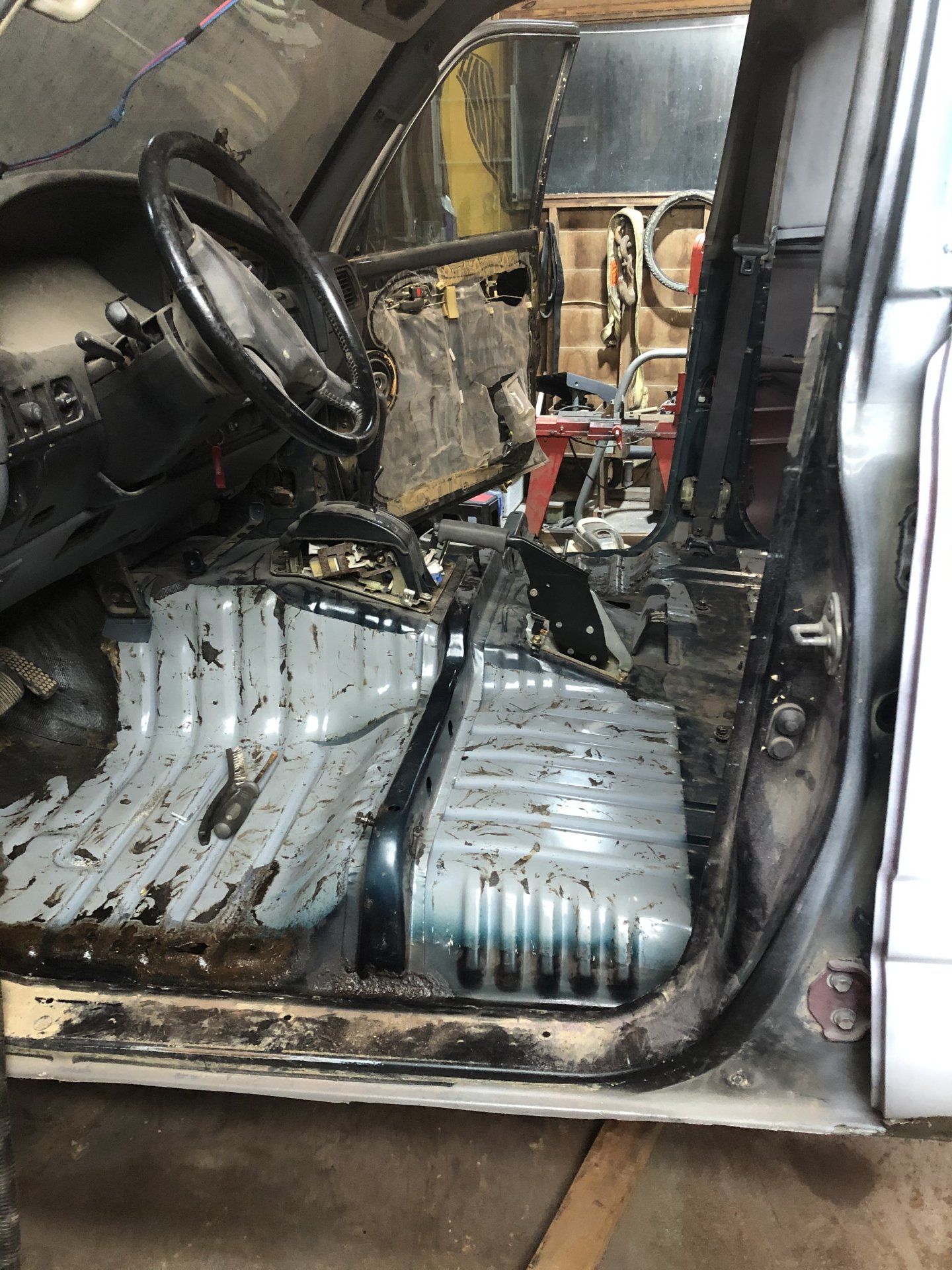

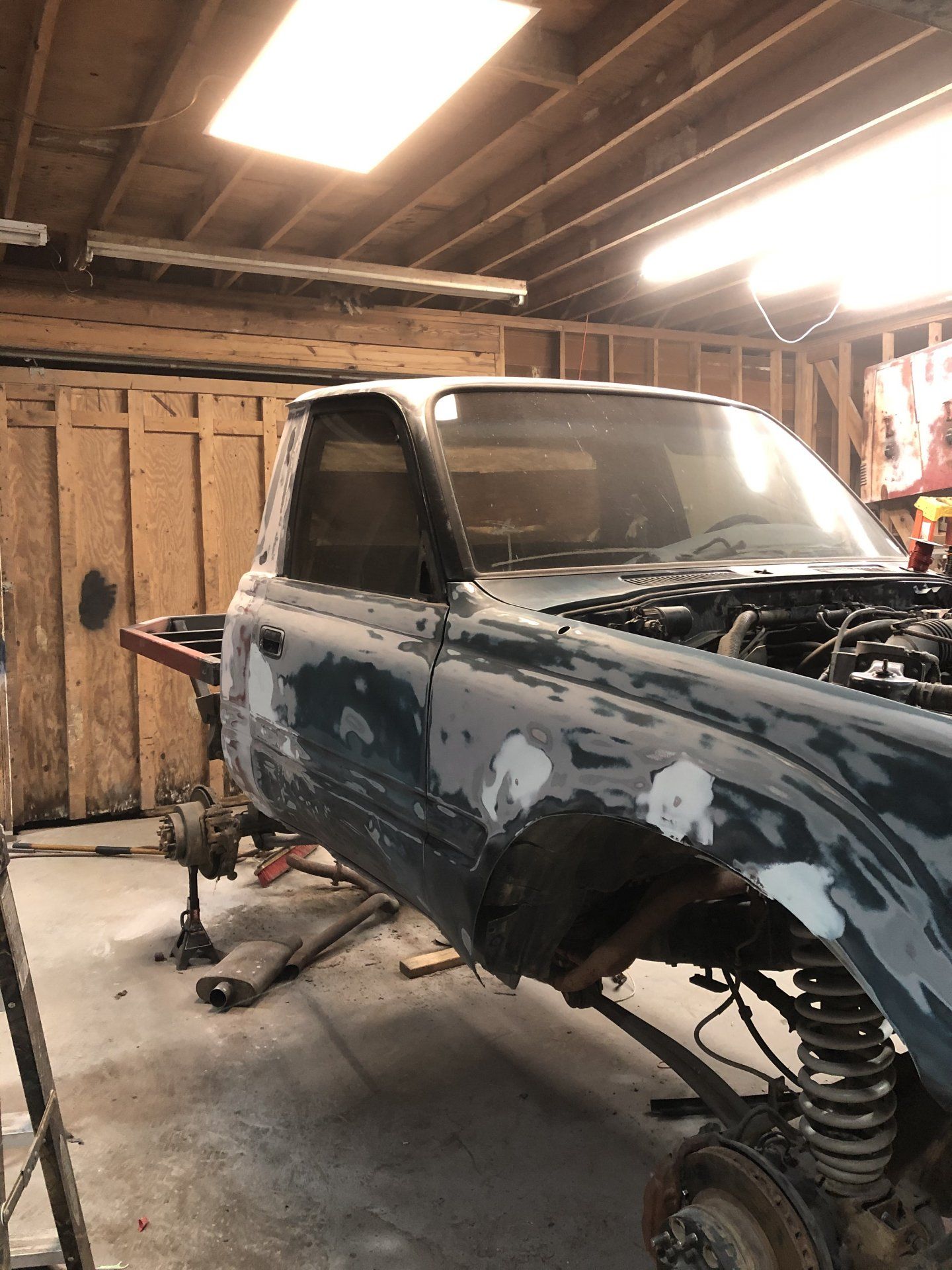

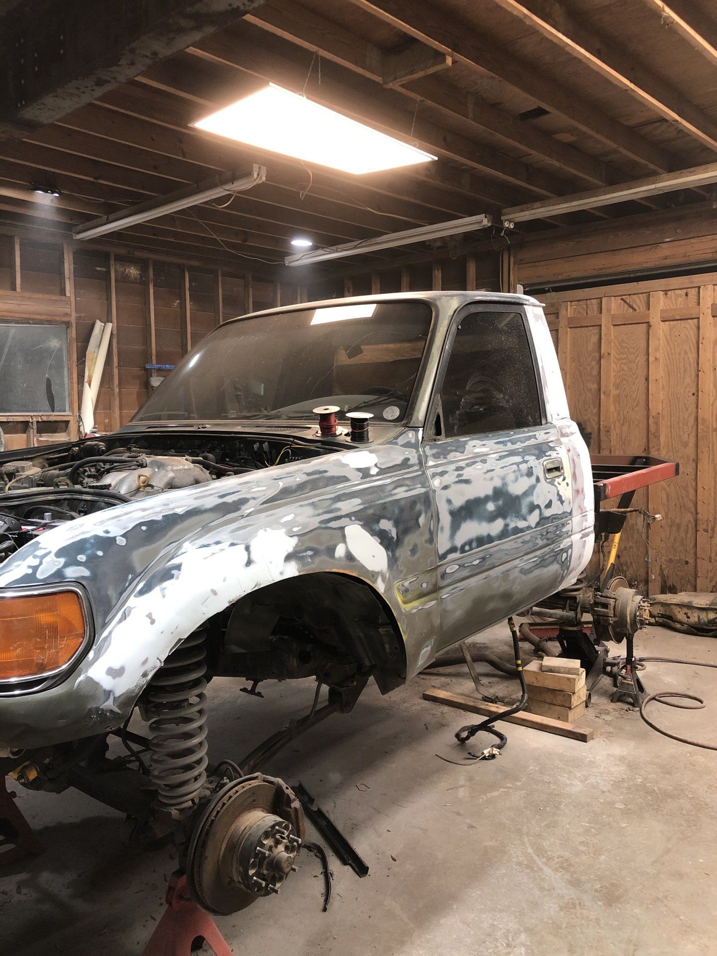

Stripped the interior, and coated with two coats of Lizard Skin. First coat was sound deadening, which I sprayed on 2 days ago, second is ceramic heat insulation. Once this dries, it will get painted and covered with Kilmat. I also started sanding on some of the body filler last night, but don’t have any pictures of that.

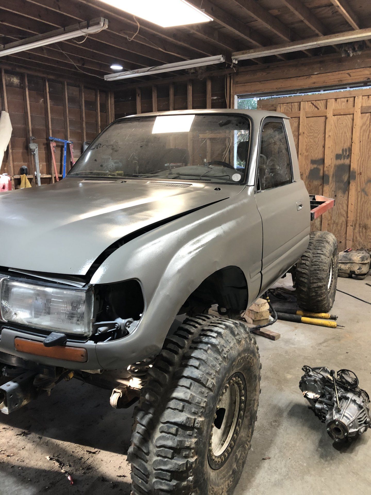

If your going to primer it. You might as well also shoot it with a color. You can always go back and do more body work if you want after GSMTR
It’s definitely going to be short on body work, but it’ll be good enough to wheel. I have paint to go over the primer, Massey Ferguson gray :)
Also today got the 38.5 s onto bead locks, thanks again to @raanderson77
I love. Massey Ferguson gray. Way better than leaving it primed.
Me too, we have some of that color on our tractor :) Are you talking the darker gray of the axles and engine or the lighter gray of the wheels?

I think it’s the darker gray judging by the little color block on the can. It says M.F. Gray, and looks pretty dark. I’ll soon find out, due to low temps last night I’m thinking of letting the primer cure for another day, although I’m not even sure if that’s necessary for this paint job.
