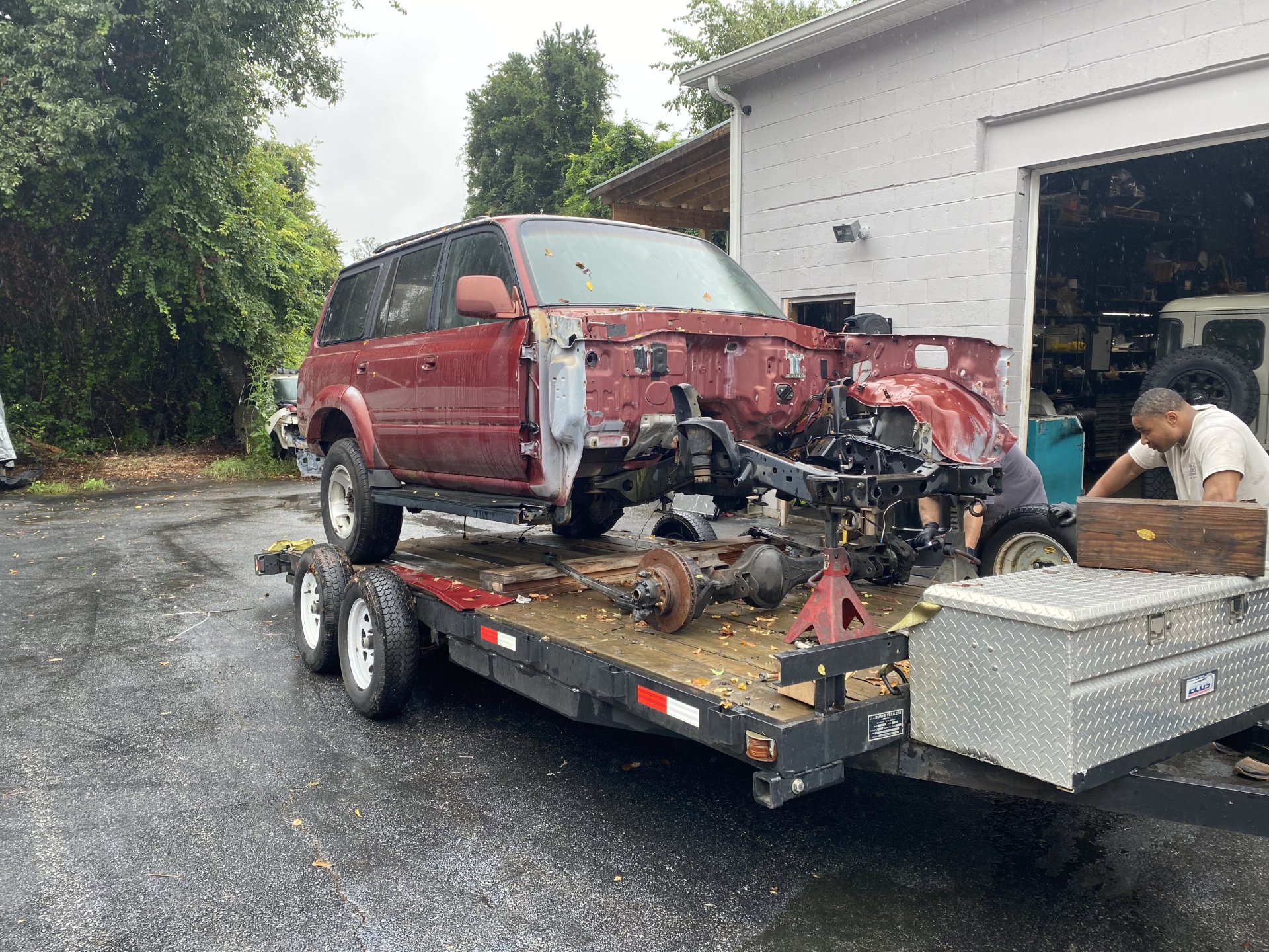

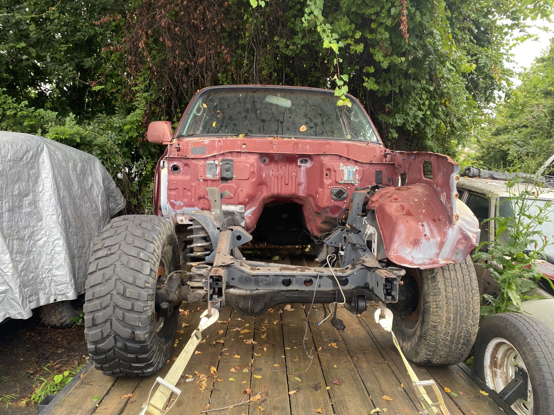

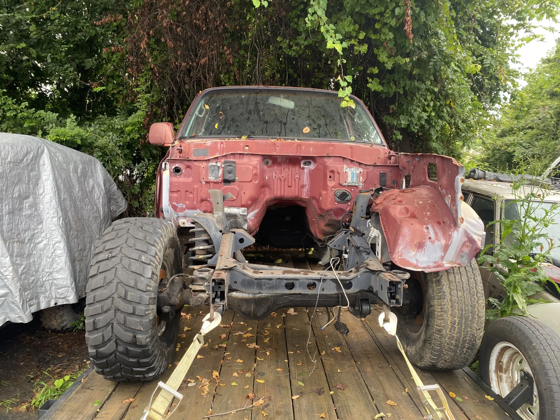

I’ve already had my first HAMOM for it, so I guess I should start a thread for my new project. The Crasin was fun, but I’m done dumping money into a “budget wheeler.” It will be parted out to provide a bunch of small parts for the new build, and some bigger parts for my other cruisers.
Ironically, the 80 that I stole the axles from for the Crasin ended up on my trailer. It’s a VERY bare shell. Forklifts are great for loading it, but I had no way to unload once I get it home. Thanks to @Trollhole and @White Sheep for helping me throw some spare parts under it to make it a roller at the first (of many) HAMOM.
The plan is to drop in a 6.0 LS that I have, buy Ford super duty axles, and run a ford NP205 with an ecobox doubler. Also, major body mods.

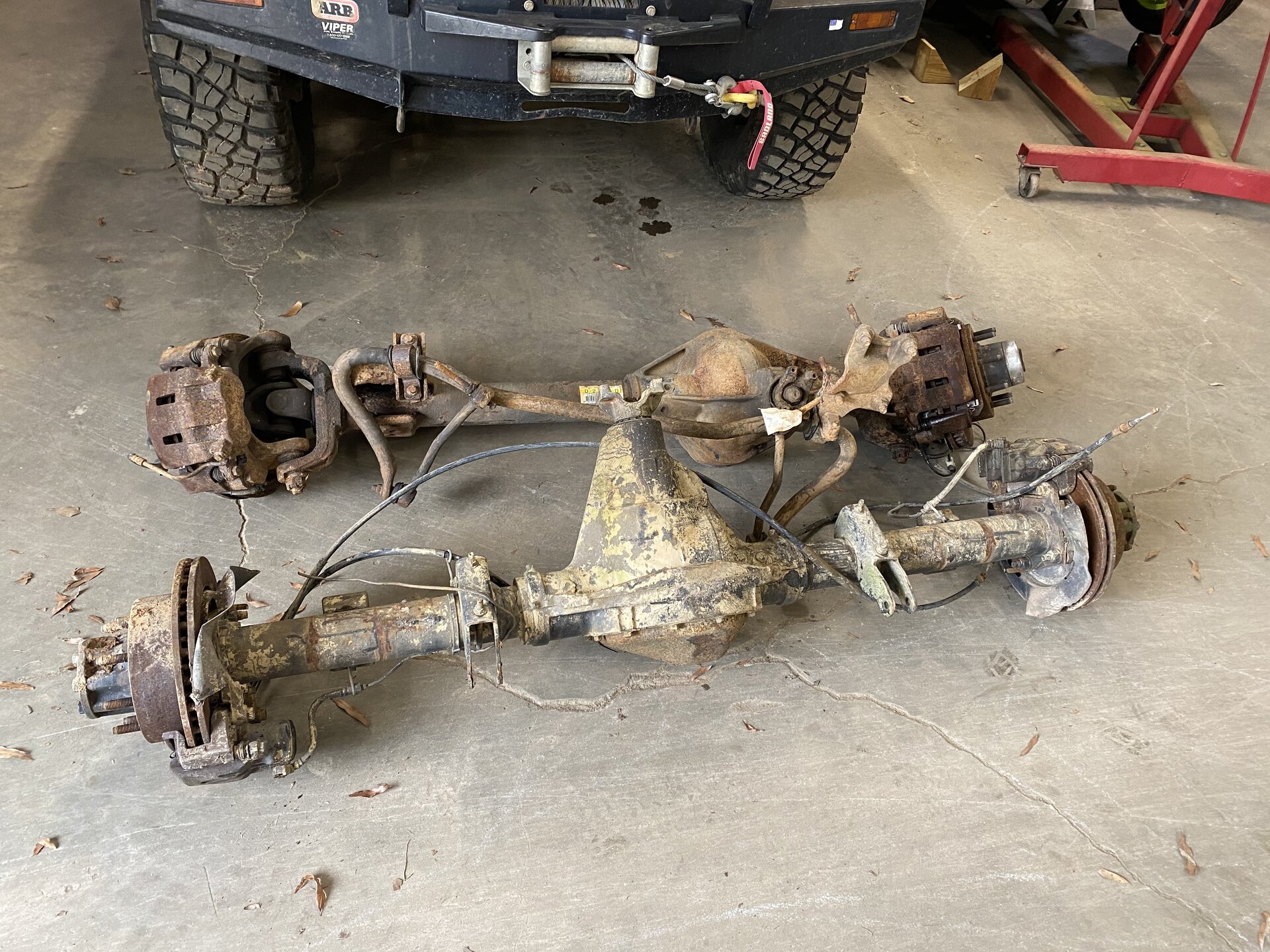

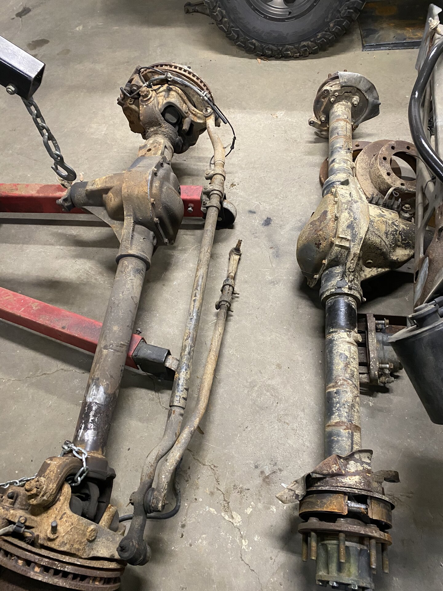

Axles are stripped of all the stock suspension mounts.
Ford was not joking around with these rear leaf spring perches.
