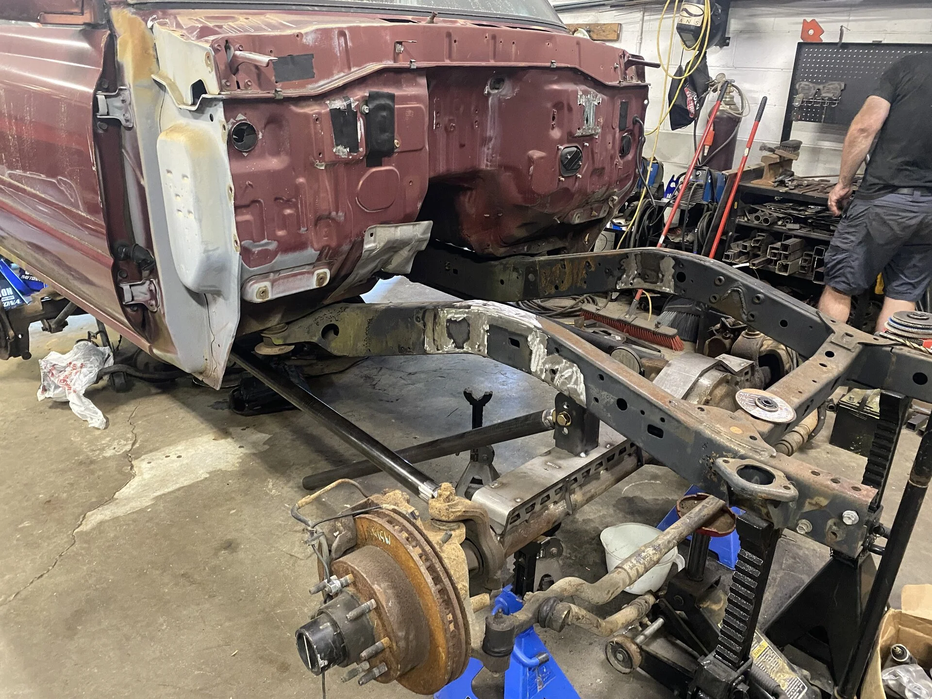

Slowly but surely, more progress has been made. A lot of cutting and grinding has happened, and the front axle has been moved roughly to where it will live. Now the fun can start. I can’t wait to see this thing sitting on 40s and tons.

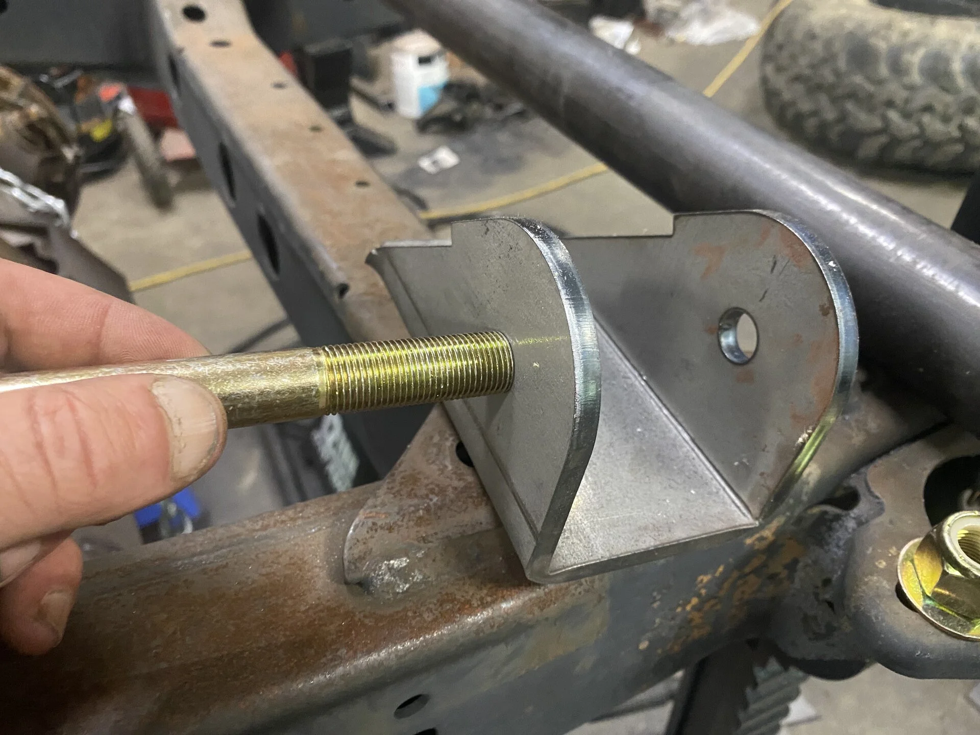

It’s been a while since I’ve updated the build thread. Some health problems have slowed down progress, but I’m finally getting back into the shop and making things happen. More cleanup on the frame has happened, as well as stripping out the stock tank, fuel lines, and brake lines. Link mounts have been tacked to the axles, and the lower link mounts have been tacked on the frame side.
Before any of that could happen, I had to heat all the bolt holes on the brackets with a torch and let them cool slowly to anneal them. Then I could drill them all out to 5/8”. I’ve always been really happy with my purchases from RuffStuff specialties, but having every hole cut to 9/16” when all the hardware in the kit was 5/8” was a bit of a pain. Holes have been enlarged, and progress is being made.
Next I’ll start plugging in numbers to 4 link calculator, figuring out the frame side upper link mount, and getting the Iroks off of the cruiser wheels and onto the 8 lug ford wheels.
It’s been a while since I’ve updated the build thread. Some health problems have slowed down progress, but I’m finally getting back into the shop and making things happen. More cleanup on the frame has happened, as well as stripping out the stock tank, fuel lines, and brake lines. Link mounts have been tacked to the axles, and the lower link mounts have been tacked on the frame side. View attachment 3393569
Before any of that could happen, I had to heat all the bolt holes on the brackets with a torch and let them cool slowly to anneal them. Then I could drill them all out to 5/8”. I’ve always been really happy with my purchases from RuffStuff specialties, but having every hole cut to 9/16” when all the hardware in the kit was 5/8” was a bit of a pain. Holes have been enlarged, and progress is being made. View attachment 3393573

That’s funny that this happened to you too, but with the Ruff Stuff parts. When we had to do this on my shackles for the 60 it was the Barnes parts. It’s so amazing how well it works.
