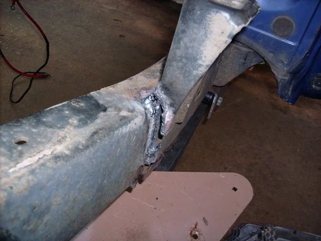

Burned in the front suspension. When I build the front bumper Im going to box these in.
