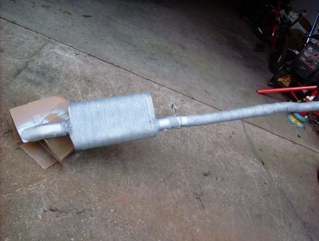

The exhaust was way easier than I was planning on. Its pretty tight coming over the crossmember, but I just cut up a few pieces of some old exhaust and it squeaks by.
I hope this wrap will cool it down, as it runs pretty close to the u-joints and side of the t-case. Im probably a dumbass, but those stupid metal-zip ties were a pain in azz to get tight.
