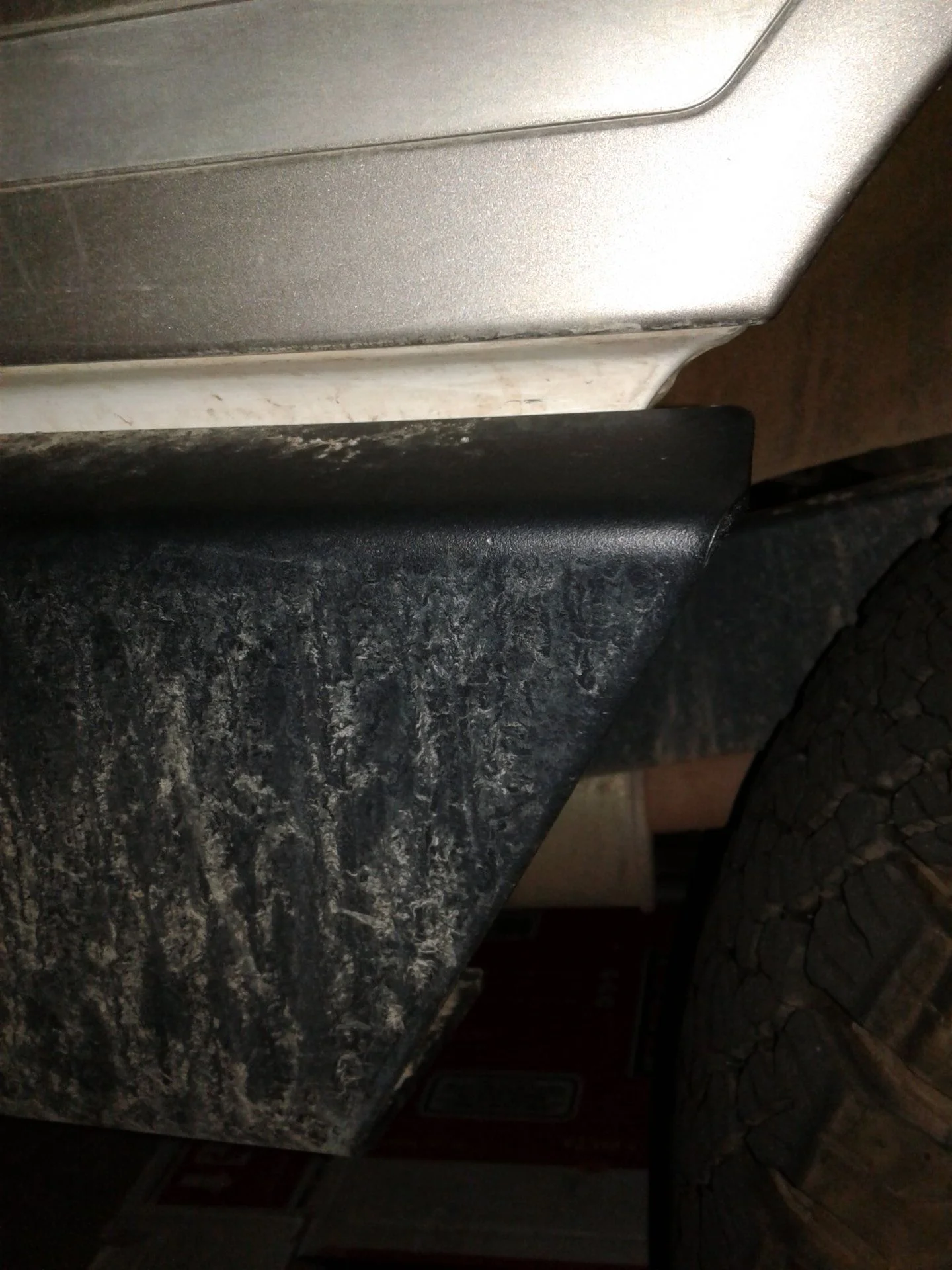

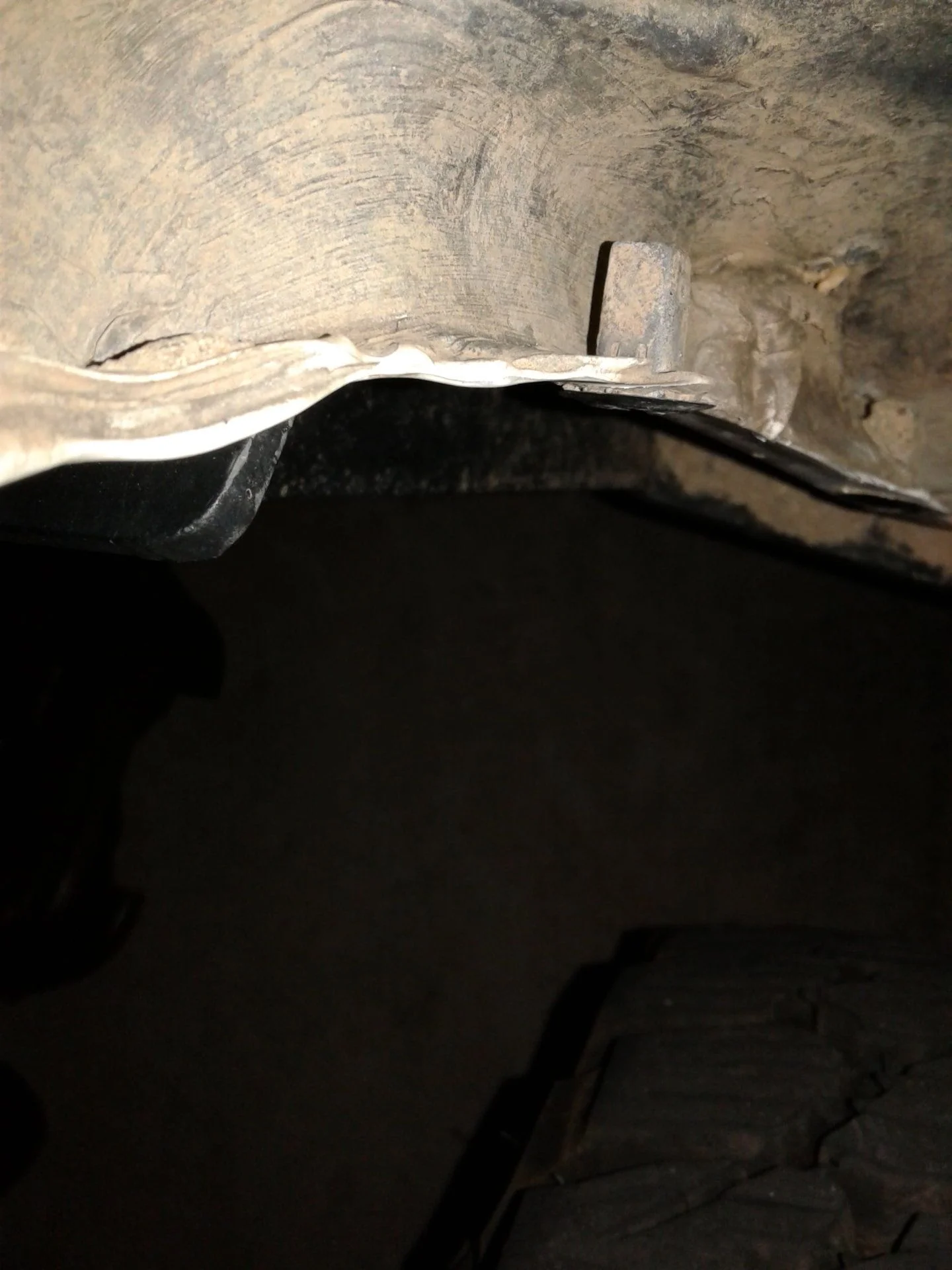

Rami, I was driving behind you on the way out of work today. They look great. I want some. Unfortunately from your diagram/picture, I think there might be some interference with the BIOR wings. They protrude a little past the edge of the wheel well but not in a consistent manner. Might have to rig up some kind of spacer to clear that leading edge of the side wings that sticks forward.
Rami, I was driving behind you on the way out of work today. They look great. I want some. Unfortunately from your diagram/picture, I think there might be some interference with the BIOR wings. They protrude a little past the edge of the wheel well about mid way and on down to the bottom of the wings. Might have to rig up some kind of spacer to clear that leading edge of the side wings that sticks forward.

I took these photos several weeks back. Crappy phone camera and bad lighting but you kind of get the gist of the potential interference.
