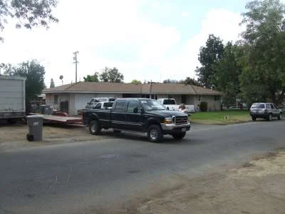

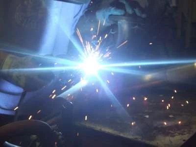

Got to Chris' house on Fri night. Began watching him tig up the finishing touches on the fuel cell. Unbelieveable work. He will post pics of that later ;)

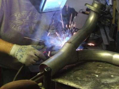

Bob got the full exhaust treatment. Funny watching someone try to shoehorn everything in. The Front DS really wants to argue with the starter and teh exhaust. We (Chris) had to make some fun tools to make everything work together properly...
the PS exhaust runs straight down and over, so it sits between the "bellhousing" and the tranny pan.. Might have to make a heat shield for the pan.. Donno yet.

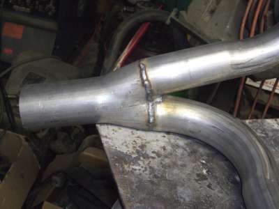

the bends had to be so close together so that the machine could not do it. So, Chris just made a bunch of bends and welded them together.
I had brought a 2.5/3" Y but Chris did not like how far it ended up placing the catalytic converter...

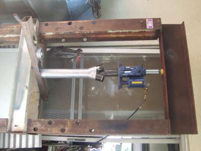

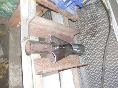

So, time to build a tool.. Fun stuff.
This piece was 2.5" tubing on the top and just under 3" on the bottom (to keep it straight..)
We basicaly set it up with the press and forced the 3" tubing to flare to dual 2.5" tubes...
The piece turned out perfect :D

Damn kick ass idea on the 2 to 1. I was trying to figure out to build one of these the other day without it looking like a cluster f**k. Thanks:beer:
