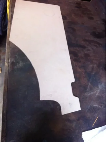

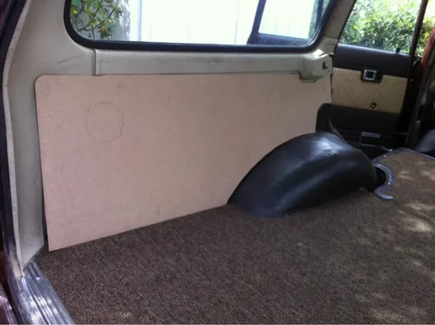

So I recently upgraded the rear cargo area of my 85 cruiser. Since installing new interior from a donor. The rear panels where trash so decided to replace and make new ones. So I bought some 1/4 MDF and traced out my old panels. Cut it with jigsaw. Drilled out all the holes. And covered it with carpeting I bought at Home Depot. image-1922043053.webp image-4014284983.webp image-3703481995.webp All is done but now I want too know how too attach too existing holes and what I should I use? Overall the work was easy and cheap. Change the look of the rear cargo! I am very satisfied with it.
