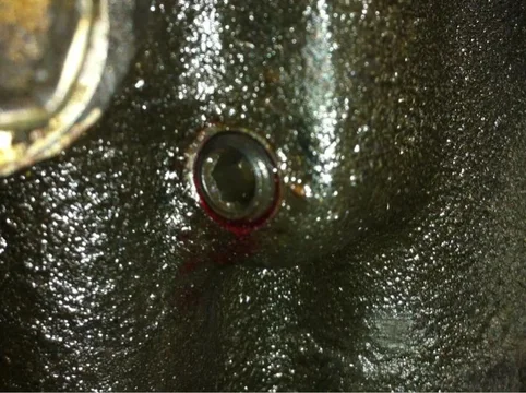

So today I figure I get in and do the oil galley. On my 84.
Wasn't so bad, got all tools together removed a few parts and Walla it was done. Now I can drive with a piece of mind it won't pop out.

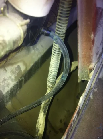

Today I decided to work on the rear lift gate wiper squirter. I push the bottom the other day to see if the little pump works. I heard the pump doing its thing then I saw water coming from the headliner at the rear. So that told me that the supply hose is cracked and or broken.

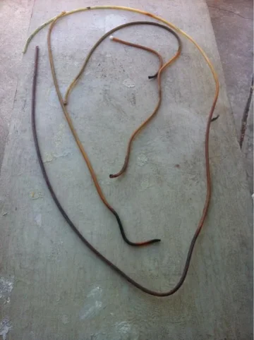

I go ahead and pull out all the hose line and this is what I found old dried and broke hose .
Note when you replace this hose they will have two connectors one is a coupler (which broke when I pulled it) the other is a check valve on the passenger side inside the lift gate frame. This only goes one way so that the hose does not empty out when not in use.

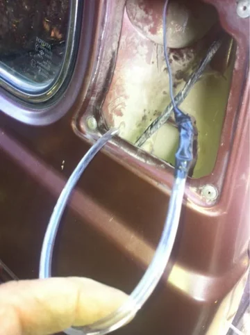

So I run over to the local fish store and pick up 20ft of 1/4 air hose. I used it In the past and it works great.
I tried finding the old hose to use a fish line but I couldn't get to it. So I used some wire that I had Latin around that I use for staking poles to newly planted tree.
I made a loop at one end the wire to as I fish it through it won't get caught and also so I can thread the hose through it and tape it. I also used electricians grease for pulling wire makes it whole lot easier.
I pulled it in two sections . I fished the wire through the rear cargo light to the driver side where the resivior bag is. Pulled tubing out the rear cargo light then separated it from wire. Then fished fish wire through the hole at passenger side of rear door and came out the rear cargo light where I attached the tubing again to the wire And continued fishing it through the second hole on the rear door itself. Remember to also at this time fish through the rubber grommet that connects from the body to the rear door
Once you fished everything attach tubing to the squirter and to the pump. And before butting everything up. Turn the key and push rear washer button and make sure no leaks. And tot done. New tubing and fresh windshield washer fluid to clean the rear glass.
