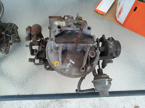

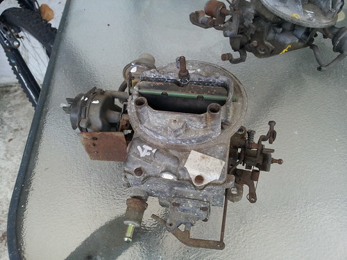

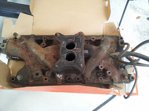

so trying to make some adjustments to my carb and tightening the carb down broke the front passenger side ear off my holley carb...so looking into carbs it was recommended to use a motorcraft 2100 hundred. so looked around and 2 junk yards later i found a couple! also got an intake manifold so i wouldnt have to use an adapter plate.
heres what im working with right now...oh yea i bought 2 carbs just because lol
and the intake...anyone have any good ideas on how to clean this bad boy??

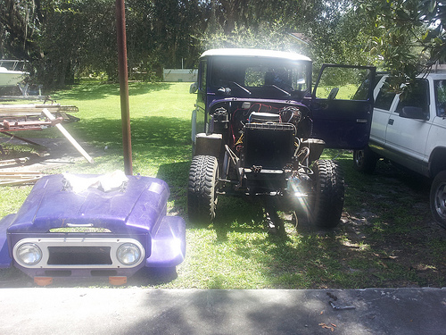

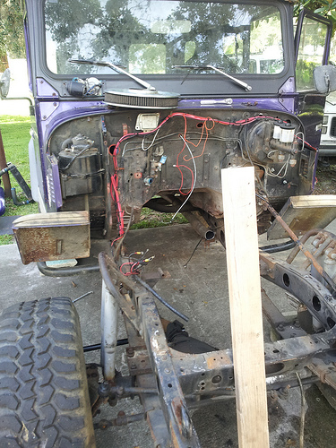

i removed the hood to make it easier to get around everything
started with removing the power steering to show the sweet set up that was previously on the car.

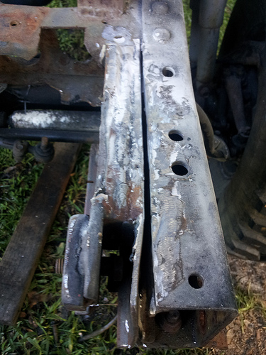

cutting the bracket off

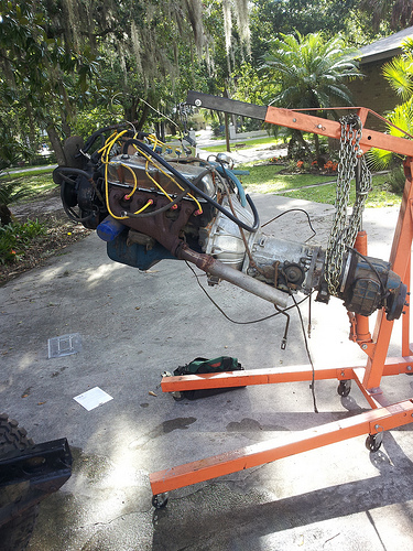

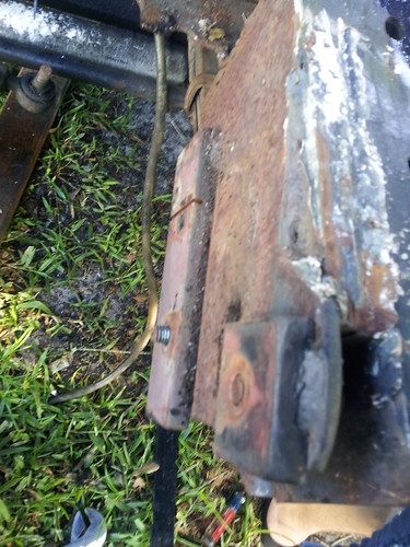

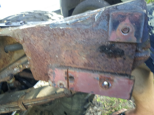

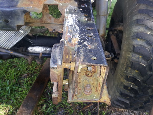

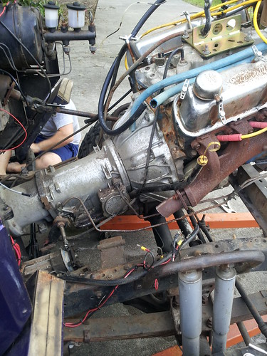

worked on getting the engine out today so i could redo the engine mounts...im hoping i will be able to tuck the drivetrain up as far as possible to have a nice smooth bottom. now back to work tomorrow hopefully able to fix cross member and work on some mounts next week.
engine almost out
engine out awaiting its temporary resting spot
