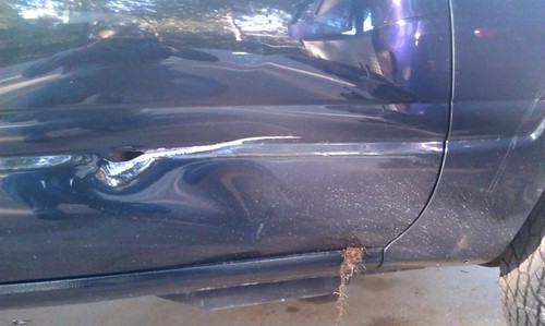

We attempted to start it a few months back and that turned out well, it turns out the motor runs, and runs very well, only problem is PARK is not PARK but reverse. and apparently there is no neutral safety switch. SOO Barney roars to life launches into reverse and thankfully the joy ride was stopped by ripping a hole in the door of an 80 and almost breaking 40tude's dads knees. BUT he runs!

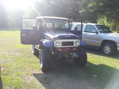

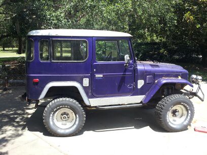

- Barney as he sat this afternoon - sweet front has since been bumper removed

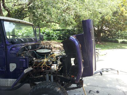

- P.O. Redneck Engineering - the whole weight of the hood is put on the hinges of the bezel :confused:

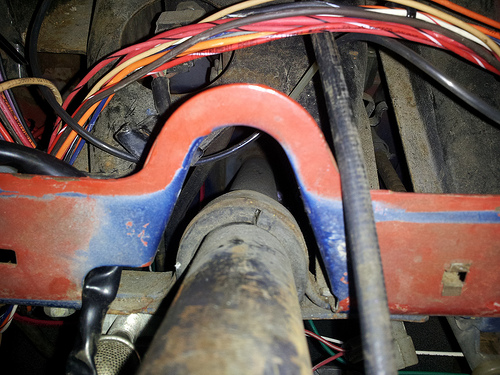

- P.O. Redneck Engineering - Crossmember - as you see the decreased clearance of the crossmember was greatly improved by the super long bolts..but they figured they would get some extra clearance by running the exhaust tubing under the cross member...to protect the bolts im sure :censor:

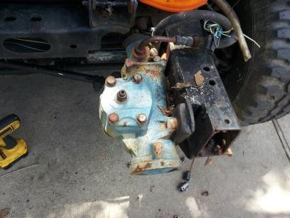

- No better way to mount that box then hacking up the front cross member and wedging 16 different thicknesses of metal together and welding it all in place.

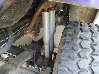

- Dual Shock Mount

So i decided it was time to tow Barney home so I could work on some wiring while 40tude has some other stuff going on, but before that could be done as Austin(40tude) pointed out there was some bezel work to be completed.

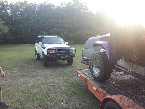

Since it isnt driving at this time some winching had to take place testing out his new hydraulic winch...thankfully it worked. We ended up having to switch up tow rigs due to some clearance issues. Then lighting issues so the tow will be moved to wednesday when its daylight out :doh:

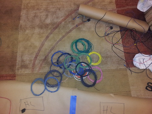

ok so ive been working the past couple days and have been chasing wire problems... which resulted in me pulling out all of the wiring and seperating the harness. and then started putting it back in and wired the engine up. Finally got the engine to fire today after figuring out i didnt have my 12v going to the distributor so i ran a temp cable to the battery, had spark and she fired, ran for a couple minutes and i turned it off to hard wire the distributor. And have got a couple more times running for a second or two but thats it...on shift for the next 3 days so prolly wont be getting any work done till sunday. anyways here are some pictures, and ill post a video of it running a little later. :popcorn:
Wiring Harness after pulling it out
Wires all nice and seperated
