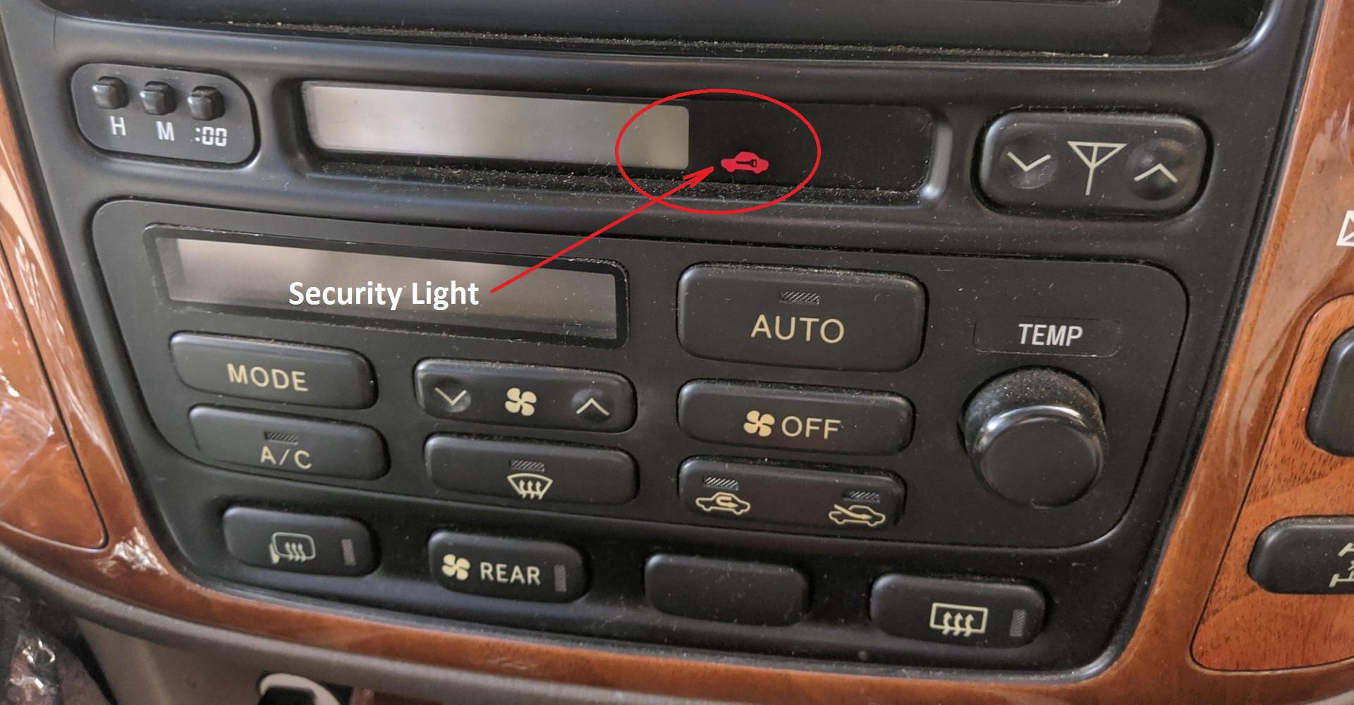

Do you have a working security light?
Yes I do. I believe it is blinking as it should. For example, once I shut off the car and remove the key from the ignition, the light will blink again. Also, the light will glow solid for a few seconds once I lock the doors from the outside with the key, then blink as normal. Security light is off once engine is started or car is turned to “on” on the ignition.

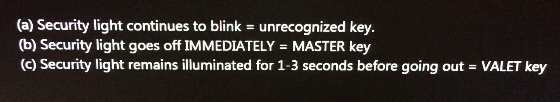

Good....all of that sounds normal. So back to the keys you have.
Run this test. Insert key into ignition (do not turn on).
Neither the master nor the key valet key does either. I confirmed this when I tried to program a new master key myself.

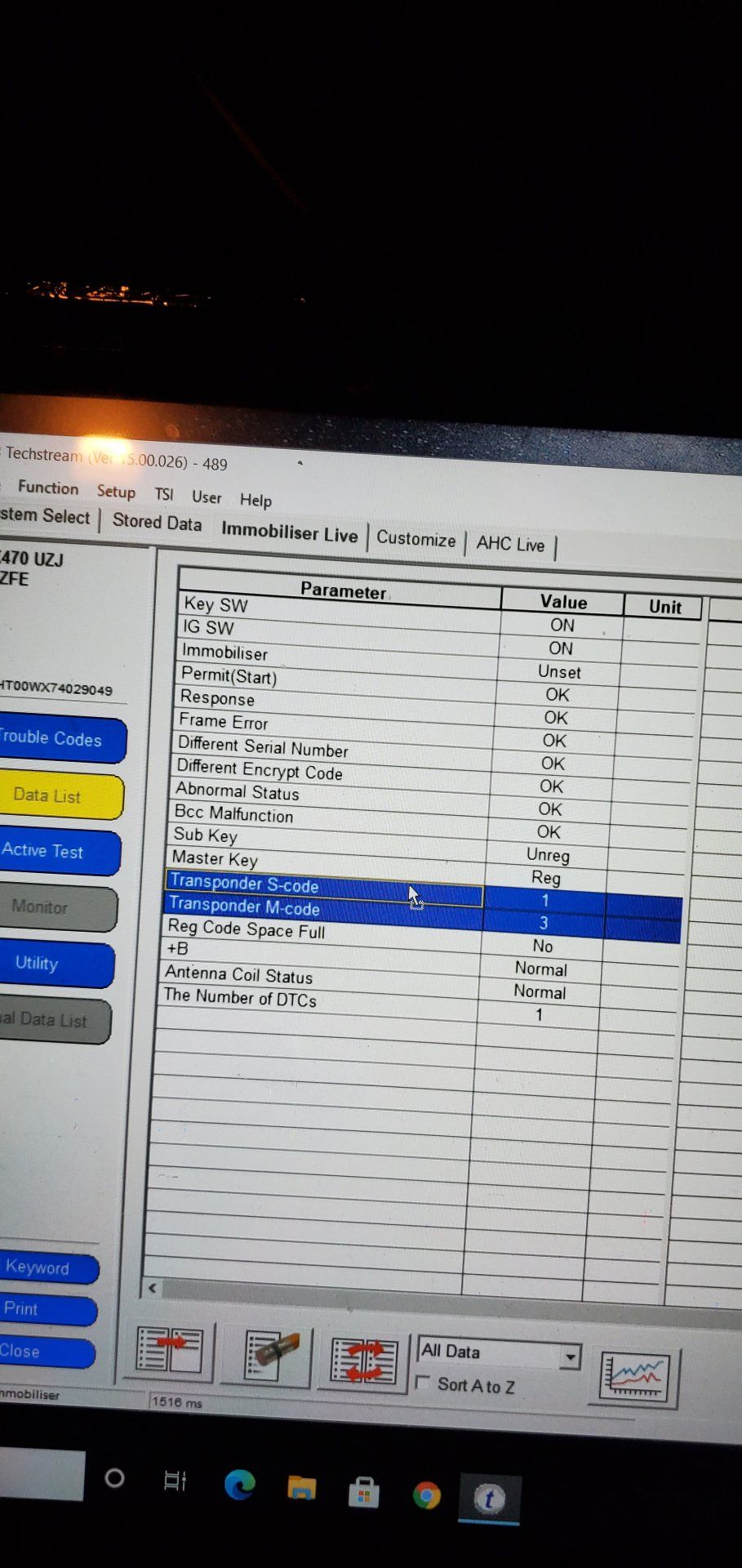

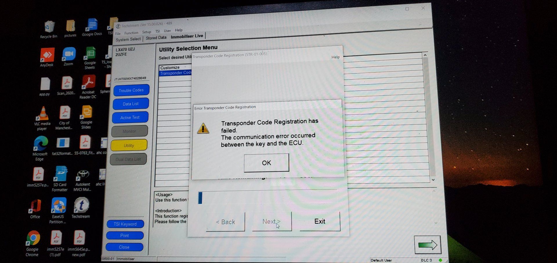

Have you tried using Techstream software? It is the easiest way to program the immobilizer function. If you are getting errors shown in the #26 post, then your key fob chip may be incompatible.
I have tried techstream without success. I was getting the same error message as shown in post #26. Do you know know where I could get the chip by itself. The key is already cut.

This is the error I get.
