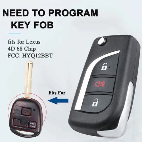

Okay just to confirm, i have a 2007 LX470, i bought the key off eBay and was able to program the remote to work!
This is the link to the eBay ad i bought it off of, i at $17, it's a no brainer, plus the unit itself looks really good and the key part is very sturdy, doesn't wobble or feel weak.
But don't count your chickens yet, i have to go get the key cut and program the immobilizer, any reason why the remote work but the immobilizer would give me issues, or should i assume it'll be able to work?
Can confirm this works on an '06 lx 470! Here's an updated link
Got the blade cut at my hardware store for $4 and used the cReader Elite to program the wireless fob and register the key with the immobilizer. So looks like for 2006 LX 470 at least the 4D68 transponder chip and HYQ12BBT transmitter are what you're looking for. Hope this helps anyone interested in an aftermarket key fob alternative. My only complaint is that I marred up the aluminum a bit while trying to set the pin which holds the key blank to the remote. I'm just a gorilla some times though and likely not an issue for everyone.
