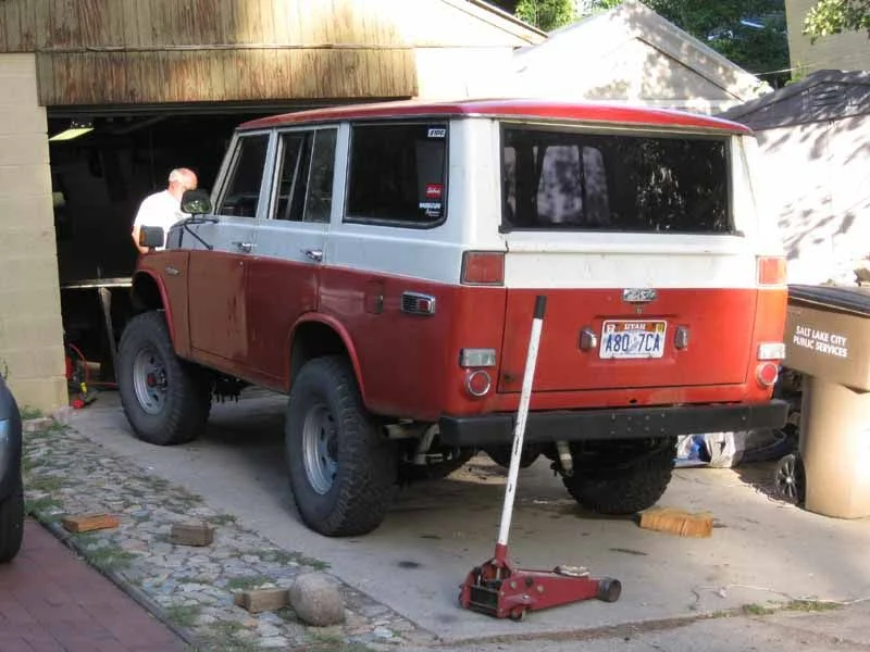

Linked his thread in the swine resource thread, here's a pic:
attachment.php
