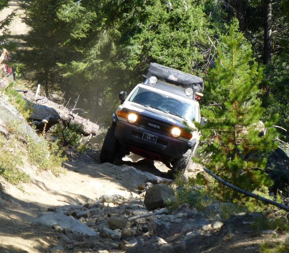

i have been looking at this one...i run a tepui thats about 200lbs..how has your experiences with the RTT been now that its been on for a while? you mentioned it rattled loose. Is this somethign that could be mended with locktight? and was there a reason yours is mounted in the dead center? i was hoping to push mine back a bit so it was flush in the back and have room for a couple of storage bins that way im ramming them into trees and not my tent.
I answered partially in the other thread, but you could mount it anywhere. Because of the RTT mounting system, you have to drill holes all the way through your cross members. And you will likely need to move the cross members to one of the alternate slots to match the mounting rails of the RTT. We were in a bit of a time crunch when I mounted the tent just a few days before our big trip, so I forgot the loctite and should have checked the bolts sooner for tightness. Conveniently, I packed my impact driver and made quick work of it at a rest area.
Since the RTT was a loaner, I don't have many detailed/close up pictures to share.

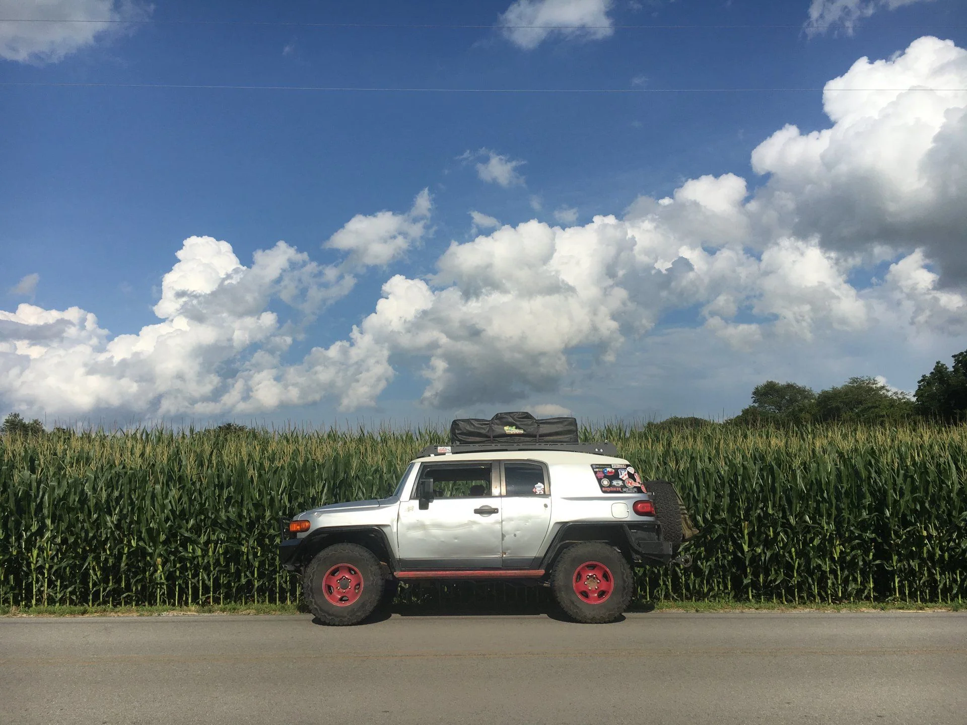

my set up is just awkward right now but it works!
thats the factory rack and air dam
