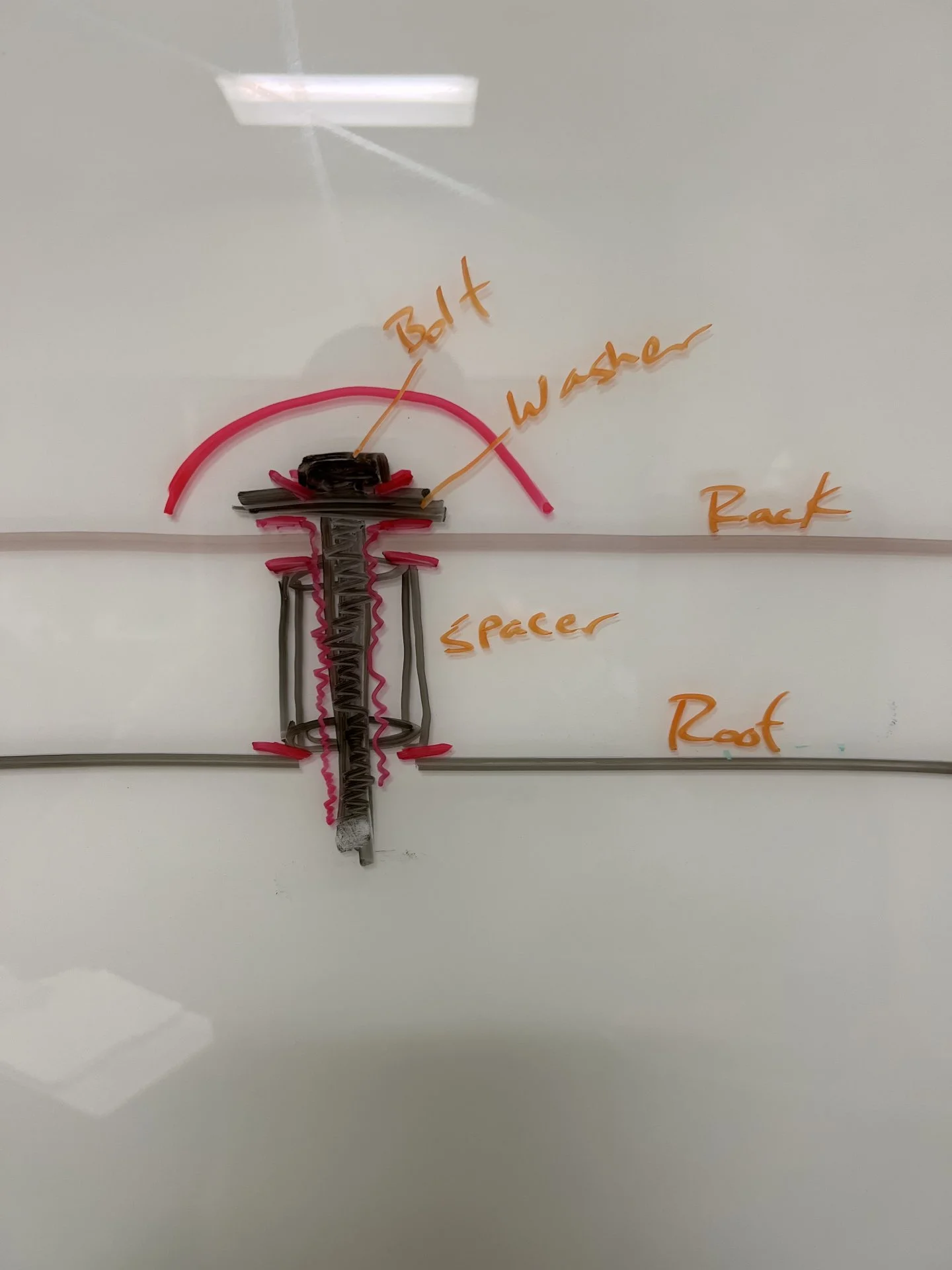

Anyone had problems with the permatex drying out? I've observed dry cracking and brittleness mostly around globs I placed on top of the bolts/washers - from direct UV exposure. I've had my rack installed since July and never had a problem with water ingress - until this week, 1 of the 8 mounting locations is leaking water inside.
Other than adding a new round of permatex everywhere, has anyone tried a secondary coverage method like flex seal tape or similar over the bolts?

The non-hardening form a gasket or RTV?
The top layer of my final goop is cracking, but if I press it hard, it’s still malleable.
Red lines are where I put form-a-gasket. Each of the following locations are potential entry points:
Between roof and spacer
Between spacer and rack
Between rack and washer
Between washer and bolt head.
I tried to keep things nice and neat, but ultimately added it in all the places, then gooped up on top.
Love the whiteboard diagram, ha!
Application is consistent with what I did except for the full coverage dome on top of hex head and washer.
I'll do some permatex touch up this weekend, see how long it lasts.
I wish Prinsu would come up with a better solution. I simple rubber membrane and / or gasket would fix this.
