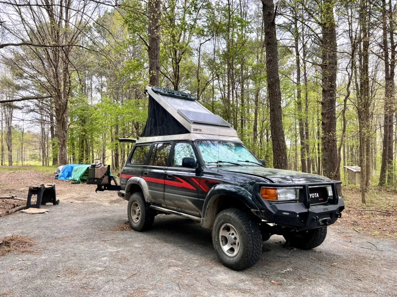

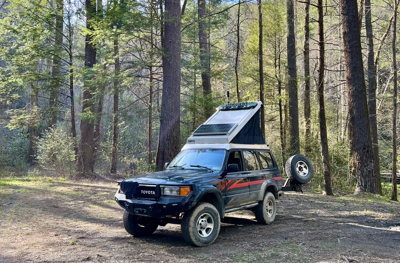

So a bit has happened in the last 4-5mo. Quite a lot has been tidied up and sorted out and adjusted and tweaked and generally obsessed over. (Much more than is documented below.) Added a double carton front shaft due to a vibration at highway speed. And loads of other random adjustments. Interior is "finished" for now. We'll see what needs changing/updating/redone after a few months on the road.
But I'm finally packed up and leaving in a few days for good. Or for now. Or whatever. Hitting the road in the Beast-with-No-Name (still working on that). First South (because, duh, it's bloody cold up north here) then West. Then probably North again because it will get hot fast out there. Stay tuned for sporadic updates of travel, trails, trials, and general mayhem & road life. FINALLY WOOOOOOOOO!

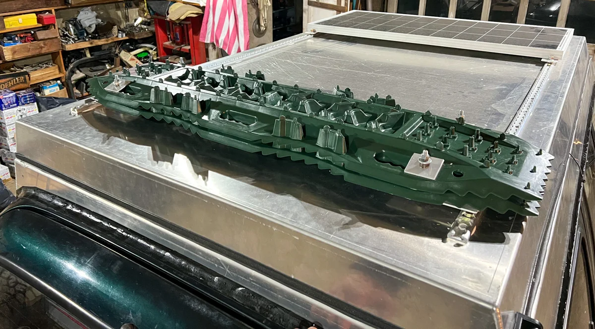

Traction Boards on the roof.

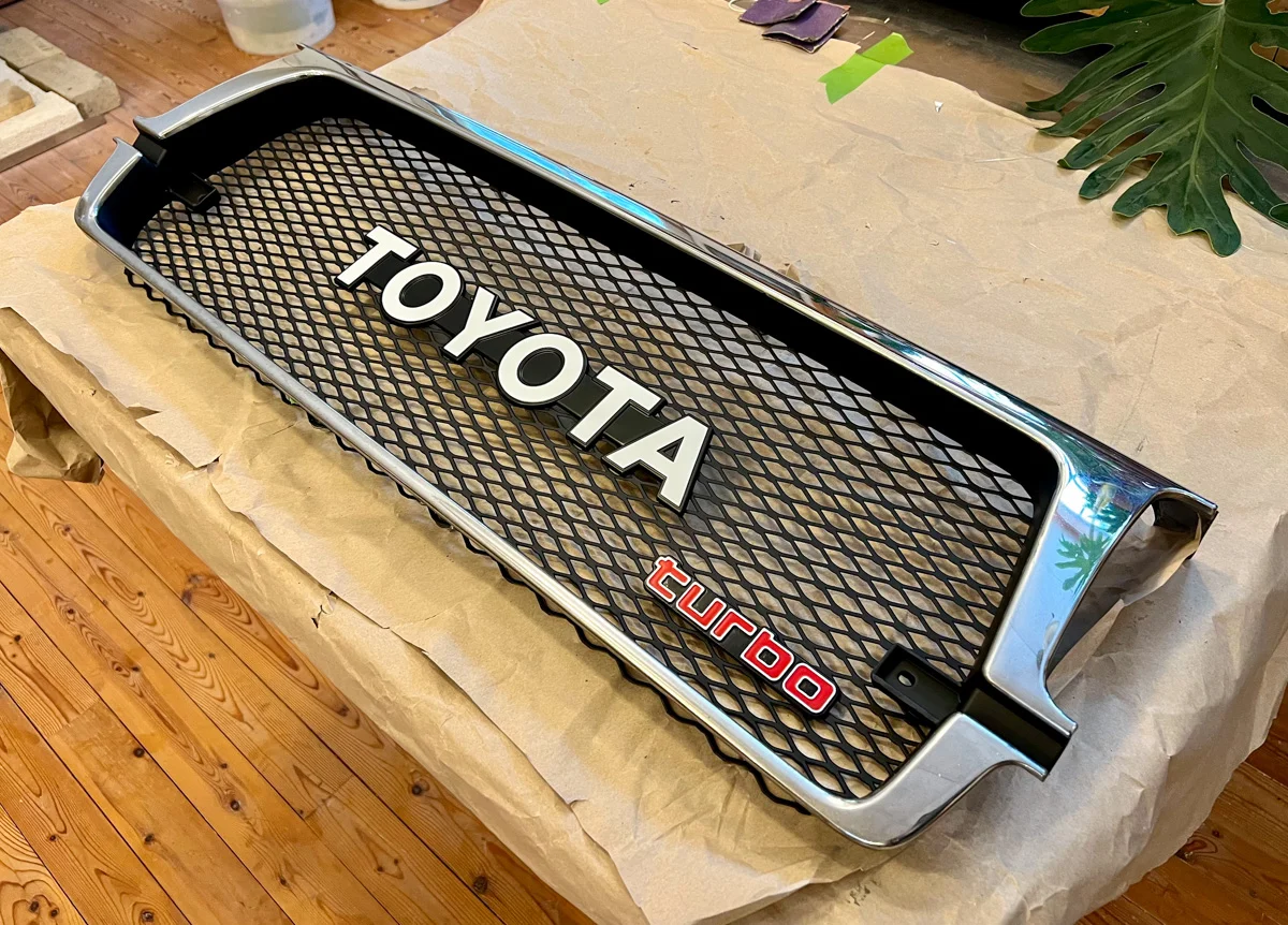

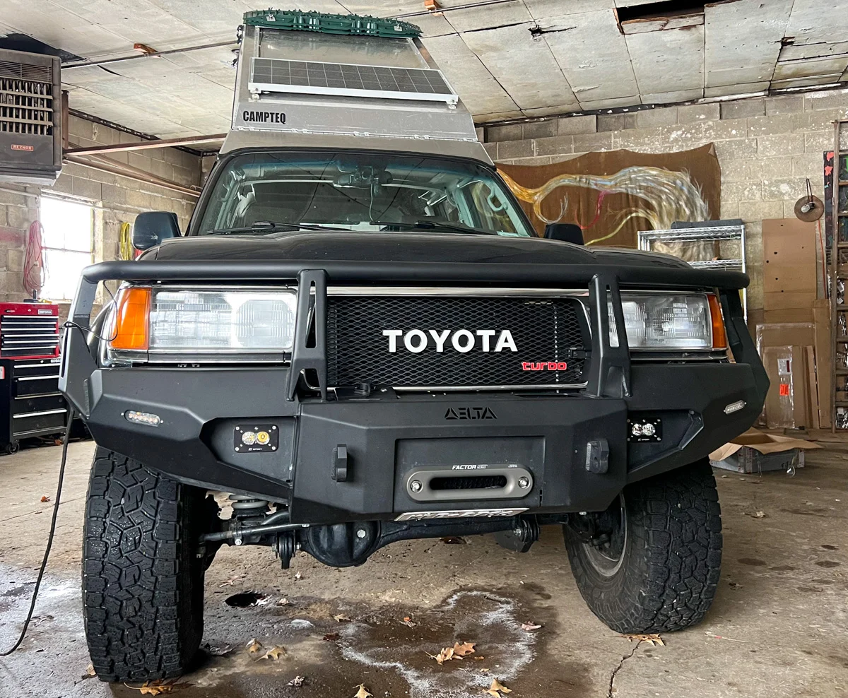

Custom Grill for the Turbo Diesel
Grill on, Comeup Winch Installed with a rather oddly mounted controller due to having a front mount intercooler etc etc etc to work around, I think it came out ok. Visible but low profile.

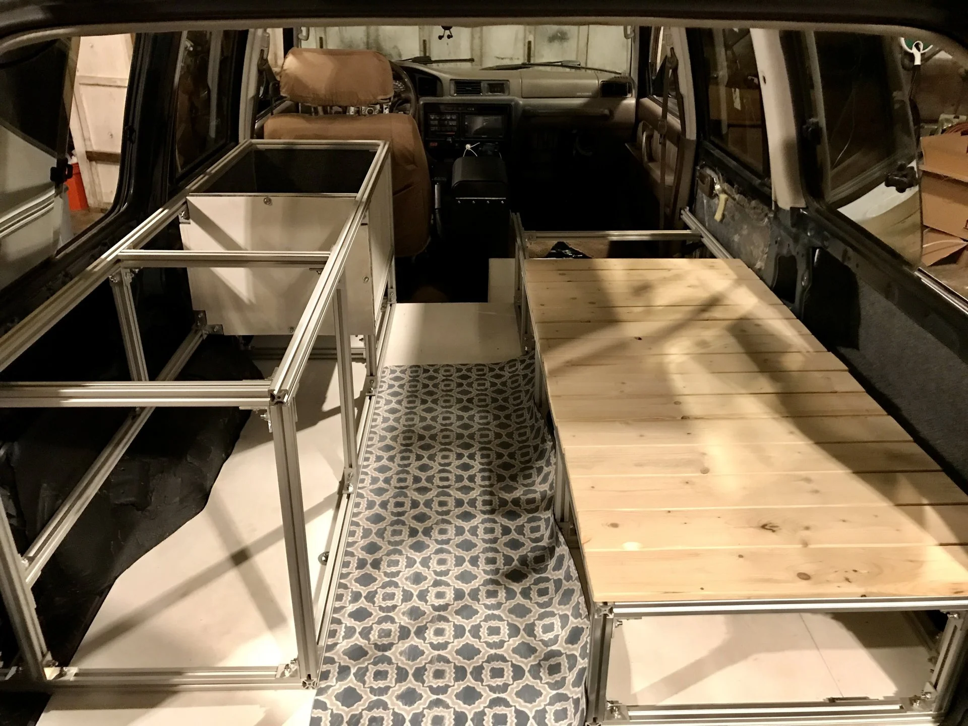

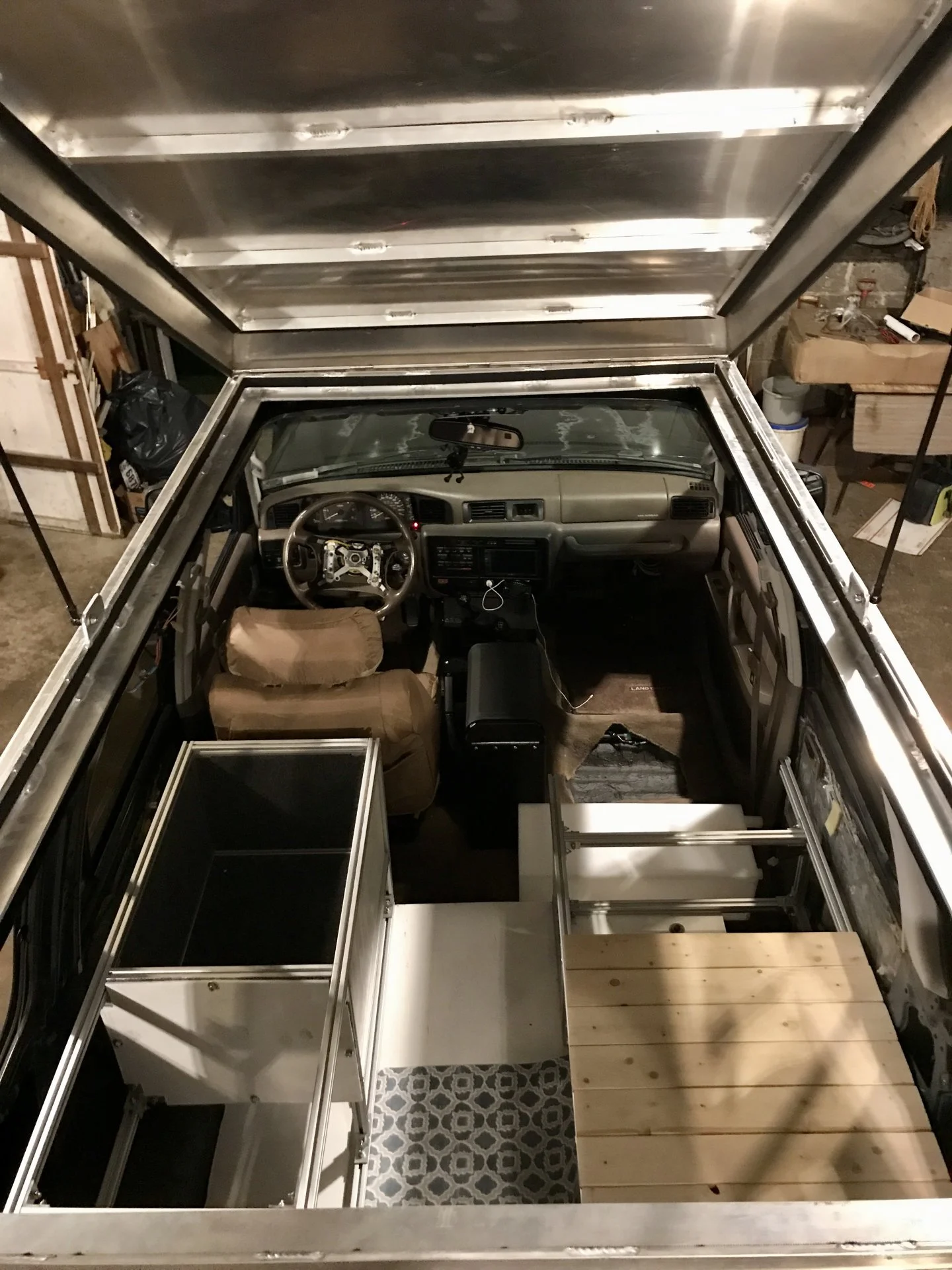

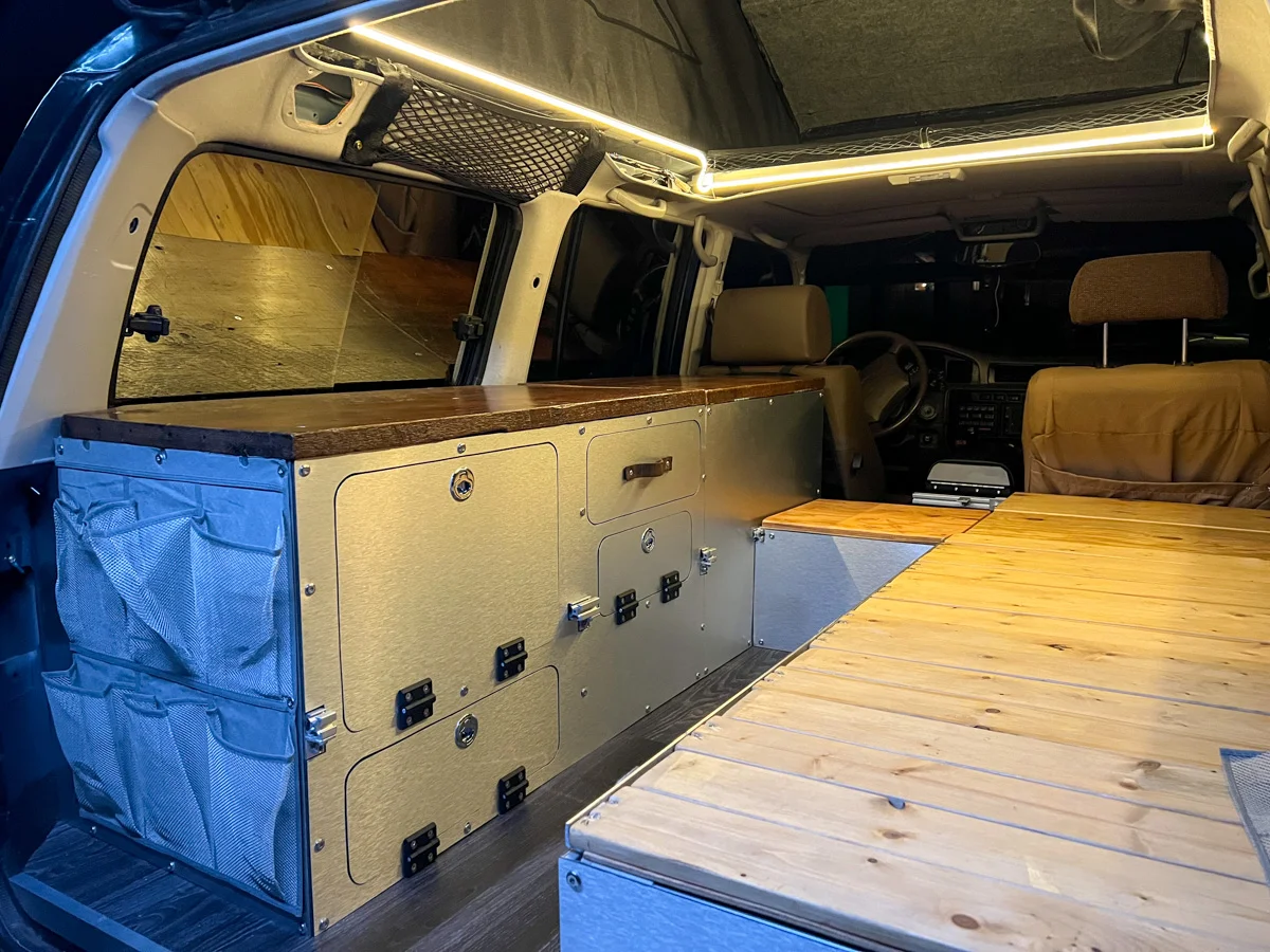

The interior build out is … coming along. Slowly. I framed it out with extruded aluminum and my own self-fabricated aluminum fittings to try to keep the bloody cost down a bit. I've been having trouble sourcing facing material for countertop and bench. Between being landlocked here in the middle of nowhere and supply line problems… Top choices are Marineboard or architectural aluminum composite panels. But with shipping at $300/sheet or a drive all the way to the coast as my only options, I'm probably going to have to pick something more boring. Suggestions welcome.

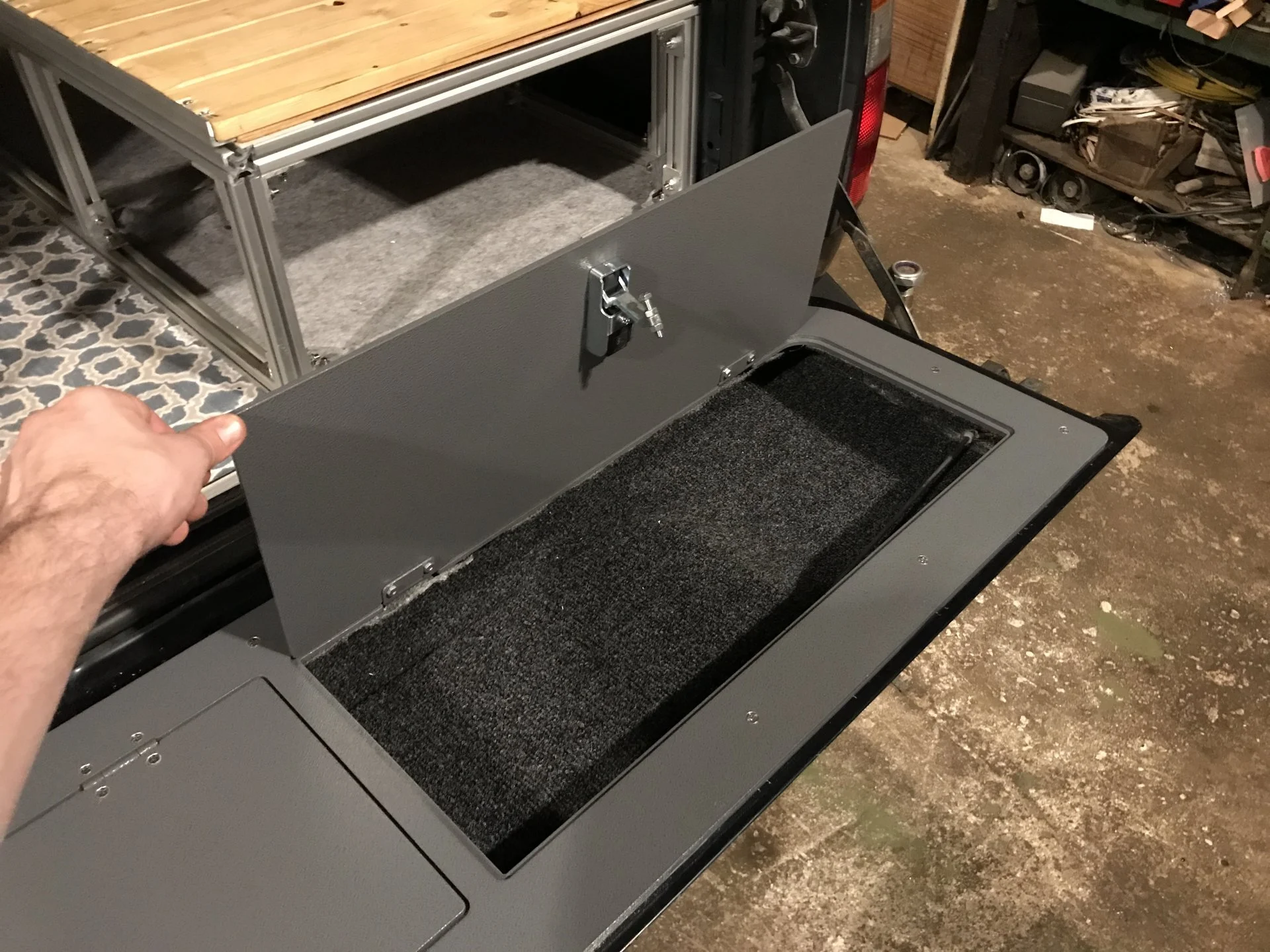

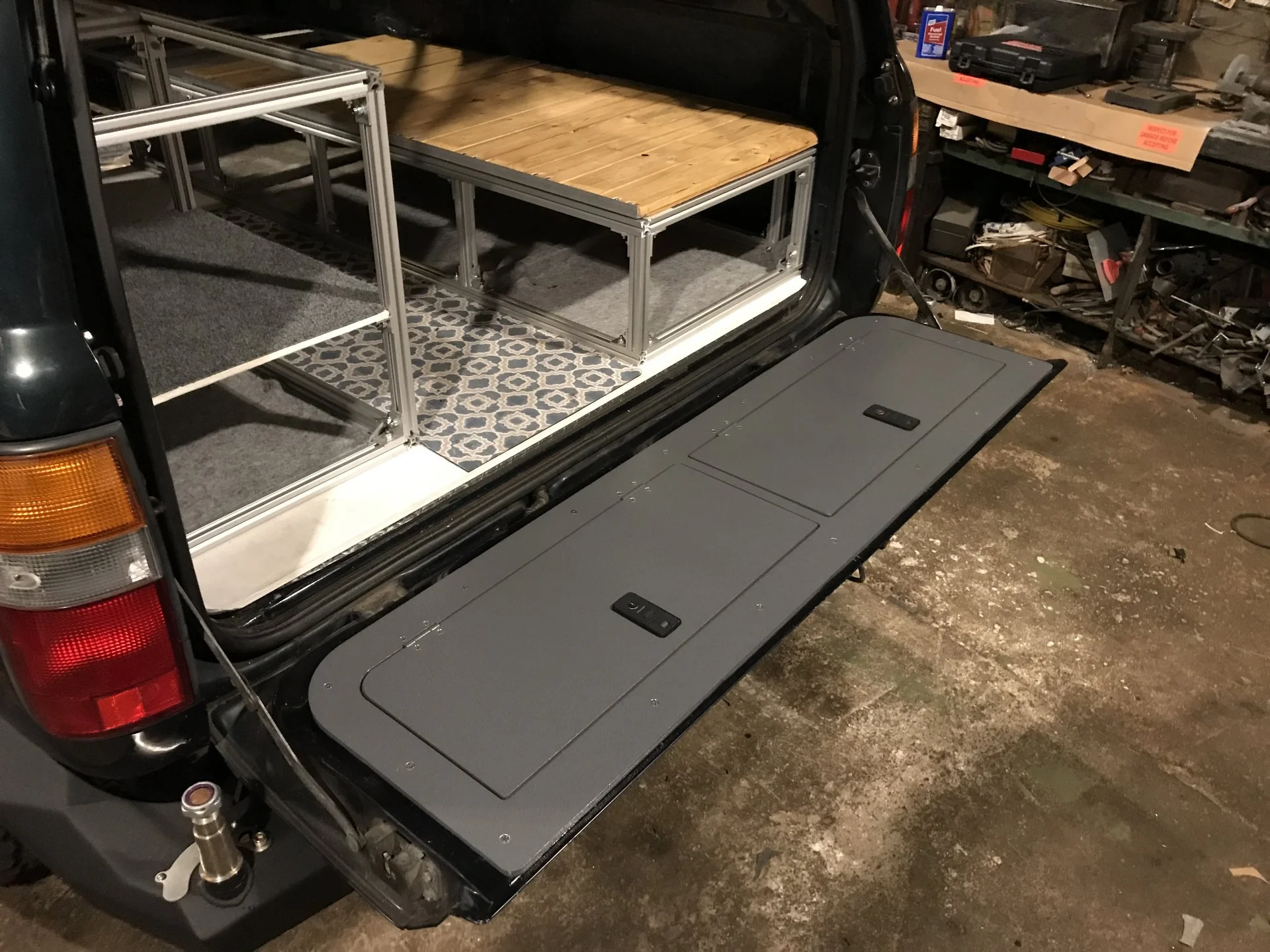

I've also added Backcountry 4x4 tailgate storage that I bought second hand but never installed from someone on Mud here. It's a really fantastic piece of powder-coated aluminum with well designed support that makes it very strong. But I was unimpressed with the aluminum pop-rivets that came with it. So I countersunk drilled all the holes and added my own stainless steel hardware. I'm pretty happy with the results.

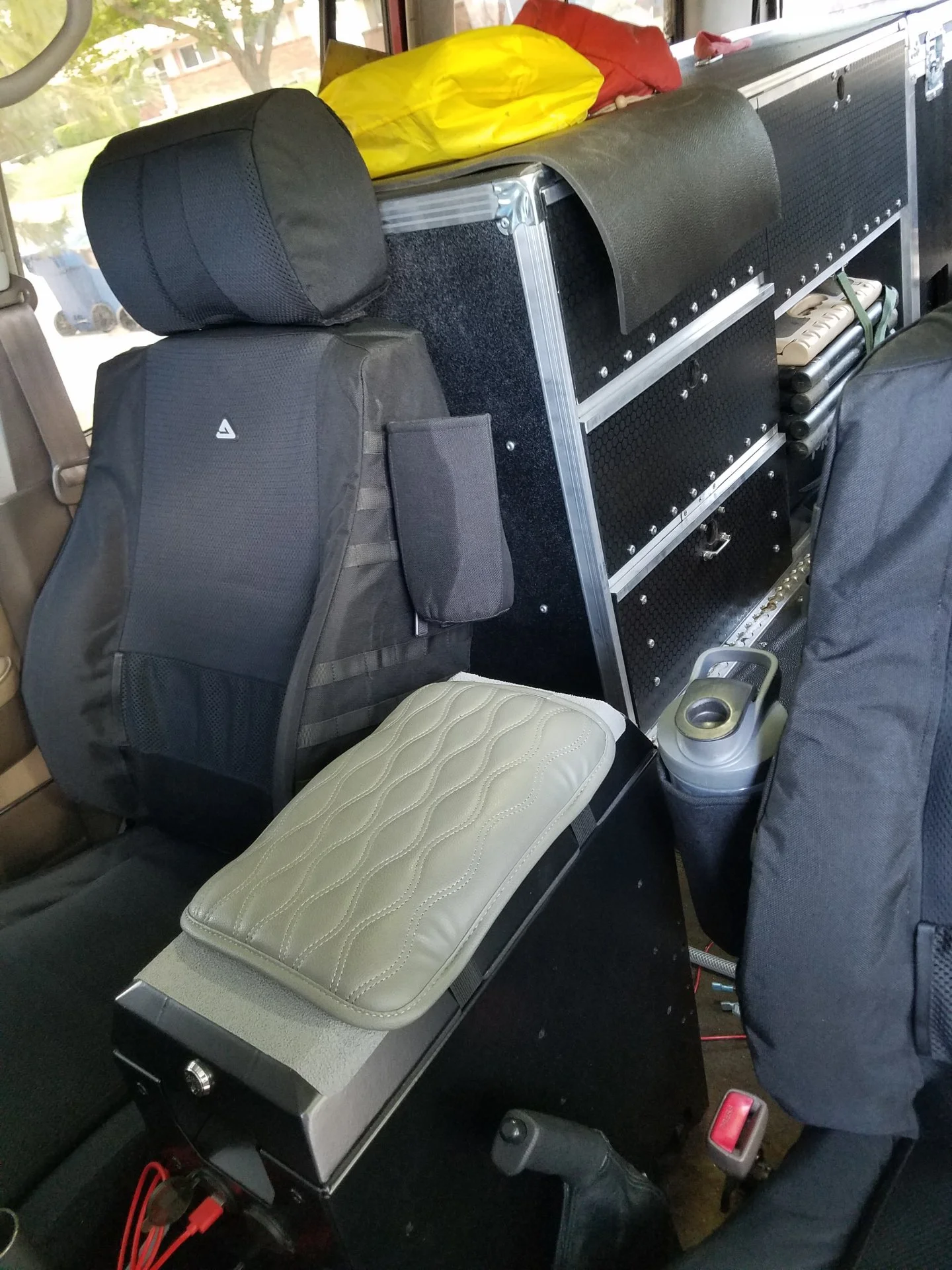

Have thought about seat covers for the Scheel-Mann seats,? This is what I bought for mine and they are exceptional quality! they even allow the use of the bottom cushion lift up feature so you can access things under your seat!
They even offer CUP
They even offer CUP HOLDERS!
Haha! I do need to get a cover eventually. The truck will never be finished. Always one more thing that needs doing. I’m sure the first time I spill coffee on the seat I’ll order one. Lol.
